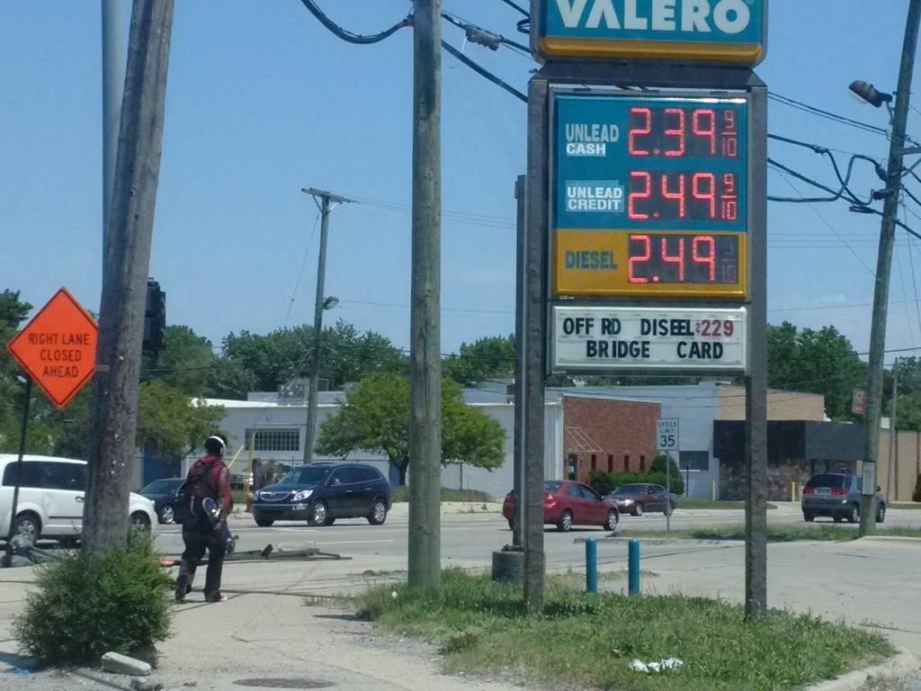

I only buy gas from places that accept EBT /bridge (welfare card). It's not that I'm on welfare, I'm just cheap.
