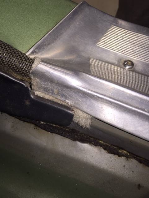

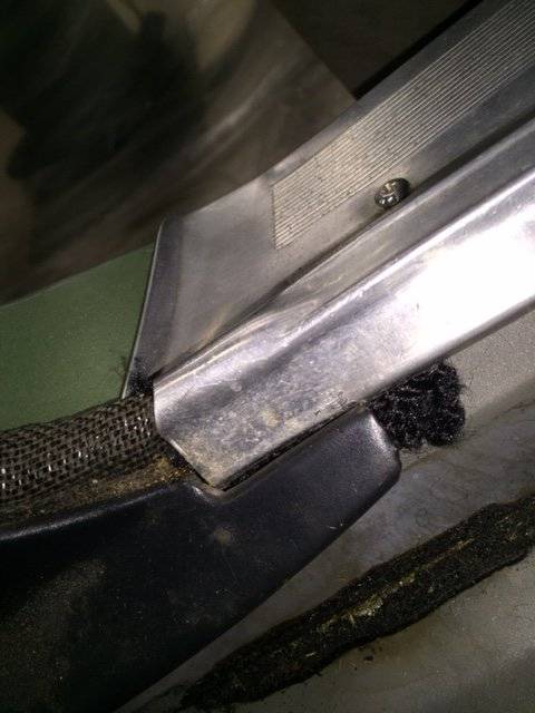

Yes Big John, I saw that too! I'll ask for maybe an additional 5 inches to each side and front parts. I am going to ask for the sample for sure because the carpet is supposed to wrap/hook around the edge and the front door sills secure the carpet over that. I'll wrap the sample around that lip and test that the sill will not stick up when screwing it back in place. I will post my result and maybe some pics to help others with that type of backing style. Thanks big John! You're the man!

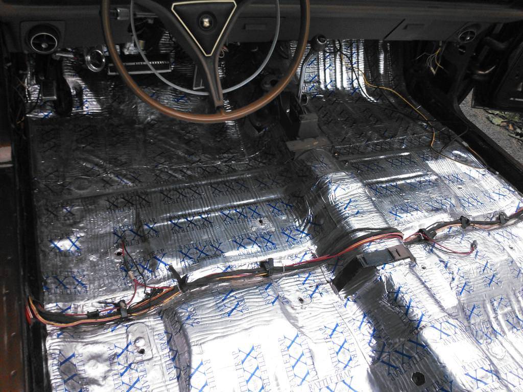

Hey Big_John,
That carpet looks pretty cool...how did you use the solder gun to burn holes for seat bolts? Did you lay out the carpet, fit it as you wanted, then glue in places before burning holes?
Also did you come up from underneath?
That is sorta my plan...get the carpet in my '69 300 fitted the way i would want, glue it a bit then holes. I was gonna try the burn with soldering gun on the old carpet to get the hang of it...I guess I will just apply the hot gun to the carpet in a circular fashion?

On my Barracuda I did this without knowing it was the way it is done.
From the bottom, on my iron only the tip fit through the bolt hole. Once done from the bottom I went through the top with the barrel of the iron opening up the carpet. I had a junk iron so I wasn't worried about it.
The other thing I did with the carpet was put it in the car a week or two before trimming it. It was literally the first thing I put in the interior, by the time I was ready to trim it the carpet was nice and flat, pushed into all the contours etc.

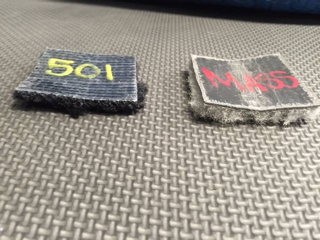

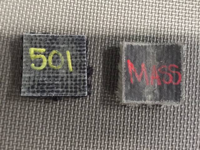

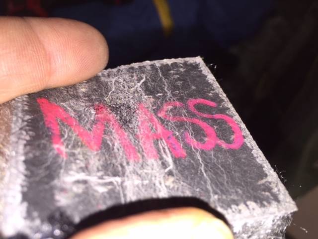

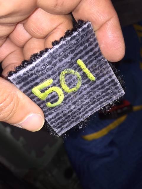

Ok all...I got my samples from Stock Interiors. The pics below are the comparison between standard carpet backing and "Mass" backing. The Mass backing sounded good to me because the girl over the phone said is was better road sound deadening (which I really don't mind), but more importantly, insulates the floor from heat. I though that was nice, because i don't have AC and the floor does get hot, which does radiate through the cabin. I was concerned though, because I knew that the thicker backing may be difficult to wrap around the sill lip and wind lace. In the pictures, you will see my test. The black looped standard carpet was just like the original screwed in nicely, buy the Mass backing was a lot more difficult and I'm not sure how a full carpet install will work around the sill and B piller trim. I was able to screw the sill plate down, but it was tight. I was disappointed though, because the pile of the Mass backing sample, was not the loop 80/20 style like the other sample, so i don't know how the 80/20 with mass backing will be. I also have a closeup of the two to show that the 501 backing was semi-porous (little holes) and the Mass backing is very solid. Any of you guys have an opinion about moisture retention with Mass backing made that way? Big John, any thoughts since you were in the business? The girl on the phone said no but, I'd like to hear what you guys think. I hope this and the pics help you guys that are inquiring for a carpet as well!
Ok all...I got my samples from Stock Interiors. The pics below are the comparison between standard carpet backing and "Mass" backing. The Mass backing sounded good to me because the girl over the phone said is was better road sound deadening (which I really don't mind), but more importantly, insulates the floor from heat. I though that was nice, because i don't have AC and the floor does get hot, which does radiate through the cabin. I was concerned though, because I knew that the thicker backing may be difficult to wrap around the sill lip and wind lace. In the pictures, you will see my test. The black looped standard carpet was just like the original screwed in nicely, buy the Mass backing was a lot more difficult and I'm not sure how a full carpet install will work around the sill and B piller trim. I was able to screw the sill plate down, but it was tight. I was disappointed though, because the pile of the Mass backing sample, was not the loop 80/20 style like the other sample, so i don't know how the 80/20 with mass backing will be. I also have a closeup of the two to show that the 501 backing was semi-porous (little holes) and the Mass backing is very solid. Any of you guys have an opinion about moisture retention with Mass backing made that way? Big John, any thoughts since you were in the business? The girl on the phone said no but, I'd like to hear what you guys think. I hope this and the pics help you guys that are inquiring for a carpet as well!View attachment 188319 View attachment 188320 View attachment 188321 View attachment 188322 View attachment 188323 View attachment 188324
I'll bet that the "mass backing" is only in the same spots as the factory jute backing. I may be wrong on that... but it would surprise me if the backing covered the entire carpet.
IMHO, If I wanted to do some heat or sound insulation, I wouldn't do the "mass" backing. Instead I would use some material on the floor instead.
My car ('70 300 vert) was done with Rattle Trap sound deadener. My main concern was sound deadening and the way to do that is to dampen the vibration of the sheet metal floor. This worked great for me. Obviously, there is some heat insulation too, but it did make the car much quieter.
This is pretty much the same stuff as they use on roofs, so I feel that it has sealed the floor from moisture getting under the insulation.
RattleTrap 25 SqFt FatMat Sound Deadener Super Stick Super Thick Formula | eBay
If I was more concerned with heat, I would use this stuff. EZ Cool Automotive Insulation heat barrier and noise reduction for cars, trucks, classic cars, street rods and much more
This is a much lighter material and doesn't absorb or hold water. It will help with sound, but its forte is heat insulation. I used this under the headliner in my Barracuda. Glue it in place with contact cement.

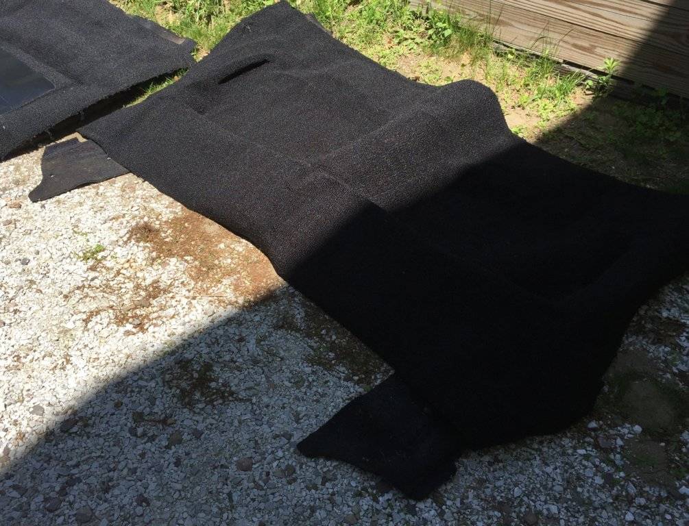

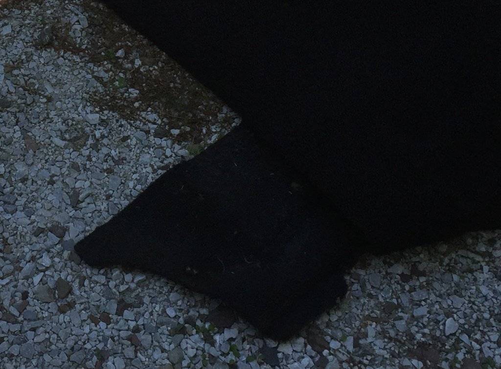

Ok all, so I got my carpet, very nice ... but yes, the rear seat flanks are missing as a few of you guys said. Called them & sent these pictures of the new laying on top of the old original. She said she was going to get in touch with the supplier (ACC) about it. I was ready to order some extra to cover it, but I guess I'll wait to see what she is trying to do. FYI: When I ordered I asked for 12 additional inches to the rear carpet, but she said they are cut all the same, but she put in a request to have the carpet not cut on the ends, which I preferred, but it didn't make up for these missing flanks.
Ok all, here is the update. First, Stock Interiors is the place to go! The customer service has been incredible! I worked with Tabitha this whole time...They sent the second carpet and it was the same cut for the rear section accept the rear section was cut for the seat latches, and again, short on the flanks and the cut for the seat hooks was too shallow. I called to tell her to just send me an uncut rear and that I would pay for the extra cuts of carpet to cover the rear sides. She asked me to sent pics of the car floor and the car itself (67 Polara 4d Sedan), which I did and she sent them to ACC and called them to see what was up. She said they have Trim Parts old molds and templates, so ACC is working with her to get it right for all cars. Tabitha had me send back the bad rear, but also had me send back the original carpet, so ACC can do it right. Tabitha was very polite in asking me if I could do that which was awesome. I told her I would love to contribute to them correcting the issue.
So they have my original carpet to use...lets see how it goes friends...I will update when the carpet comes back!
