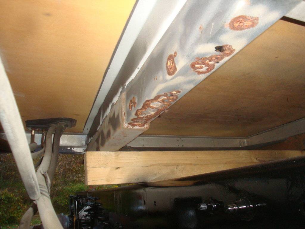

This is after some sandblasting, then re-rusting from the damp air after a couple weeks. The spots I should have seen. The rear 3 feet had already been patched, which I didn't notice either.

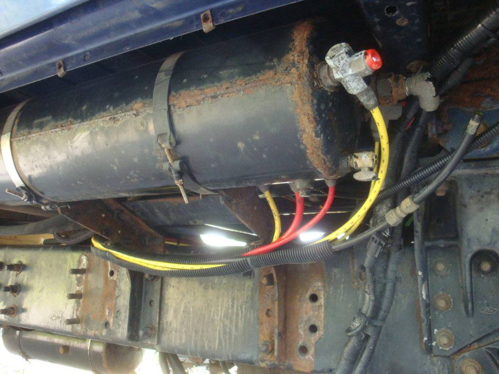

The air tank that hid the real bad stuff.

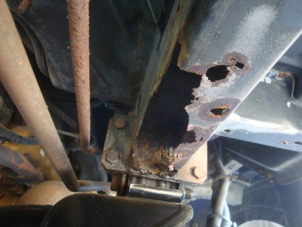

The bad stuff after poking and banging.
More bad stuff.

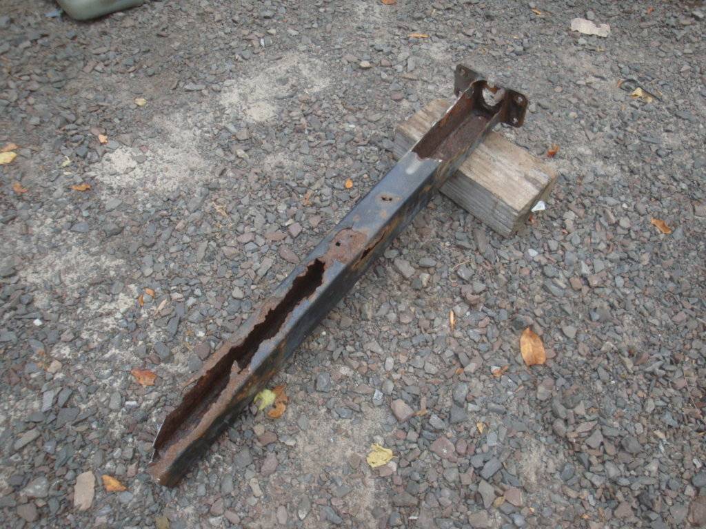

The offending metal removed.

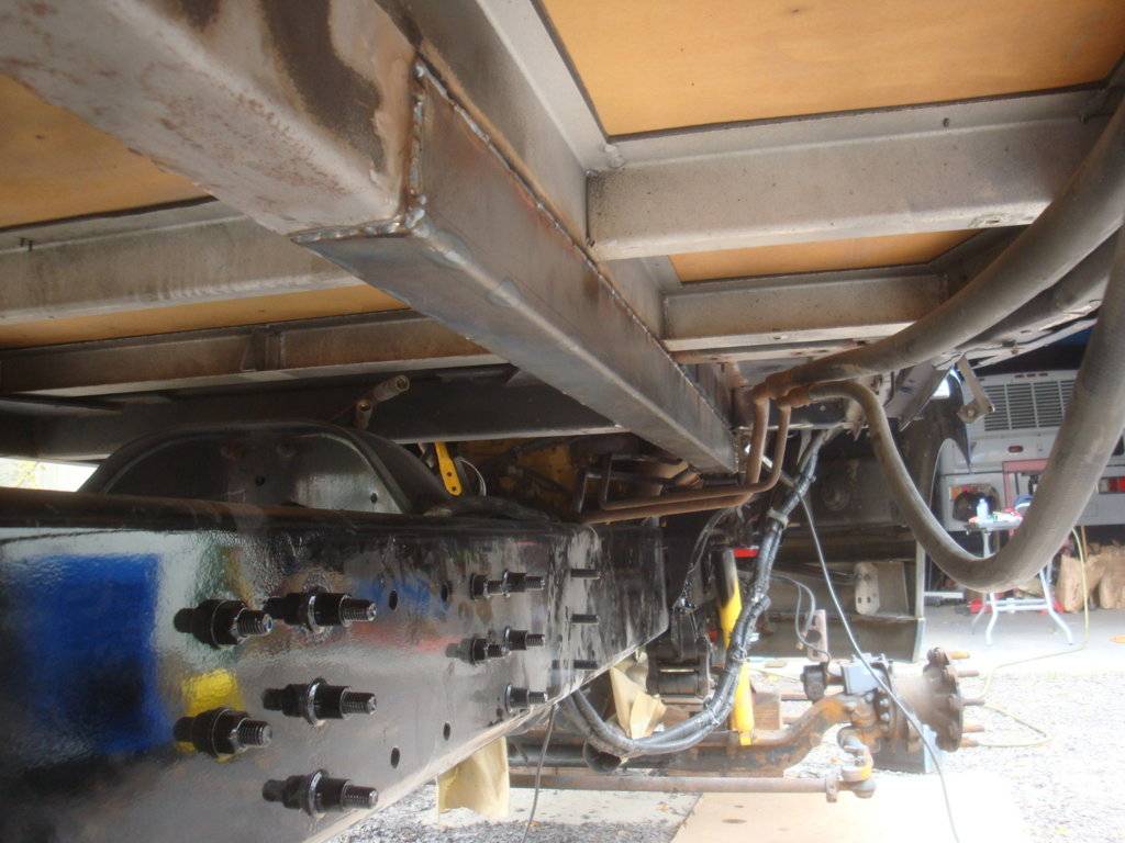

The new part fabricated. Of course it's an odd size, so you have to make up a C channel out of two L channels. More work and more weight.

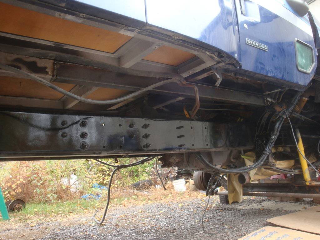

New metal installed.
