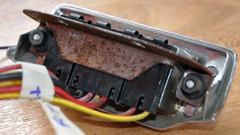

Special wire terminals

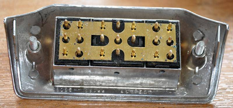

If I couldn't find any, I would get some brass tubing with an ID the size of the pin at the hobby shop and cut it to length. Then I would make a saw cut length wise. One of those Exato razor saws would do that nicely. Squeeze it together to make it fit to the pin tight. Then I would soldier a "pig tail" wire to it.

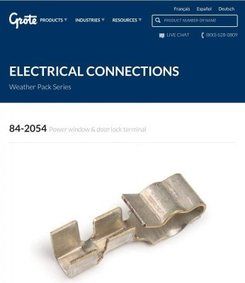

http://www.grote.com/products/84-2054-weather-pack-series-power-window-door-lock-terminal/
Believe me Stan, I searched for DAYS and haven't even find anything close :(
I saw the GM Power Window terminals before and unfortunately, they are too wide, the chrysler terminals just have the center part without the spring arc, and they are a tight fit in the plastic connector.

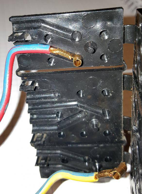

would you be able to cut the wire at the end of the terminal,drill out the wire from inside of it and spread the terminal apart from the inside? you can solder it back together.
That's what I did. I pried them open and removed the old wires. Now I'm soldering the new cables in.That's not the best way, but the only one I have.
