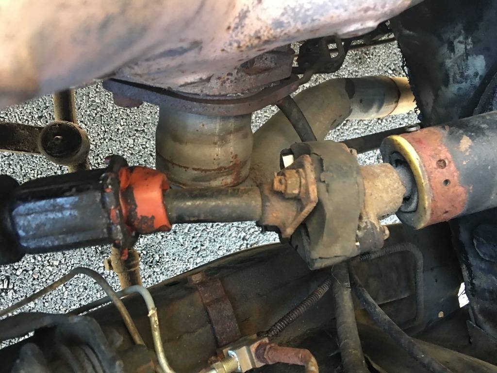

Hey Frank, can we see a larger pic of the steering box, coupler and where the steering column comes through the firewall? That way in one picture we can get an idea of whats up, cheers,

The car is not here right now, but those pics, or close to that, were posted in this thread.
Obviously I am a blind idiot, could you please point out where the steering box in plain sight is in this pic and where the firewall opening shows in the pic too. This is your picture below.

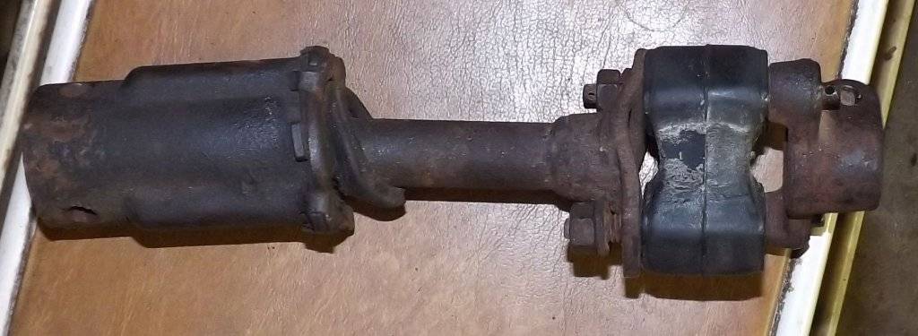

Does anyone happen to know what the purpose of the "pig-tail spring" that goes through the center of the rag joint and attaches to both sides of the rag joints hex studs is for? To me it doesn't appear to do anything....
This is a better view of the firewell end, and some of the steering head.
Looks to me that Something is really amiss there for that angle to be so abrupt. It looks like you just replaced your exhaust pipe. In both your previous photo and this one the pipe angle seems to be the deciding factor of why the angle of the couplers shaft is skewed the way it is. I wouldn't think the factory would have designed it that way, but ???? Can you get ahold of a pic of someone else's Fury to compare?
It is used for the grounding of the horn wiring , because the rag joint is rubber
Frank, could please post a picture of this spring? Mine is missing and I'm trying to find an OEM looking replacement.
Maybe I can build one myself from spring wire using your picture.
Or does anyone know where to get one of these? Part number is 2768287 (not that I could find anything with that...).
I have seen that picture, but what does the other end look like? Is it simply mirrored and twisted by 90 degrees to match one of the bolts of the upper steering shaft?
Yes it is twisted and connects at 90 degrees. Mine was broken also so I just replaced that piece with a hard wire so the connection would be made.
