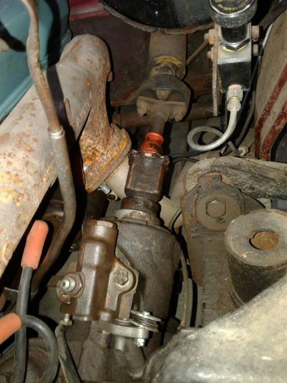

I had the same problem, so I had the thickness ground to the same size as the old one, then counterbored the holes so the bolt head would fit. Dropped right in! Of course, I work in a machine shop, so it was no extra $$ for me.
Hey dcjoe22, maybe you could provide your services. Get a hand-full of those Landrover rag joints and work them up and re-sell. I'm sure no one would have a problem with you making a little bit for your time - just a thought since you had access to a shop....
