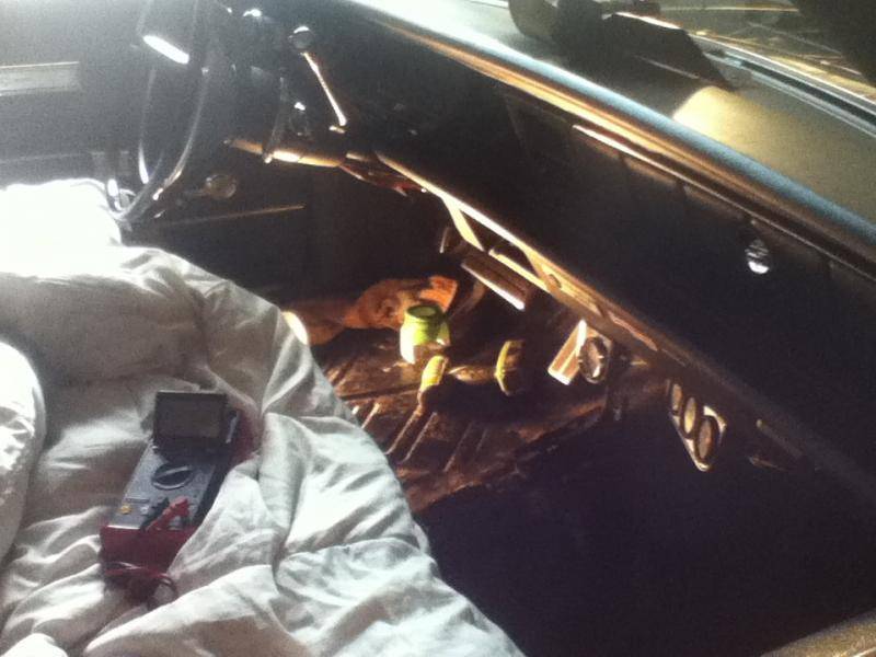

Working on it right now.
If I had an extra plasma screen I'd setup a video link out there so certain individuals could watch and yell at me about my radiator hose.:fit:
It would be funny if all of us had camera's rolling when working on cars. LOL!!!

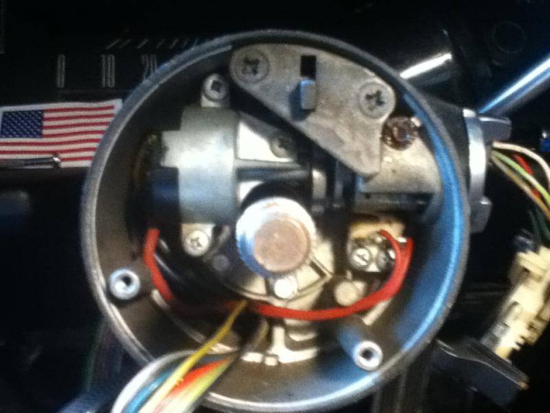

....ok, happy? that's it for now....the plastic jar is for the numerous tiny screws so they don't get lost and the same ones can go back in the same way, lol
so 6 odd hours later I think I've found the culprit....
I wasn't even really trouble shooting this part either. When I turned the key to start the car I noticed the tiny lamps in oil press/voltmeter gauges did not come on first (same condition that occurred yesterday). These ALWAYS light up first before the key hits the very last position and engages the starter motor. I tried it again and the same thing happened. So on a hunch I flipped the right turn signal lever up....and turned the key once more. BINGO, nothing happened, the turn signal was dead, along with the gauge lamps. Ditto wipers. On the forth and final try they worked properly (gauge lamps, wipers, turn signals came on right before the car started). SO I think there is a dead spot or malfunction in the ignition barrel, or something to that effect. I just installed a new son of a ***** this past spring, so now I've got to take the GD steering column apart to get at this mechanism...again. Problem is there's a tiny "c" clip on the steering shaft that is beat up pretty well from me removing it and putting it back on. I fear it
might break this time around and I bet those can't be had anywhere of course.
So it is time for a big cold glass of chocolate milk and worry about this tomorrow.
