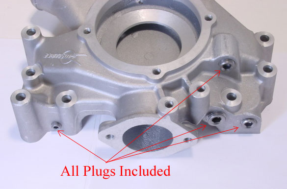

so I swapped a 1976 440 into my 67 New Yorker. The 76 has a 1 prong temp sensor and my car is wired for a 2 prong. I ordered what was supposed to be a correct 2 prong and it is way too big to fit. Is there any way to just wire up the 1 prong into my existing wiring?

They go in different holes in the water pump. Look for a plug on top.
This is a pic I grabbed for 440source. It has the arrows there already. The small hole on the left is for the smaller sender. The lower right hole is the heater hose connection. The hole above it is for the larger sender and the one above that is the other heater hose.
See the piece in the yellow circle?
That piece is part of the 76 smog system. IIRC, it delays vacuum to the distributor until the car is warm. Obviously, you aren't using it and even have the two ports blocked off. It's nothing you need or want.
Take that out and toss it over your shoulder. Put the new sender in the hole with some Permatex or similar sealer on the threads.
Leave the old sender in place or replace it with a new pipe plug.

Well, took that out and this new one that was sent to me still doesnt fit. Do you have a part number or anything for the 2 post temp sensor that will fit?
It should fit - it's odd that it doesn't. They are kind of a generic sensor that fit MANY models. Perhaps the later water pump housing is different. Do you know if there's a sensor for hot and cold lights from the original later year the motor is from?
