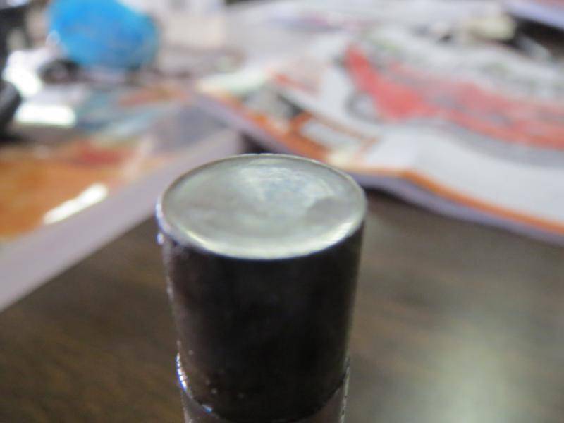

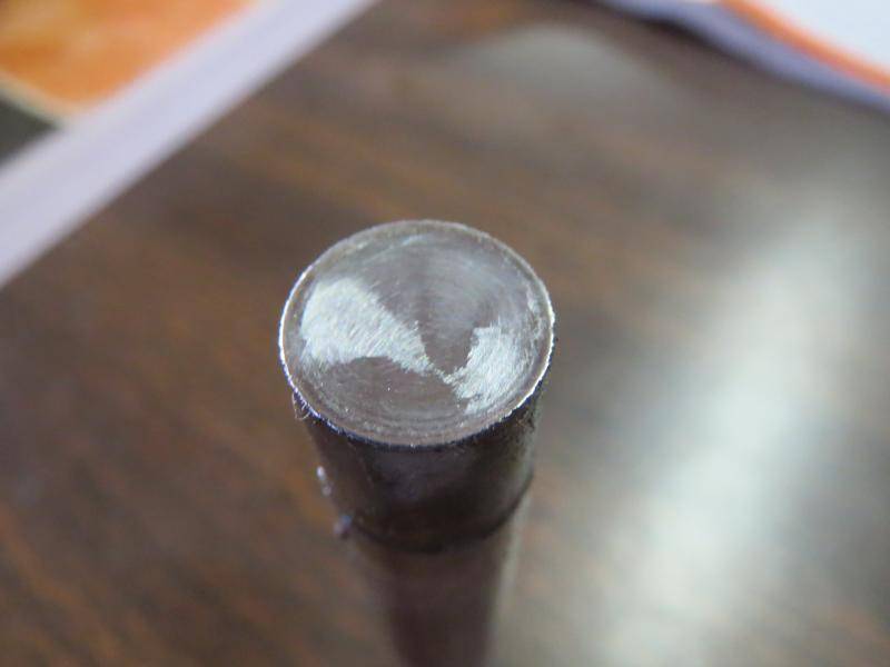

I chased the same issues around last year until my 91 grandfather told me what was my fuel problems. Mine looks the same and only had 53K on it....
In the research that I've been doing through this its been said to try and find a good original rather than new. Thankfully I had an extra here out of another late '60s block that was only 1/32" shorter than spec.

Ran great, not even a hic-up on what turned out to be an hour long drive home tonight.
Why is that?
Because they just don't make things like they used to. Seriously though, the vintage ones are better quality as long as you're using good quality oil such as Brad Penn or the like. It all goes out the window if you're using the oil produced for modern cars.
I saw where someone recommended the fuel pump push rod from Mopar Performance as being pretty good quality. Is that not true ?
If I didn't have an extra vintage one laying around I probably would have gone with one but I like knowing that the steel content in my car has never made any trips accross the pond.
Just the camshaft end and kinda shiny but not mirror like and a definite dish.
