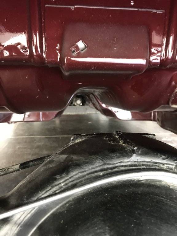

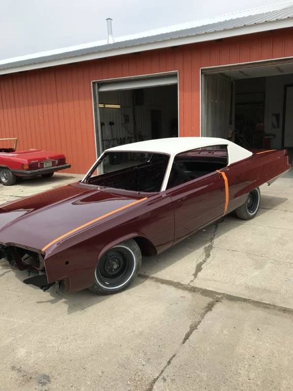

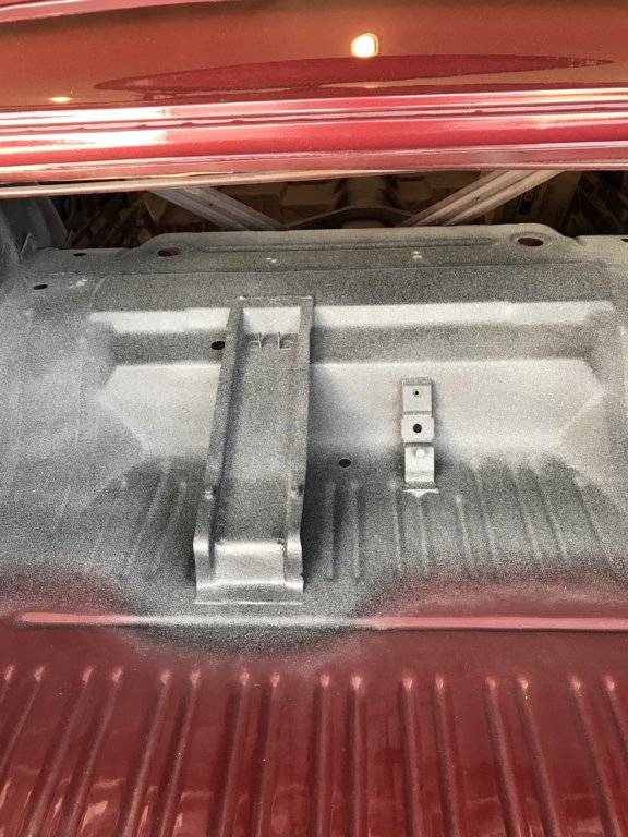

I had to send the body off. Here is what was done at very reputable shop specializing in classic cars and customs.
Trunk pan re build,dent removal rear fenders from loose jack, dent removal r front fender from a Bobcat backing into it, l front fender pushed back, rear window rust cut out and repaired, rear fender behind wheel wells re-built ( no repair panels available), tail light panel rebuilt. Mount on rotisserie ( car was completely dissasembled by me prior to taking for body work). Sand blasted, epoxied, repaired, sanded sanded again sanded again...., sound deadner sprayed, under side and firewall painted, interior painted, lowered on front frame with engine and transmission and rear end install so front fenders could be installed (I had already rebuilt and detailed the rear end, engine, transmission,and frame so not included in hours). Dry fit everything, more priming and sanding, final sanding, clean and mask. Base coat clear coats. Sanding and polishing and vinyl top installed.
$7600 in materials and 604 hours. It was over 10 years staring and stopping as funds and life allowed. I believe there was over 150 hours of blocking and sanding. Once in a lifetime project to this level. But I am happy with the results.
Taking it home

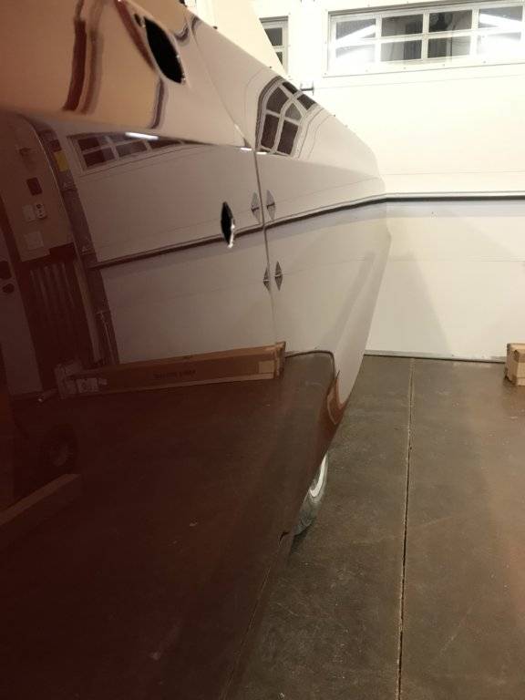

Straight body & mirror finish View attachment 208273
Re-fabrication if trunk floor
Straighter than ANY Chrysler body I've ever seen, from the factory! Looks great!

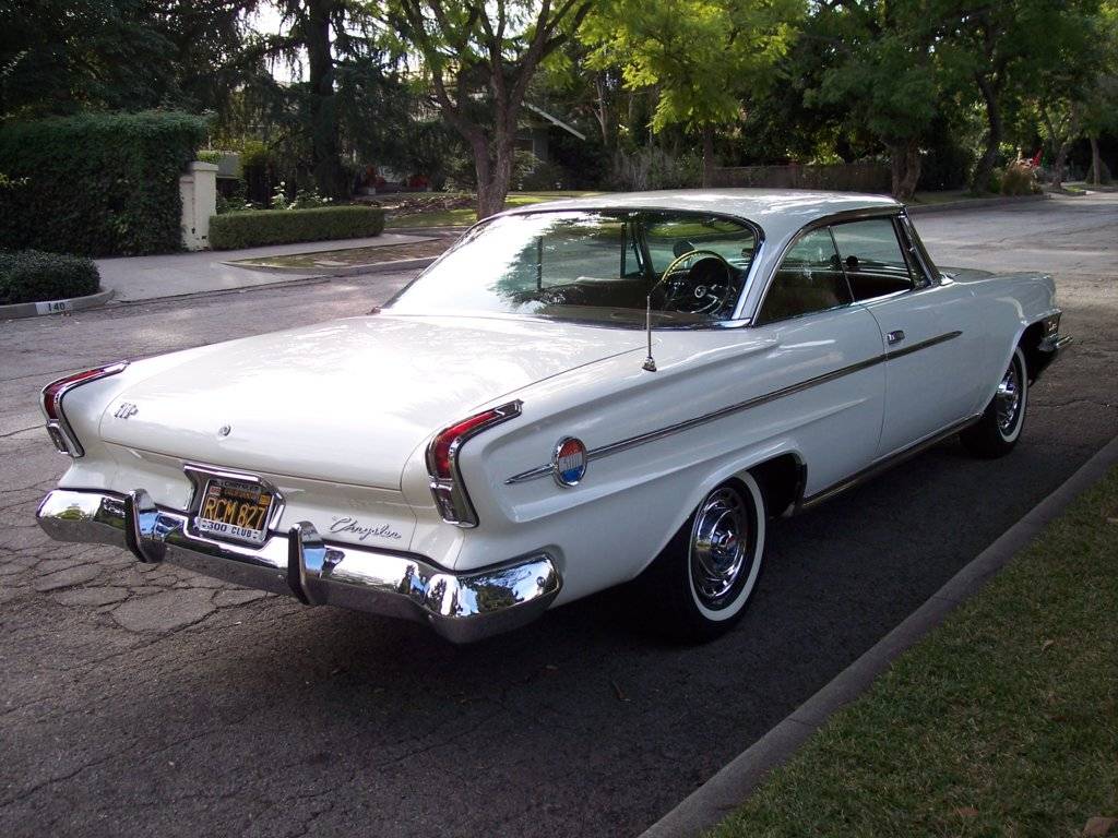

The shop you reference seems to be one like we do have here in Southern California, called Motech. They do really good work as far as I have seen though, but their prices are above $100/hour. And they do specialize in Mopar, so they have some familiarity with how they ought to look already. They don't have a big crew, but one that is pretty competent it seems. I doubt the shop with 20 guys doing all makes of restorations doing the work will know Mopars very well. But Motech does, but would end up costing me way more than my guy, so I prefer going to a single good guy who I can trust to do every step the way I want it and not wonder what is going on when I am not there. I would likely consider Motech if I didn't have the guy that I am using. Guys like I employ are not plentiful, but they are out there if you search and are patient (they have long waiting lines). But if you want a team of probably competent guys working on your car, all I can say is good luck for a guy like me. I have seen their results many times, and I don't like them. But they may be fine for others. I guess we just have to disagree on this one, or I am way more fussy or whatever. When I was younger, I painted a couple of my cars myself, and did some of the body work too, but not all of it in most cases where rust repair was required. My 300C and 300H are a couple of them (they required no rust repair) but I also had a very experienced paint and body guy there when I did both of them to guide me in all the steps. I have seen a lot and have some clue what I am looking at. So I am confident of what I am saying and sorry if it is intrepreted as "pompous". I would just like others to be aware of the pros/cons of each choice so they will get what they want - i.e. trying to be helpful. Not everyone has to have a show car and that is fine. To each his own.
Panels weren't always perfect on our cars off the line either. Gaps were nowhere near precise and I'm sure panels did have some waves already after being hung on the car. Now look at this picture and tell me what might those two hammers be used for other than tapping (hopefully) panels for better alignment after being bolted onto the unibody. You look at the back end of my 68 Mustang and the alignment of the trunk lid to quarters, especially quarter extensions to quarters, and you go sheeeeet not even close! Yet that is factory and I know of those who would mig fill and then drill new holes to mount the extensions perfectly.

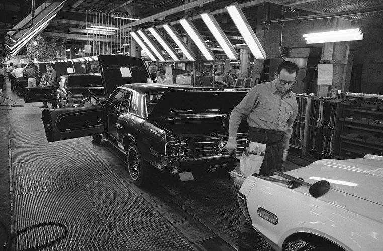

I visited many assembly plants back in the day when working for the corporation, and I was always really impressed with how well the cars did come out given the production variations, tolerances and "stack ups" that could occur. Also, the UAW at the time was too big for its britches (and I also believe the lack of reasonable unions in this country at this time is one big factor as to why wages still stay low despite "healthy" statistics on jobs lately - but there needs to be a healthy balance between them and the corporations too), so the assembly line folks were not always doing their best either and some would be clearly drunk on the assembly line or maybe on something else or whatever. And the guys using the hammers on the lines knew exactly what to do when making adjustments, after considerable practice. It was a revelation to watch them.
