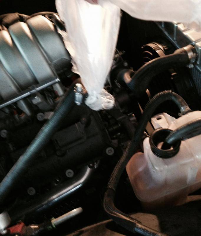

Here's the MacGyver part: On the way to put the Polara away, a T-fitting that was used for coolant circulation broke right thefuck in half and I pumped coolant all over the highway. Fortunately, I noticed right away & pulled over. Well, I went to the nearest parts store & they had no T so I ended up with an L and one hose to plug. How do you plug a hose on the side of the highway? How about a nut wrapped in plastic plus a hose clamp. Yep, that worked just fine & didn't leak a drop.
Necessity is the mother of invention. Nice work on the fly!
Now thats doing with what you can mickey mouse together to get you to where you wanna be besides on the hook! BTW why is the upper rad hose collapsed?
Yep, upper hose collapsed but I was less than 5 minutes from home and I watched the temp gauge VERY closely. Yesterday I replaced the bullshit plastic fitting with brass & problem solved. Drove her out to my storage without incident.
