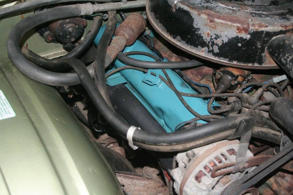

I picked up the Ugly Duckling last night. I had the magnum manifolds installed, new dual exhaust (2-1/2 to the muffles and 2-1/4 tail pipes), plus a new sticker on the windshield to make her legal. Here's a couple of pics of the manifolds in place.

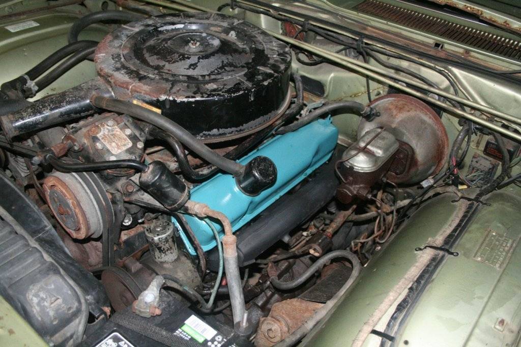

Over the next couple of days I hope to get the following things done; pull the blower motor and check for debris (it makes some noise when you turn it on), pull the bulkhead connector (clean apply deox grease) and a few other little things before starting to drive it regularly.
I mentioned in another thread that it still isn't braking like I think it should. When I did some testing on the brake booster it seems as though it isn't working properly. I ordered one yesterday and I hope it arrives in time to put it on this weekend. If that gets me brakes more like I expect than it will be time to start driving it regularly.

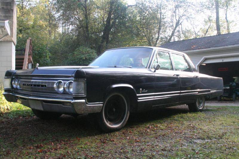

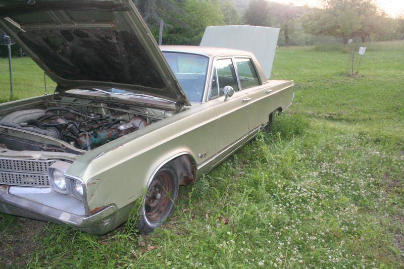

In early June I took a two hour drive with an older gentleman (Jim age 75) that I know to look at a couple of cars; ’67 Imperial 4 door sedan and a ’68 New Yorker 4 door sedan. Jim has restored many cars personally he owns a 34 Plymouth, a 47 Plymouth, and a 69 Roadrunner. When I was in my 20’s Jim was always willing to lend a hand with the 68 New Yorker that I had previously. he used to manage the parts room at one of the local Dodge garages for years. Anyway he came along because he likes to look at these old cars and is extremely knowledgeable. We had a great ride and a good time checking out the cars.
It was presented to me by the seller’s daughter that it was a package deal. By the time I spent about 2 hours looking them over and getting the engines to roll over we had come to an agreement for me to purchase both cars. The only disappointment of the evening was that the Imperial is so much nicer than the NYer, my personal preference. The Imperial is listed for sale if interested,For C Bodies Only Classic Mopar Forum.

She got the name the ugly duckling not because of her looks, but because of the weather the day we went to get the cars. It rained from the time we left, the whole time we loaded the cars, the drive home and much of the time while we unloaded them.
The Imperial was a breeze to load. Due to a broken relay to starter wire we winched it up on the trailer. The NYer we drove it up on one fuel bowl of gas at a time. For some reason the pump wasn’t drawing fuel that day, it works fine now. Due to all of the rain the ramps and trailer decks were soaked. At one point I spun the rear wheels and slide the car off the ramps and the left ramp came off and was under the rear wheel of the car. In an attempt to reposition the car to get the ramp out the exhaust was pulled loose.

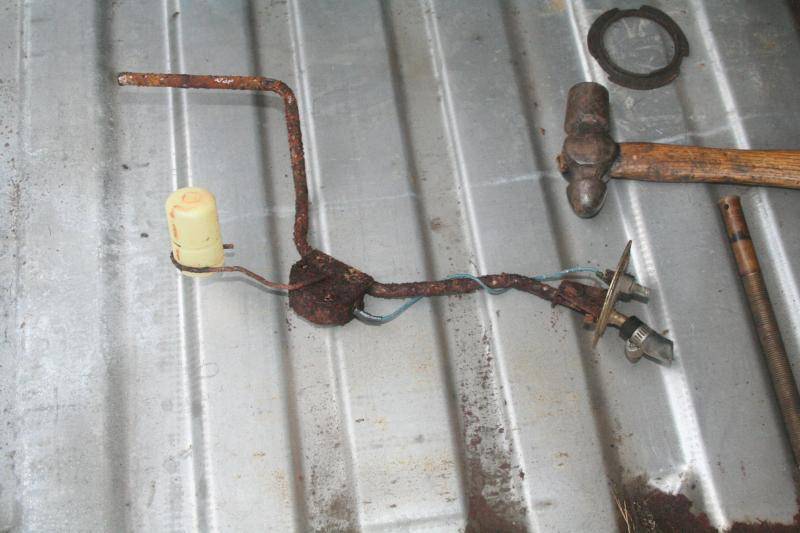

Once the brakes are done I’ll put the new fuel tank, sending unit, and fuel lines in. I’m working with the car on jack stands so having the tank out of the back of it right now gives a bit more room to move around when working on the brakes. Oh my, when I dropped the tank I thought that I was getting lucky because there was no “fuel” in the tank. When I lowered the front of the tank though it sounded like gravel sliding inside the tank, yikes. I sucked ½ gallon of rust and crude out of the tank with the shop vac. When I took the bucket of rust and the tank to the local radiator shop he advised that I could probably buy a new tank for less than he would charge to clean it. Thanks to all the guys here that gave input to help me in making the decision as to what to do about the tank. Below is a picture of what the sending unit looked like. It's a good indication of what the inside of the tank looked like.

The latest on the struggles with the brake booster. This might seem almost like a stretch, but it's totally true. So as I was trying to figure out what to do I remembered when I sold me first NYer like 16 years ago. The guy that hauled it to the buyer asked if he could have the booster. The guy was like sure come back in a few weeks and I'll have it off. (Car was badly wrecked.) So, I called him and he still had the booster he never got around to installing it on his RR. I went out last night and picked it, took it to work today to clean it up some and installed it tonight. It works better than the other one did. I just need to get used to driving a car with all drum brakes. Thanks for all of the input guys.

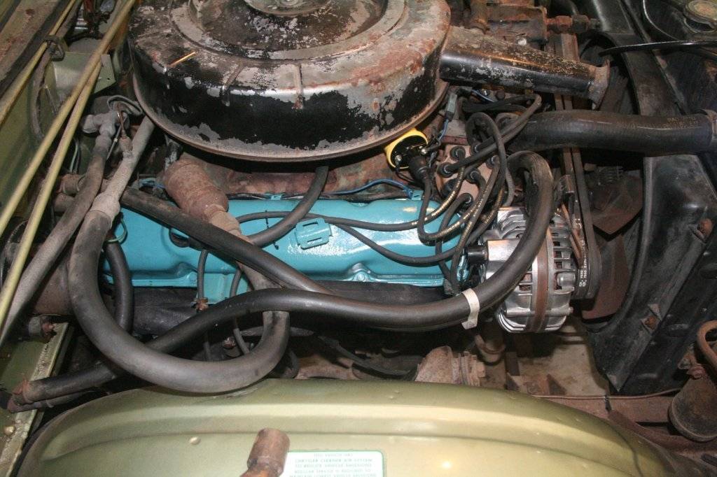

Well, I picked up an accel super stock coil for half price and some Taylor Street Thunder plug wires. She sure starts quicker now. The only problem with the plug wires is that they all seem to be about 6" longer than they are supposed to be. So, it looks like the distributor is blooming due to the plug wires sticking up.
I also go the alternator rebuilt because the bearings were sounding like they didn't have much life left in them. They are very old school. The do alternators, starters, distributors, and some other stuff but I'm not sure exactly what else.
Well, I spent sometime in the last couple of days wrenching on the old girl.
I replaced the heater hoses. Installed the new Spectra B332 )CU332) radiator and the upper hose. The lower one is about 1-1/2 inches too short. I don't know if it's a fluke or what, but I hadn't used Continental hoses till this time. I need to pick up a different lower tomorrow.

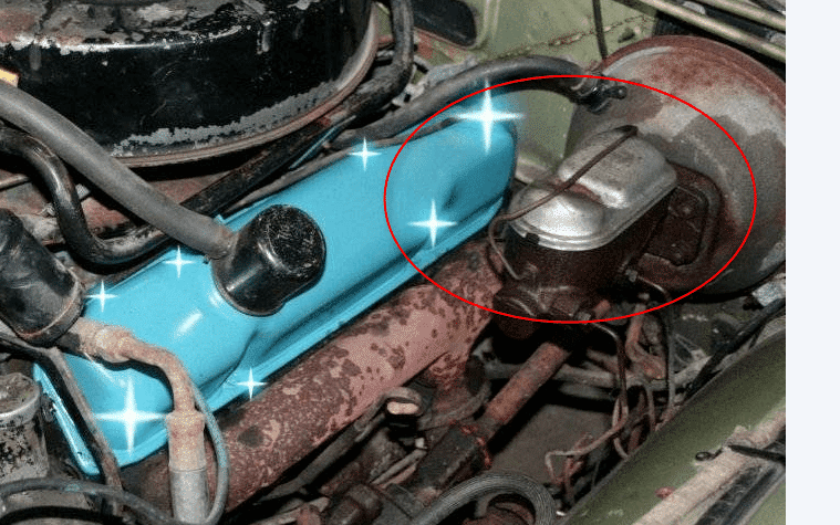

I am just joining this thread/topic, is your car running disc brakes?
If not then this will be your problem...
Based on your previous pics posted here, you have drums all around.
It has drums all around. Are you saying that this is a disc brake master cylinder?
yes from the pictures it certainly looks like it is for disc setup the MC should have 2 equal sized reservoirs
pop the top and if one is definitely smaller than the other then it is the incorrect MC for your car.
