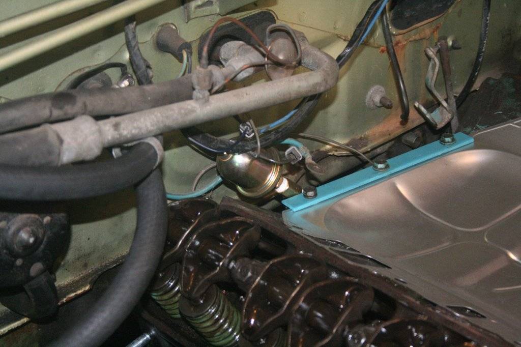

It's been sometime since I've updated this thread. Last fall my AC clutch failed which rather suddenly made me realize that the compressor wasn't any good. She eat the belts off lickety split. Fortunately I was only about 5 miles from home and I managed to make it back. This was bad timing because I had hope to take my 85 yr old father for a ride the next day before he headed back to TX, ugh.
Anyway this caused me to put her in the garage. One thing lead to another and I ended up pulling the top end of the motor apart so that I could remove two busted exhaust manifold studs. Once I had the heads removed I took them into work where one of the welders welded a nut to the studs and backed them out for me. I took this opportunity to blast and paint the intake manifold (sorry I don't have any pictures handy right now). I also used this chance to install the oil pressure and water temp senders for the aftermarket gauges I picked up. For the oil sender I had to put a 4" pipe nipple in to get it up where it would clear everything. Not the way I wanted to do it, but it worked.
The engine looked clean inside so I was pleased with that. I've had it all put back together for some time now, but I hadn't fired up. Today I fired it up and bleed the coolant.
