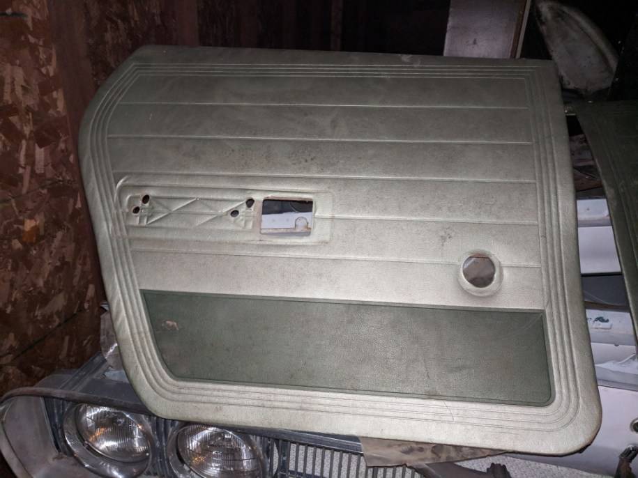

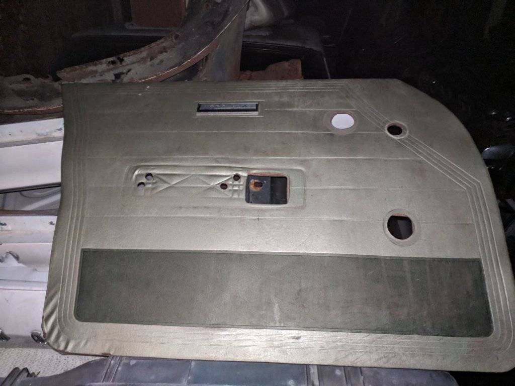

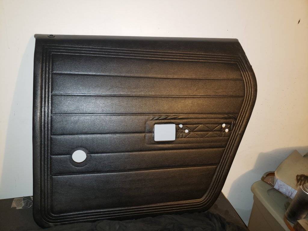

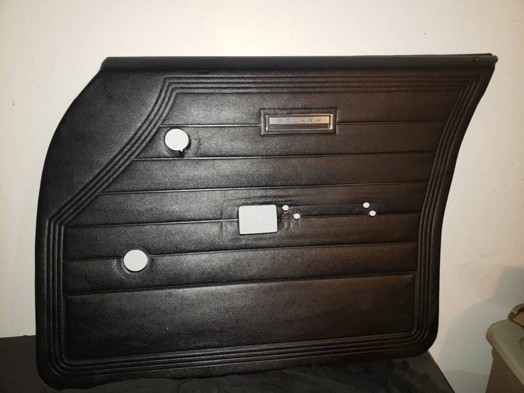

Well I got the door panels dyed black. Both passenger side panels came from the Gold donor wagon, the drivers side came from a 69 Polara sedan going to the derby and @LocuMob went and pulled all 4 and a Dashboard with nice pad.
I used flat black duplicolor vinyl and fabric paint. Overall happy with the outcome.

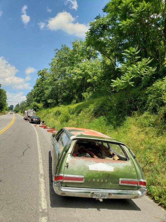

Firetruck lost its hose...the Servprolara arrived on the scene to assist in the clean up. "Faster to ANY disaster"
Looks like you've got a decent load coming back...still running cool with that new radiator hose?
Wyatt, you are a young man after my own heart. F.... It I'm not turning back press on fix as needed. Good luck on your ride back.
I am glad to have met you. See you next time.
Why would I stop? This is how I work the bugs out of my cars, this one just got lucky enough for the 1600 mile coolant flush. I did start having issues again this afternoon when I got up to I80 from Carlisle. I stopped at a walmart, made a mess on the ground. Got some thermocool by evaporust, filled it up with water and were cool again. Now I lost half my cluster lights. I'm stopped for a while in Ohio. I need to rest my eyes.
