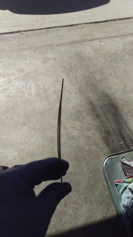

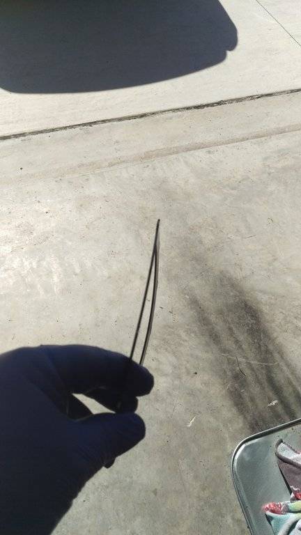

So I have a question, are the '67 torgueflights this touchy on fluid level? OR, I suspect this, since I know the car's been hit a couple times, is it possible the dipstick tub and stick are wrong for the car? Like say it was pulled at some point during the repairs while it was being worked on? If so then that could explain why it's so touchy on fluid level as it could be perpetually low.
