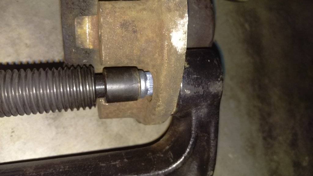

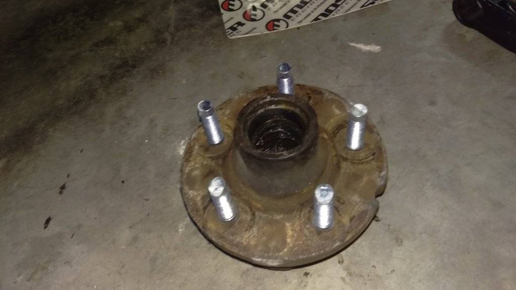

Moser Engineering 1/2x20x1.75" wheel stud fit the 67 disc brake hub. Maybe not perfectly but within +.009". I needed them because I really never felt the lug nuts had enough threads in them with the AR wheels and a 1/4" spacer. Space was needed to clear the caliper. Honestly I could get away with 1/8" but 1/4" was what I could find when I bought the wheels.

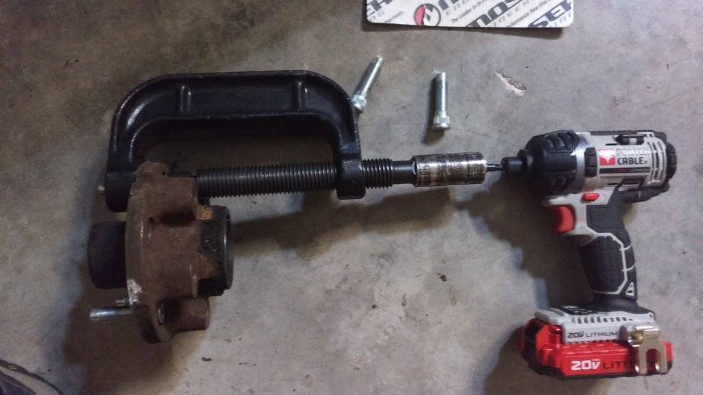

Not having a press I had to put on my thinking cap. Normally same sized splines I'd be able to line up and pull back in to the hub or axle flange with the wheel and lug nut. However these are slightly over sized, ever so slight. Actually on paper the should should be exactly the same with just courser splines. Anywho. I solved the problem of having to press fit with e ball joint press. Pretty easy to do. I'll tackle the passenger side tomorrow.

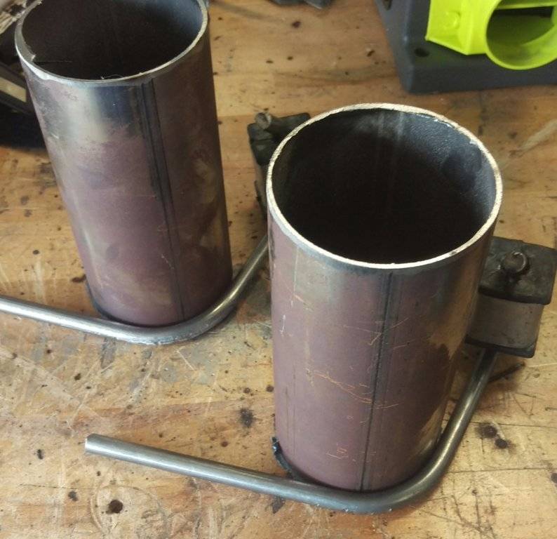

I've pretty much settled on exiting the exhaust thusly. It's the only thing that looked good to my eye. The wood is 1/2" spacers taped tot he frame-rail so I can get some clearance and not hear any rattles when I'm done. The straps are holding the pipe up in place while I mock everything up. The pipes are cut on the same angle of the torque boxes above them.

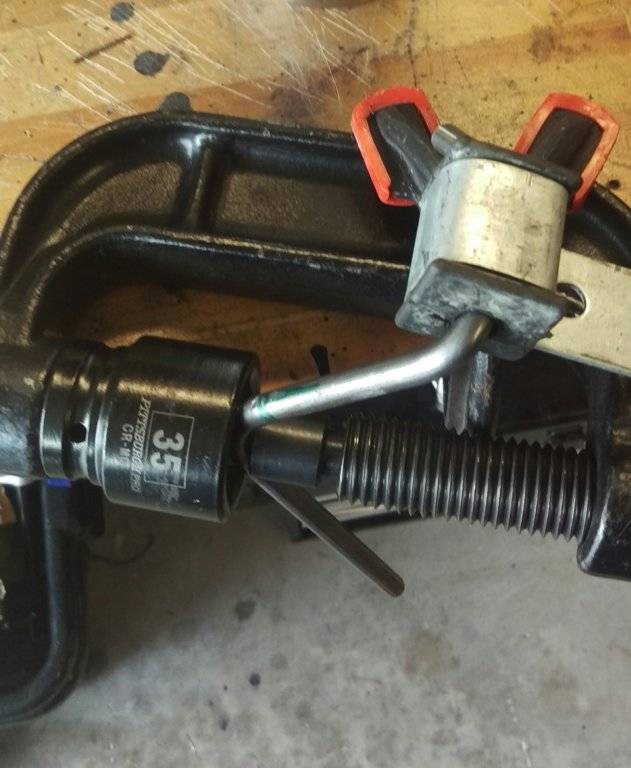

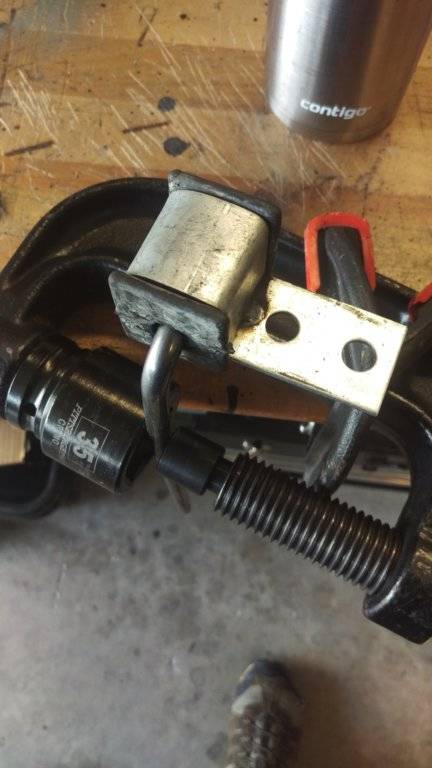

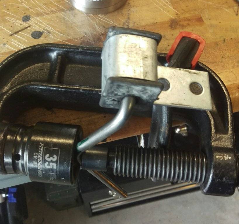

Have a steel hanger that you don't want to be so ugly looking? I hate when I see them straight and simply welded to the pipe. Nope I wanted a nice hook/curve to match the pipe. Don't have a hydraulic press nor a vice. Don't have room for a press, and for some reason a vice is something I'm very picky about. I'm also very cheap so hence why I don't have a vice.

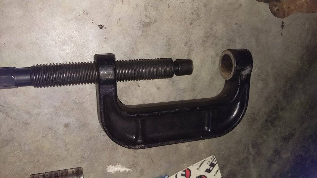

I do however have a ball joint press. You've seen it previously do work pressing in studs into spindles.. It's becoming my go to.

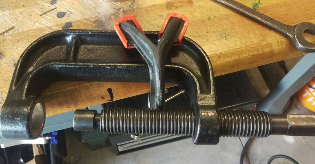

Little help from the Bessey 45 degree c clamp to hold it in place, a large socket to provide some space for a bend and away we go. Lock it in, put some pressure on it, move the hanger to get a new bite on it to tighten the bend. Rinse and repeat.
Second bite.
Third bite.
Finished bend. These will be trimmed, then welded to the pipes strapped up earlier in the post and bolted to the frame.

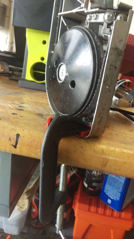

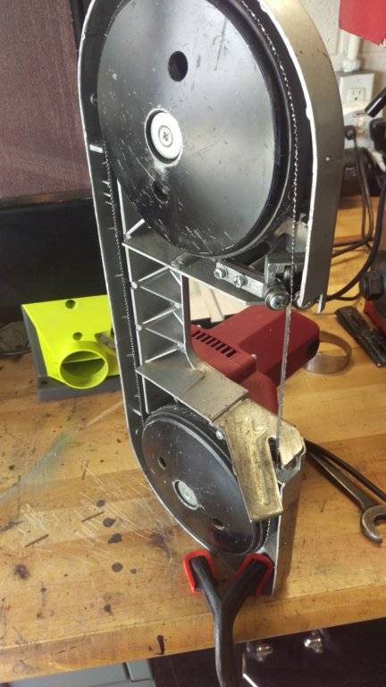

As an aside, have a cheap portable bandsaw? Don't wanna pay more for a stand than you did for said saw but need a stand? Take the cover off and simply clamp it to your work surface. Save yourself some dough. Yes I like the Bessey 45 degree split clamps.

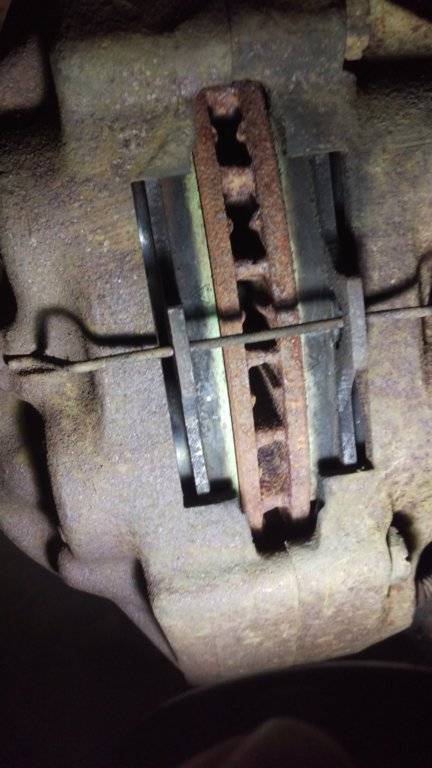

Pic of the pads once they cooled down. I guess the green line is where they got hot. when I took them out of the caliper they looked basically brand new.
