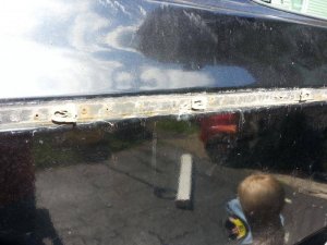

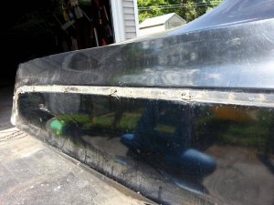

So after some hiatus we're going to get back after it. So I thought I'd start going after the passenger rear quarter. Since the drivers side is shaved of trim it's time to give the same treatment to the other side. The old adage be careful what you wish for applies here.

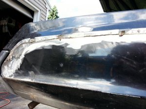

Uh oh.. Something is a miss here.
Drat.
I hope I can figure out how to fix this one. This is gunna be a year, I can feel it.. No way I'm leaving that kind of patch and that much dope in the body. For those into prayer, I might be in the market as it were.
Seems the lower part underneath the trim was replaced by riveting it in place there. Not so nice indeed, the least thing to do would be to separate it and re-weld it in place with some welding primer underneath. Maybe using a joggling tool to make it more even in the welding area to use less lead, bondo or whatever. Replacing the complete quarterpanel could be spared by this maybe.
