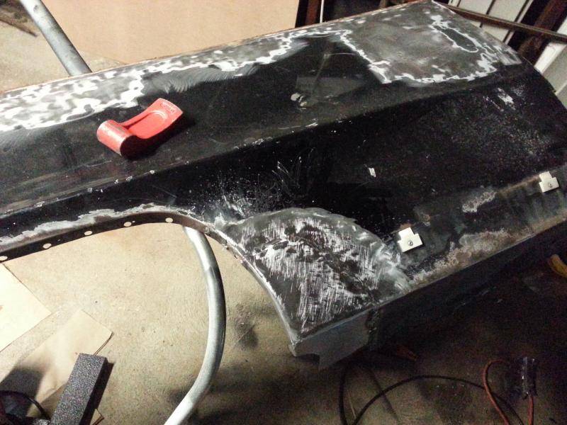

No, the front fender. The quarter has a bend but I should be able to get that taken care of.

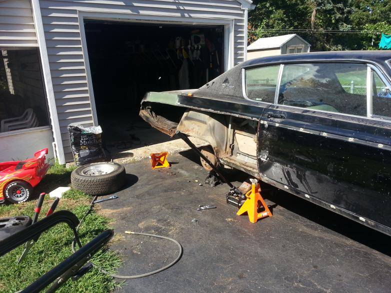

Welp I got into it and decided yep the quarter had to come off. So here's where we're at. The wife and kid are away for the next few days so maybe there'll be some progress. Though i do have to make some patches first. I just want everyone to know, where there's rust on this car, there was tar. Seems counter to what i mostly thought about tar as a preservative. Areas that had old seam sealer that was kind of porous in the same areas as the tar had no rust as the porosity seemed to all the area to dry.
Oh well it is what it is at this point. Yes i know that's not where the cut should be made as I'm going to have a devil of a time getting it straight bit that's where the original repair was made and it's what I got to work with. If I had another quarter, well things would be different.

Welp with all the rust behind the bondo (inside and on the outside) and the effin' job that was done before me, it couldn't get much worse. IF I had started on this side, I'd have said fudge it and let it rot. But this and the fender is all that's really left. So wtf might as well go for it.

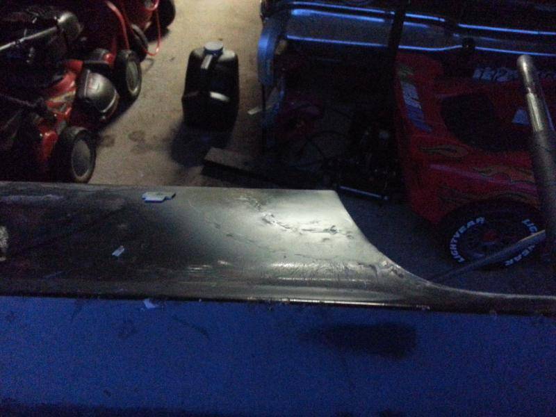

First patch made for the rotted corner. Still have a little work to do in oder to get it where I want it, but it's not bad for a start. Hopefully I can keep this going while the wife is gone and get the quarter back on and at least tacked in place but it'll be a chore to get there. Of course I have't even started to think about the inner structure yet, and there's a few spots of concern.

welp after a week of hell at the office, say to the tune of 17 hours sleep over 4 days I went back outside. Didn't like the look of the original patch so I cut it out and made another. I still have a bit to do on the underside, but I have to figure out whats left on the car, if it's any good or what not. I still have another round of planishing the welds, the areas without scratches are low spots i need to raise. May be one area I need to shrink, and the flange needs to come back out as I folded a little too much. But over all not too bad for my third ever patch. At least i don't think so.

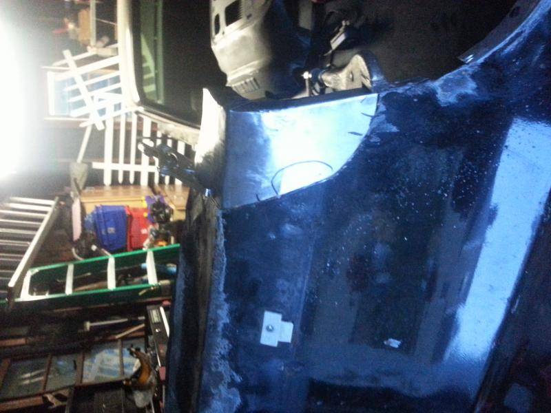

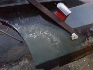

Ok well I had a mere 15 minutes tonight to plannish a bit. What I used was the dolly and the heavy bastard file in the picture. The technique, was to hold the dolly length wise with the weld while slapping across it with the file. This did two things for me, bridged the lows where the weld shrank, and privided a visual guide where i need to remove more weld and re-plannish. the paint removed is merely from the teeth of the file. This was straight downward slapping at the metal no filing motion what so ever. So we're getting close to the depth of the teeth on the file. Second shot is a different angle. Still more grinding to do me thinks.

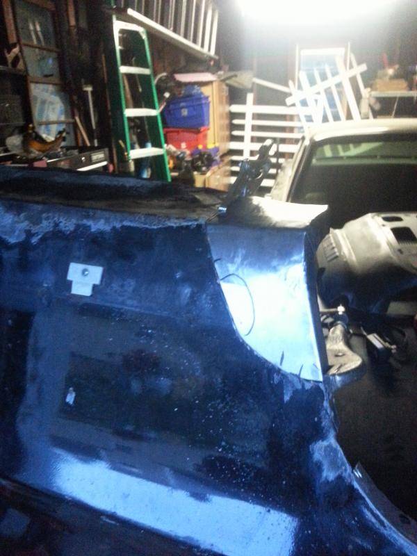

Welp I'm at the end of my finishing capabilities, this is as smooth and as wrinkle free as i could make it. went back and dressed both sides of the weld this time, completely smoothed the back, then cleaned up the front and plannished again. There's not alot to fill, the pics look worse than it feels in person. But i guess we'll see when the skim coat goes on, just how much is really going to be needed.
