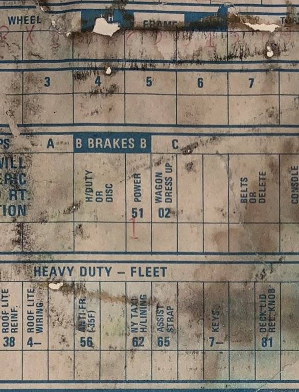

As far as I can see standard size power brakes. Nothing special there.

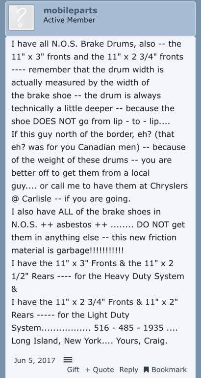

I saw like a year ago a member was selling real honest to goodness brake shoes. Anybody remember who that might be. An East Coaster NY or NJ if I remember right.
I want to say mobileparts is his handle. He's pretty good at chiming in when someone mentions NOS brake parts.
I remember that post, I think he is a vendor on FCBO.

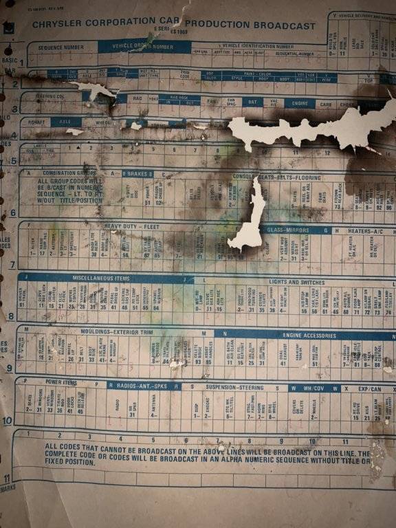

I would pull one front and one rear and measure the shoe width. 3" fronts were standard on police, taxi and high performance. Most of the rest will have 2.75" fronts. With Mopars it is always better to check because there were a lot of variants. It will also vary significantly from one year to another and one model to another.
Dave
Measure what you have in there now, just pop off a drum and measure the shoe. I bought 3" shoes, but need 2 3/4" shoes, oh well.
Dave

They most likely put back whatever was on the car as backing plates have to be changed to change shoe widths. Go with what is on the car now.
Dave
