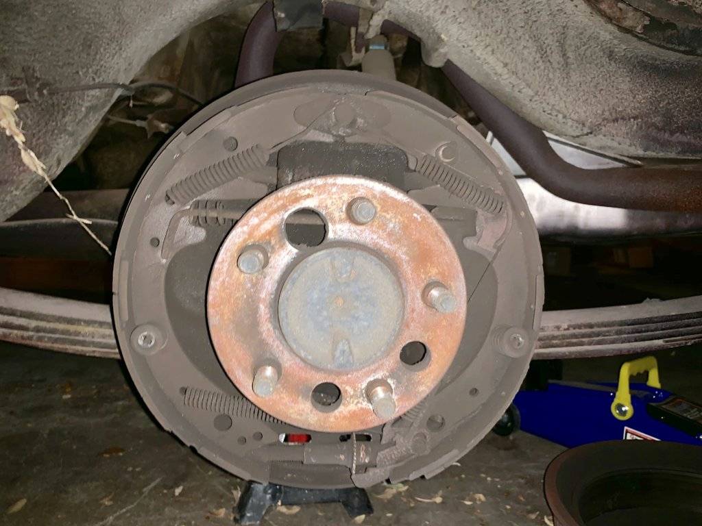

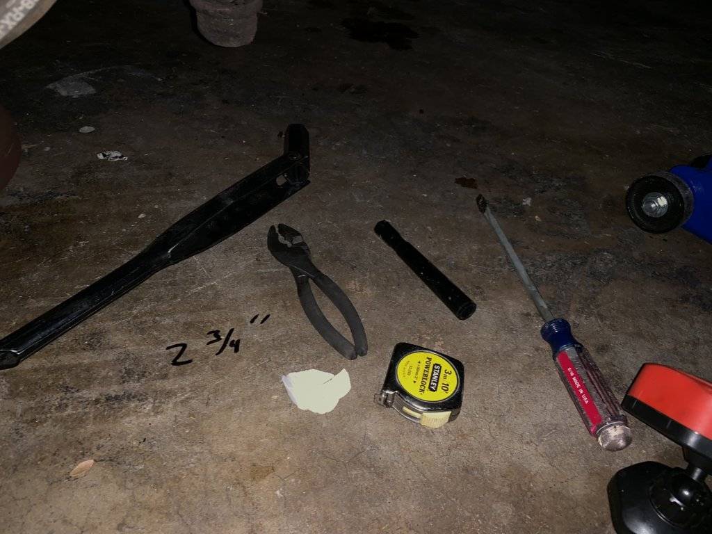

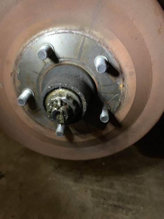

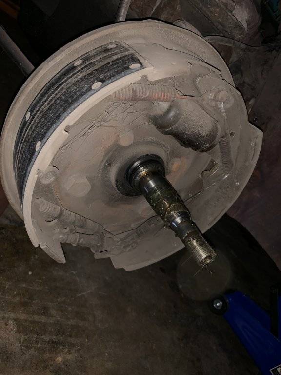

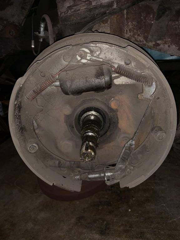

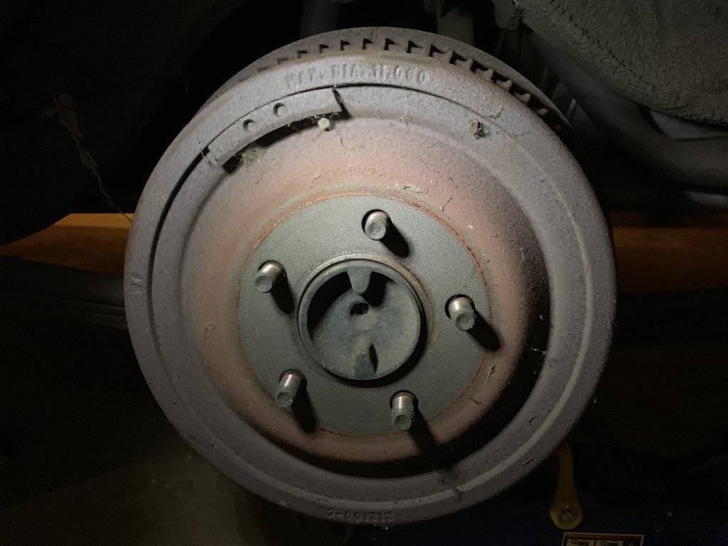

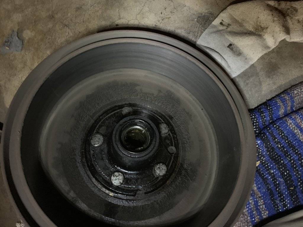

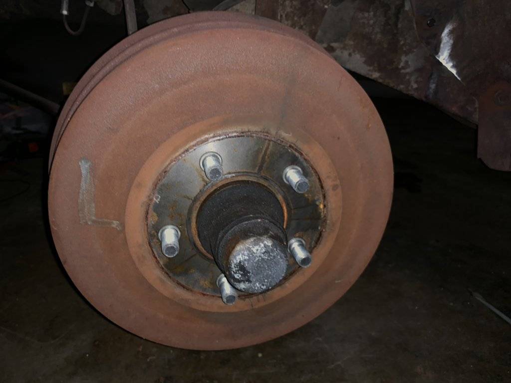

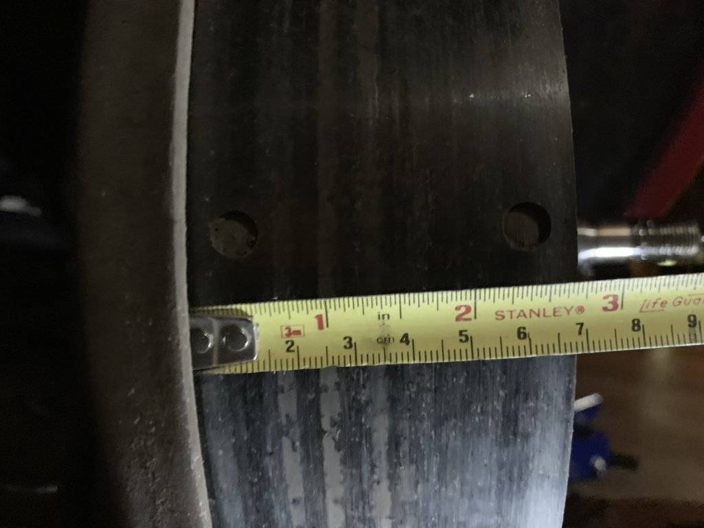

Ok here’s where I am. I got the boss off to England. I got my assistant back to ASU and now it’s just me and the dog. I got the drums pulled and it’s 2” rear and 2 3/4 front. Fronts looked great, the rears were sucking wind.

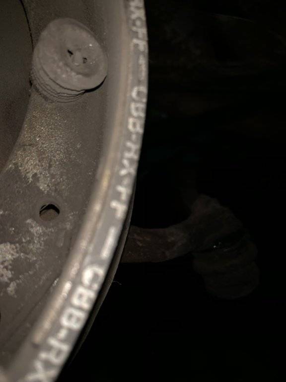

This jibberish was on the side of the shoe.

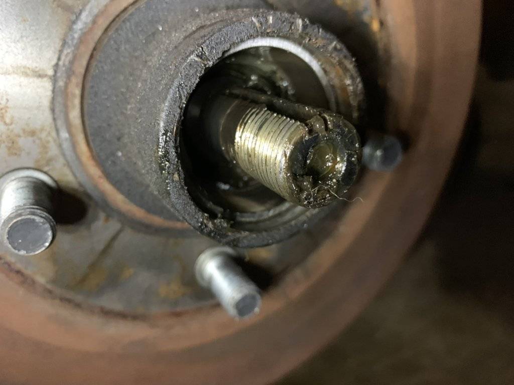

I’m tempted to reuse the old wheel bearings they look like new cleaned up.
I’ll make a list of whatever else I need. The hoses are in real nice shape. So they’ll stay put. Wow that’s a real crappy pic. The rubber is like new. I don’t think they’re very old surely not 50 years !!!
And the shoes are riveted. The rears were cracking. I dodged a bullet.

The letters and numbers on the side of the shoes are lot numbers for the particular batch of friction material. Many are also code marked for the type of material and the rating of the material. While you have it apart, this would be a good time to pull the rear axles and re-pack the rear wheel bearings.

If I pull the axles I know I’ll throw on new bearings and I’ll pull the pig and replace that gasket and clean up the backing plates and paint the rear axle house and then I might as well do the u joints and ...
Dave you’re the devil.
Unless your bearings are noisy, there is probably no need to replace them. Throw on some fresh grease and and call it good.
