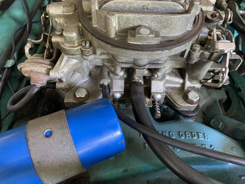

The port I have the vacuum advance attached too is this one:
The port just to the left of the passenger side idle mixture screw. Which I think is Ported Vacuum (not seeing vacuum at idle).

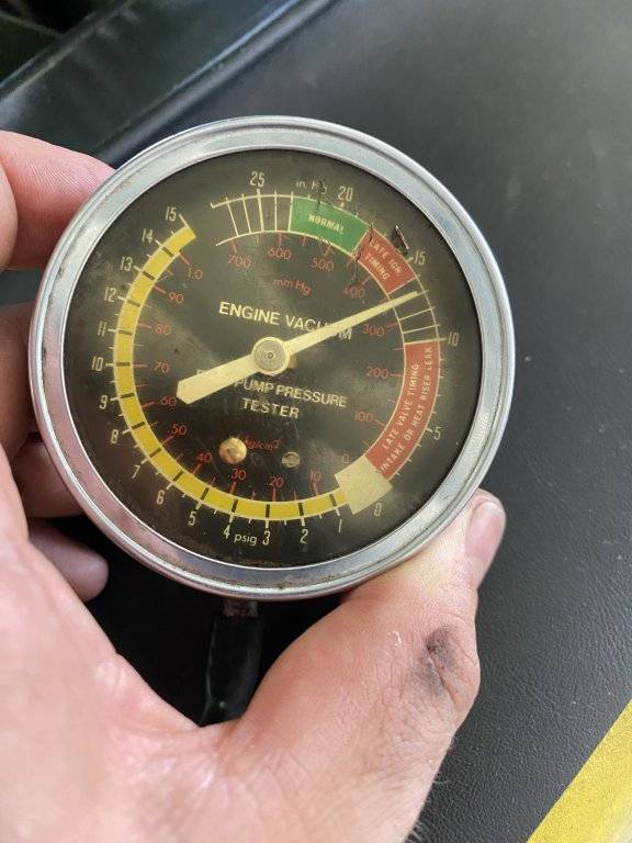

This is the vacuum reading from that port at idle:
Which is 13 inHg at idle.
Now if that is suppose to be ported vacuum that port should not be seeing any amount of vacuum at idle. So first off, am I plugged in at the wrong port? I know the idle speed screw is turned in 5/8 of a turn from the .040" transfer slot opening. So could that idle speed screw be opening the throttle blades enough that the ported vacuum is seeing vacuum at idle? Or if this ported vacuum port is seeing vacuum when its not suppose to could something be wrong with the carb?
