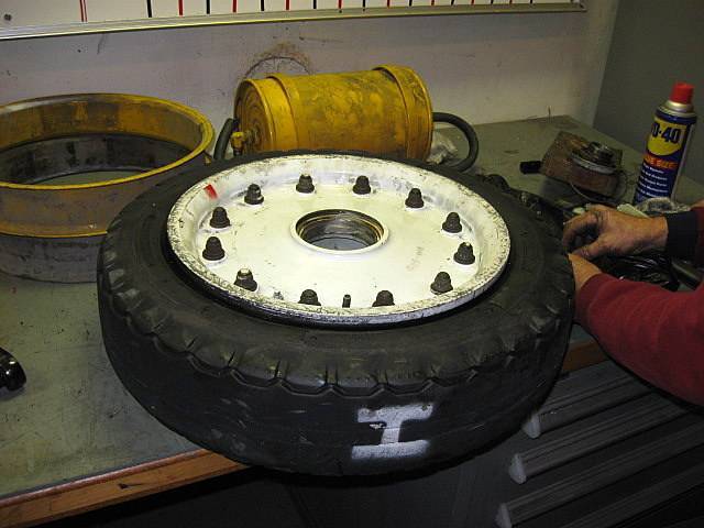

Walked onboard today and back to see the FM-2 Wildcat restoration and got talked into mounting a tire onto a split rim for the A-4 Skyhawk main gear. Old tire falling apart and so a better one needed. The A-4 is not my plane but what the hell. I just love putting 80lbs. of pressure into a split rim. I noticed others where standing back while I was doing it with my arm as stretched out as possible. That done it was onto the plane.

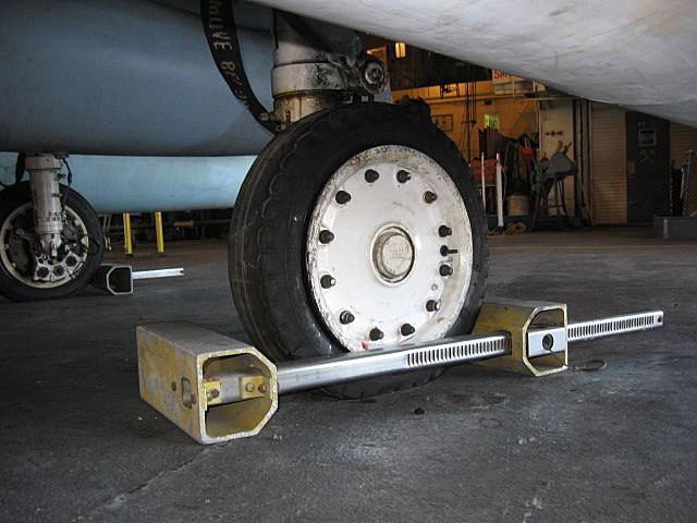

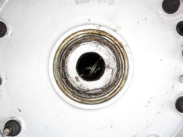

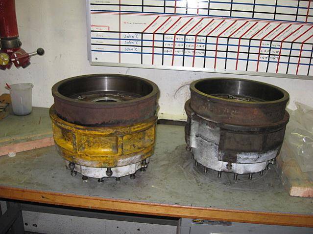

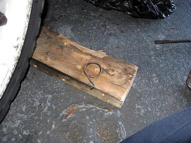

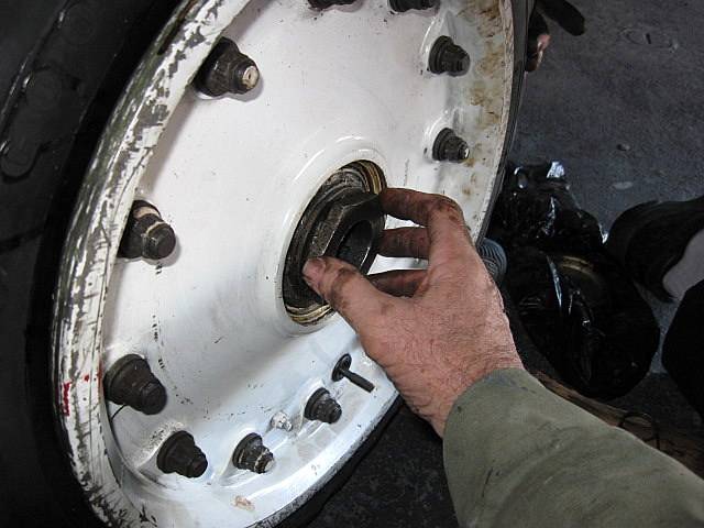

There are two rotors for braking on the jet. You fit the hub over the rotors as the rotors have female slots that correspond male slots on the backside of the hub. I didn't take the wheel off and as soon as I saw all those slots I asked if one was marked so we could get alignment right. No, and it turns out I was right in that they may all look the same but there is a subtle 1/8" difference and so the rotors had to be rotated to find the correct position. With that the hub slid right on. With a 2 1/2" nut someone had to go find a wrench that would fit despite telling me it was only finger tight. I wanted to set preload and then back it off before putting in the Mil Spec version of a cotter pin.

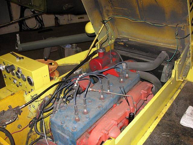

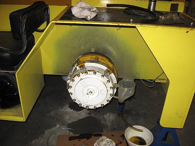

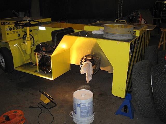

Was also helping a volunteer, who restores Model Ts, finish up the brake job on one of our tugs. Lack of care made one side seize up not to mention a shot muffler and almost falling apart fuel lines with no shut off. The only thing left is the muffler. The tug is powered by what seems to be a Chrysler flat head six. I left the tires to the other guy as a fellow from the Commemorative Air Force came by who happens to fly their TBM and wanted to see ours.

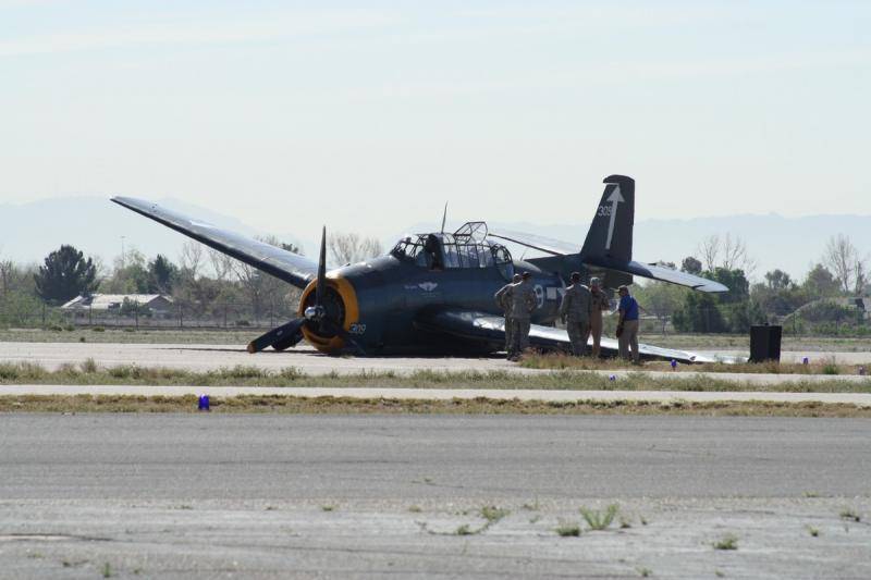

That I am the Plane Captain of so two of us showed him the plane. They have a nice flying one which unfortunately had an accident with a collapsed gear while taxing after landing. He is going to try and help us locate bomb bay door plans. His plane below which actually sustained more damage by those trying to move it than the collapse did. Someone tried to lift the 19,000 lb. plane with a less than capable lift and damaged the cowling area above the wing.
