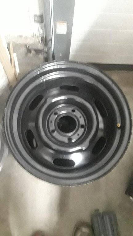

are you talking about solid c body cop car wheels or slotted mid 70s to mid 80s b body/ diplomat wheels ?
They are slotted, here's a pic

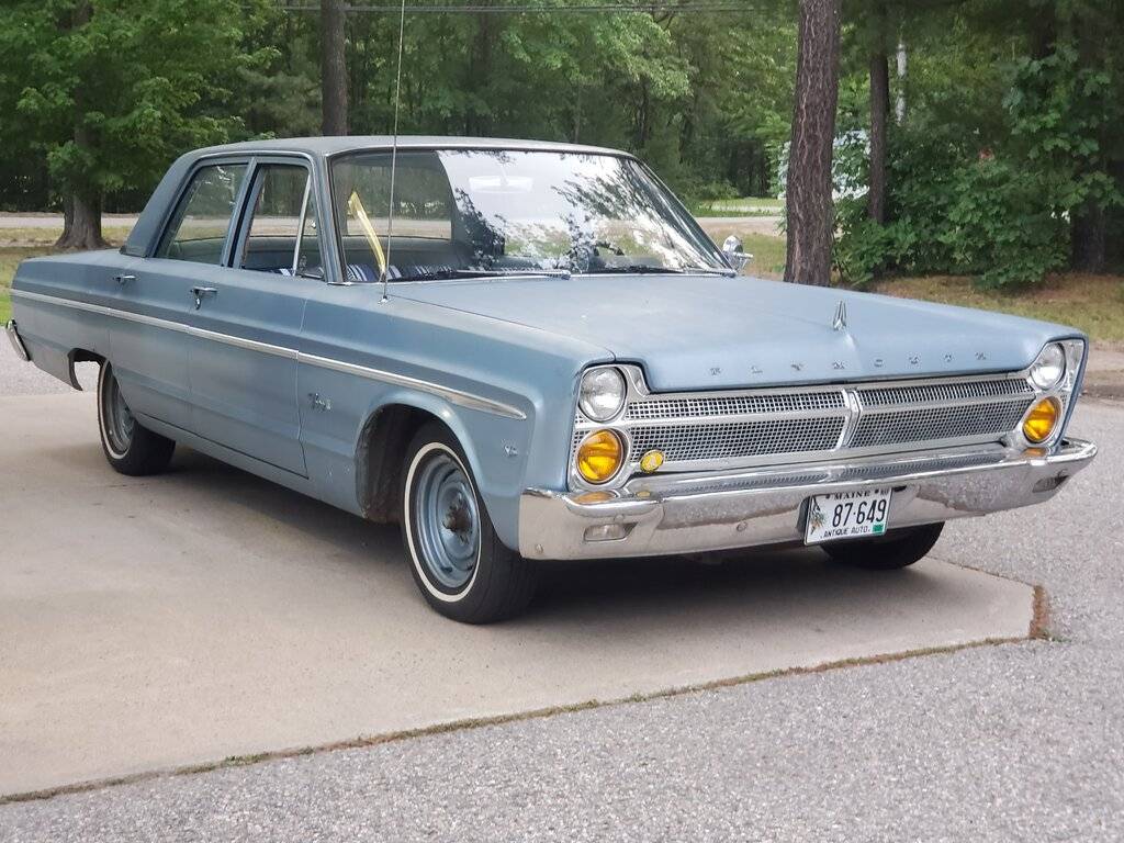

Thanks for both of your inputs, and yes I've been researching this extensively for the past at least 2 months and want to make sure with what I choose will work. I've seen a 2 door sport Fury with a staggered set up they did 15x7 215 65s up front and 15x8 255 60s out back and it looked great IMO but again it was a 2 door. Anyway heres a pic of my progress on my 65 4 door
The agency I work for had P215/70HR15 tires on the Gran Furys with 15X7 wheels. The Caprices had P225/70HR15 tires with 15X7 wheels up to 1994 (P225/70VR15 95-96). The tires often got mixed up between the 2 models. The P225/70HR15 didn't "rub" on the Gran Furys but looked too big and vice versa on the Caprice looking too small.
