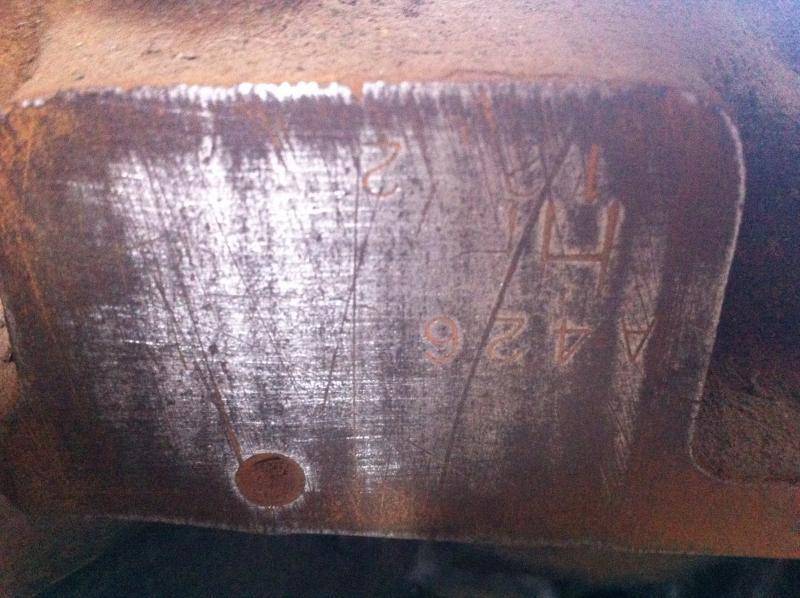

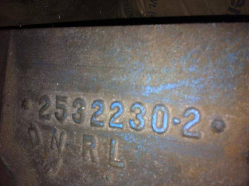

Also .... the A426 dosen't make it a Max wedge block. .....the ID pad opposite the distributor will have unique stampings in a font not found on other versions.
The A designates 1965 which was unique block ... cast #2532230. (Max wedge).
The max wedge blocks also had valve "relef's" cut into them but thay can be added to a 426 streed block
Oh...... And if you should locate an original Max wedge oil pan...... Expect to pay $1800/2000.00 for it.
image.jpgThis one reads

Hard to see through the glare but there should be TM-P stamped into the pad.
Absence of it is likely a 426 street block. Does it have the valve relief's in the deck...?
If so you could probably swap that block & crank for a complete, running 440.
the tmp was for years 62-64 the 65 years had different stamping no tmp just year A and ci. also an H for the higher comp of 13.5

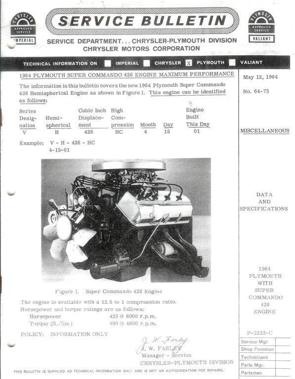

After mid 64 there were no max wedges the he I took over and that spelled the end of wedge development. Yours is probably a leftover and made into a street wedge the HP cam, it may still be useful as correct casting number date code max wedge.
The beginning of the end for the Max wedge..... the intro of the 426 Hemi on May 12, 1964. Due to limited production of the new Hemi There was some overlap and the 426 Max continued to be produced late into the 1964 model year.
The 426 wedge did carry into 1965 as a detuned street engine with one four barrel. I found no record of a 1965 426 Max wedge being produced.

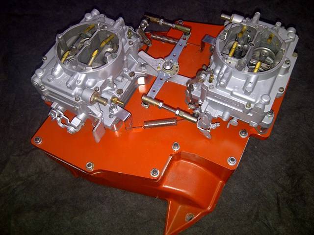

I ran a max wedge setup on a pump gas 440 and it did not have any problems cruising. I ran a cam with just enough vacuum to operate the brakes. The motor would pull 6500 rpms in high gear and get 15mpg cruising the highway with 3.23 gears. I'd put the top half on a mild built 440 and run it. This intake is for sale on moparts.
As cool as that setup looks it's not a Max wedge componant. Looks like a home made, or aftermarker rat roaster.
I'm pretty sure an OEM Max wedge with 11:1 0r 13:1 compression ratio isn't going to pull down 15 MPG. They were deffintly not
