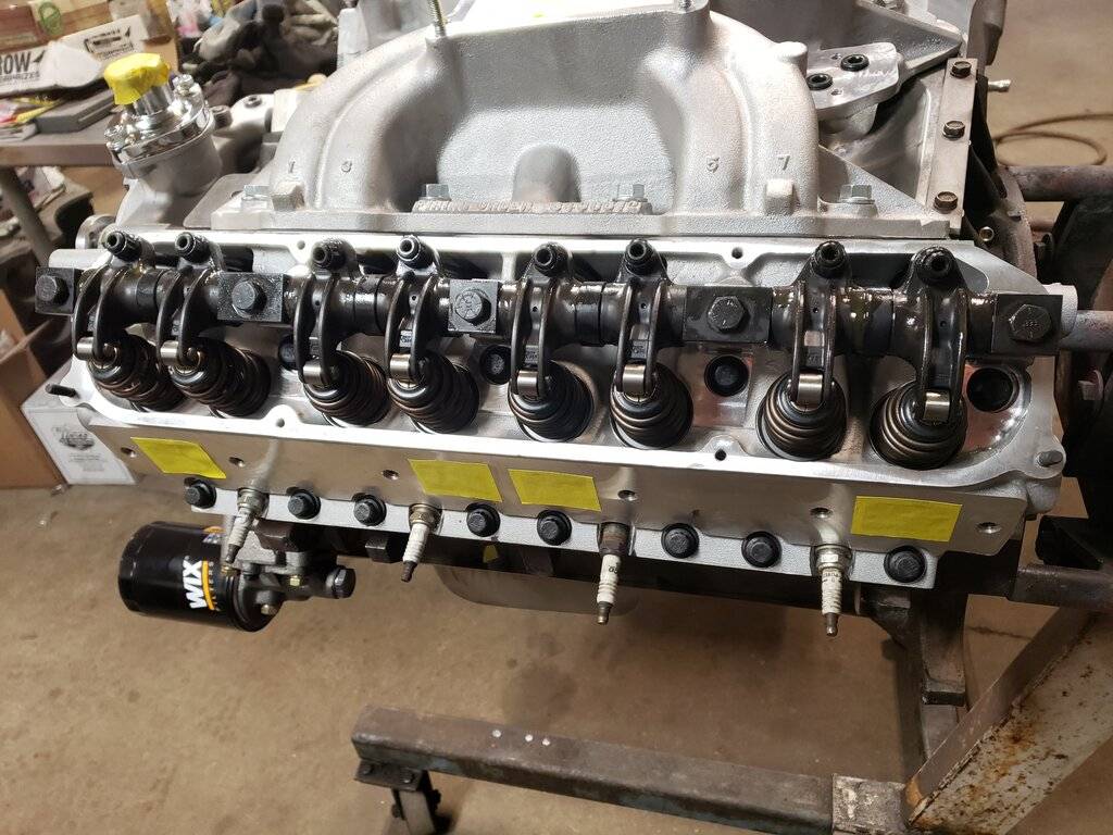

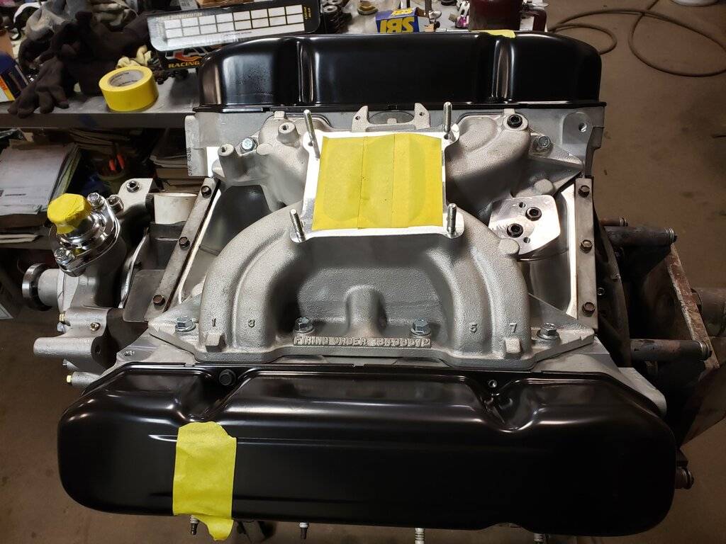

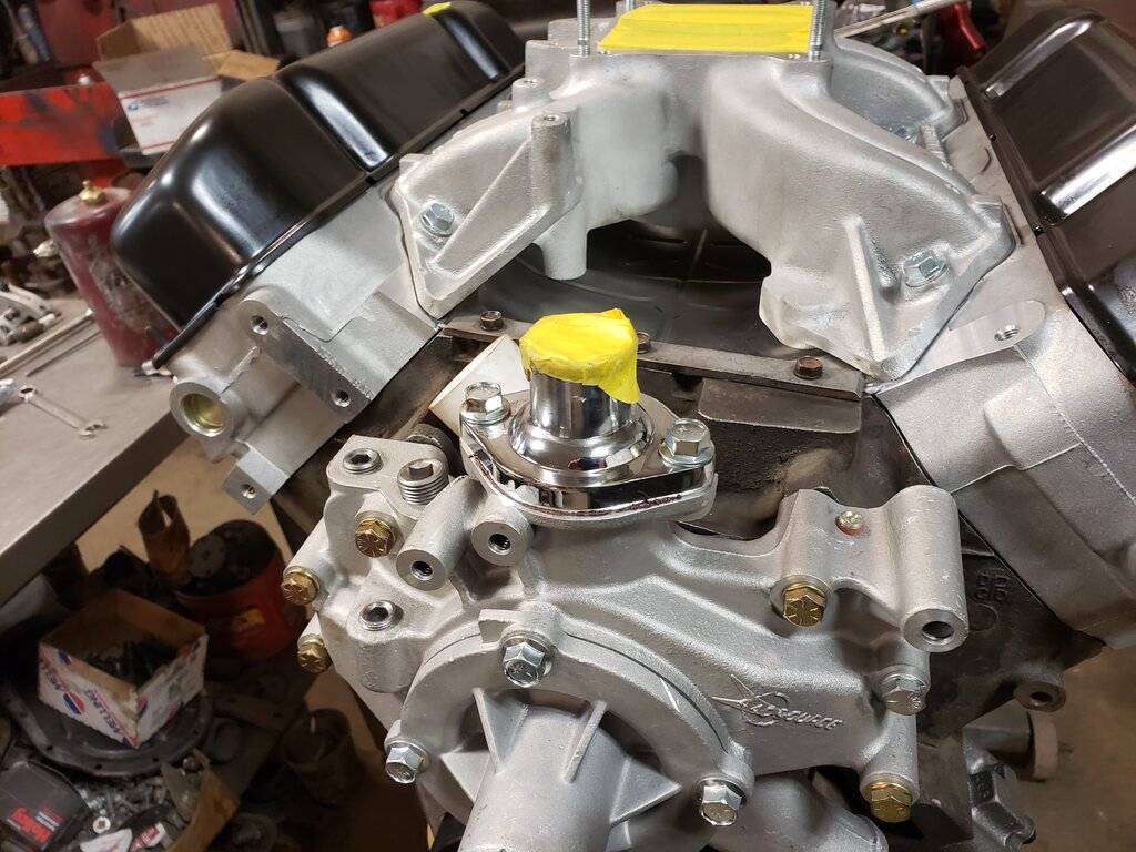

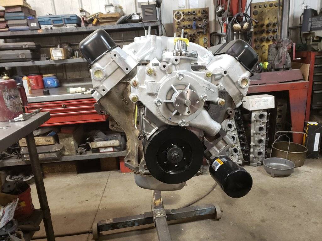

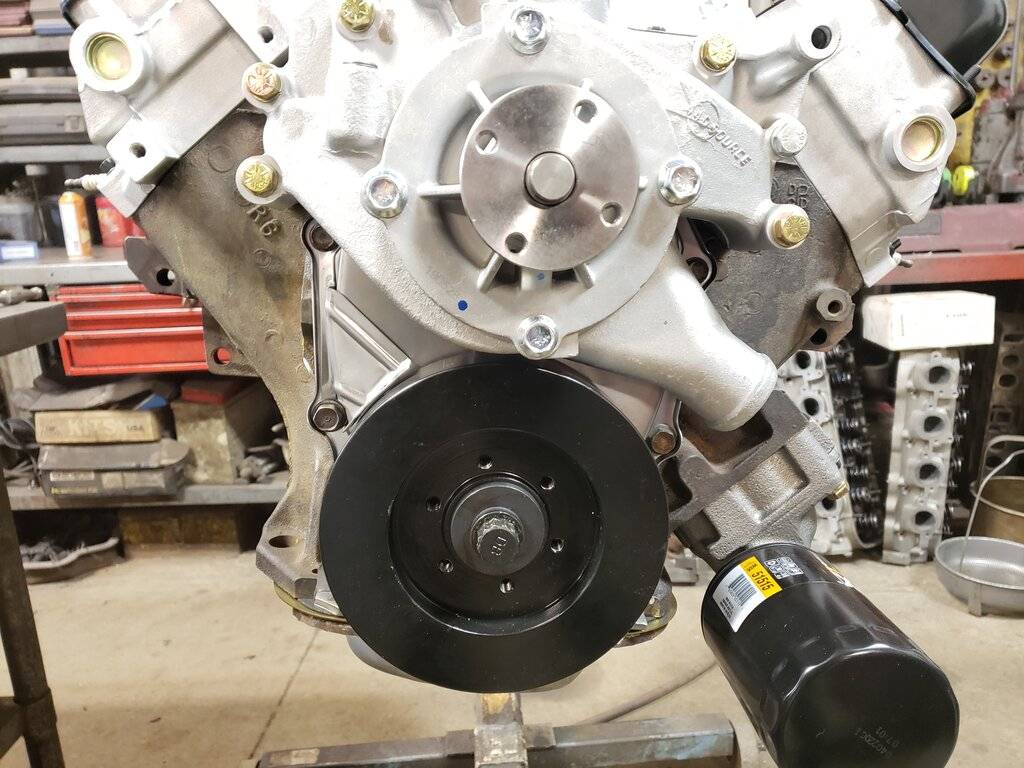

I went and saw my builder to check it out before painting.
Here are a few pics I took today. She will be painted all mopar turquoise to look stock.
