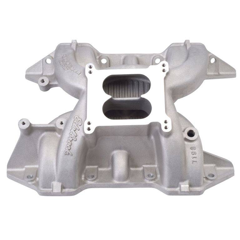

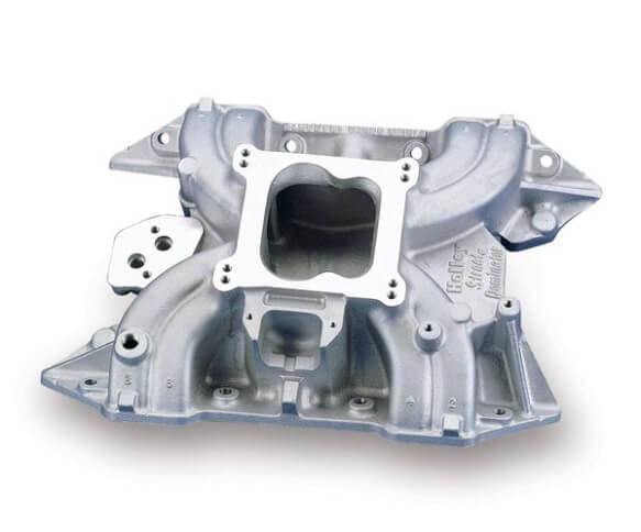

The Mancini drop down base is smaller in diameter than the top. It is essentially the same size as the non-snorkel open bottom air cleaner therefore you are getting fresh air through the snorkels and getting fresh air in through the bottom of the air cleaner. You use a smaller diameter air cleaner element but stay with the same height element so there are no tight corners. Keep in mind that you are just lowering how the air cleaner sits on the carb and while there is more of a corner, there is also more air volume that more than compensates. If someone wants maximum air flow and does not care about appearance, a K & N style filter top air cleaner is the best way to go.
From my research in the distant past on here and other forums on intake manifolds I remembered a few worried about hood clearance with an after market intake manifold. A few recommended the Holley Strip Dominator Intake Manifold. Not because it was the best flowing of all the major offerings but it's height was much lower than the others.
Holley 300-14 Holley Strip Dominator Intake - Chrysler Big Block V8
Edelbrock Performer rpm
Performer RPM Big Block Chrysler RB Intake Manifold
Advertised height of both.
Holley front 4.13 rear 5.25
Edelbrock rpm front 4.90 rear 5.80
Edelbrock states the rpm manifold is 1.75 inches higher than stock.
In Hot Rod tests the Holley did not perform as well as the Edelbrock but it is lower and is a good bit better than any factory cast iron intake.
Here is the article.
Analyzing Six Different Intakes on Our 440 Dyno Engine - Mopar Muscle
