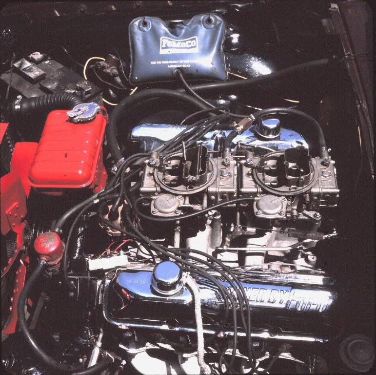

Back in the early 70's I had a built Ford Galaxie that ate up left front motor mounts. I went to the local HW store and bought a heavy duty turnbuckle with jam nuts and a short length of chain, connected it between the frame and engine, and never broke another mount. I could adjust it to allow a little movement or tighten it down solid. I used the same thing on a 67 GTX, 70 Olds 442, etc. You can just see it at the bottom left in this pic.
That's basically the Schumacher torque "strap" right there. Other than the bracket, everything can be bought at most good hardware stores.
