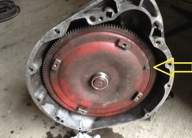

That is something I was not aware of! Is plug easy to get to?
Yes, pull the sheet metal cover off the bellhousing and you'll see the convertor. That's just a couple bolts.
Chances are good, you won't see the plug, but all you have to do is turn the engine over. That can be accomplished a couple ways. You can pull the coil wire (so the engine won't start) and have someone "bump" the ignition while you watch and yell. This gets a little frustrating, so you can also turn the engine over with an 1 1/4" socket and breaker bar on the balancer bolt. That can be tough to do from under the car, so my recommendation is a remote starter switch. I have one of these: https://www.amazon.com/gp/product/B000EVU8MK/ref=ppx_yo_dt_b_search_asin_title?ie=UTF8&psc=1
Hook that to either the starter or the starter relay and then you can do it by yourself. Bump it until you see the plug and then unscrew it and let it drain.
This is actually a pic of a 904 I got off the intrawebs, but it shows the plug well.

Sometime in the later 1960s, torque converter drain plugs were deleted by every OEM.
