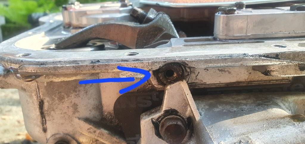

If im not mistaken the low-reverse pivot shaft can be seen from the rear where the tailsection mounts to the base of the trans. The pivot is held in place by the tail housing. I'd think that is where that o-ring goes.
You are correct. The o ring goes around that shaft. BTW you can’t pull that shaft out without pulling the tail housing off.
