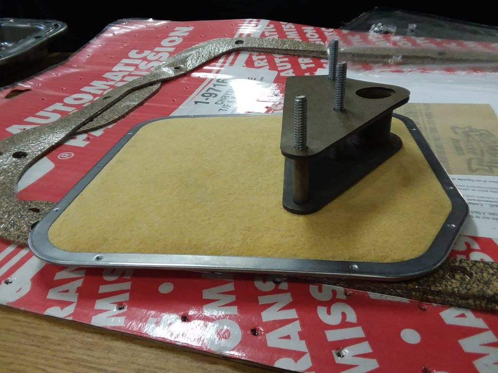

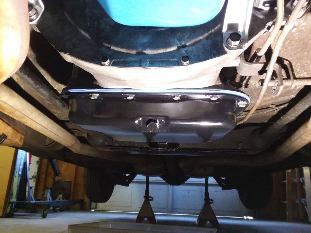

My leaking 1972 727 trans pan, 1st 3 gaskets: I used cork gasket, rubber NAPA gasket, and then rubber NAPA gasket with sealant. (RTV did not stick to rubber gasket) Still had leaks. 4th try: Went with Mopar P3690730 trans pan kit, Moroso 93110 steel core gasket, and 3/4" inch thread length bolts (compensates for thicker gasket by adding 1/8" thread length). I used no sealant and thus far have no leaks. If all else fails...
Moroso 93110 Perm-align Transmission Gasket for Mopar T/F 727 Engines 84663931109 | eBay
New NAPA filter and P3690730 adapter
P3690730 pan painted black and Moroso 93110 gasket

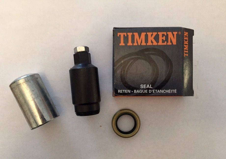

If you use this tool ,you can do it all from the outside . It comes with the remover , installer and seal
Have you ever used that tool? I have to replace the seal in my car and I've seen that tool but never read of how to use it and if it works well.
