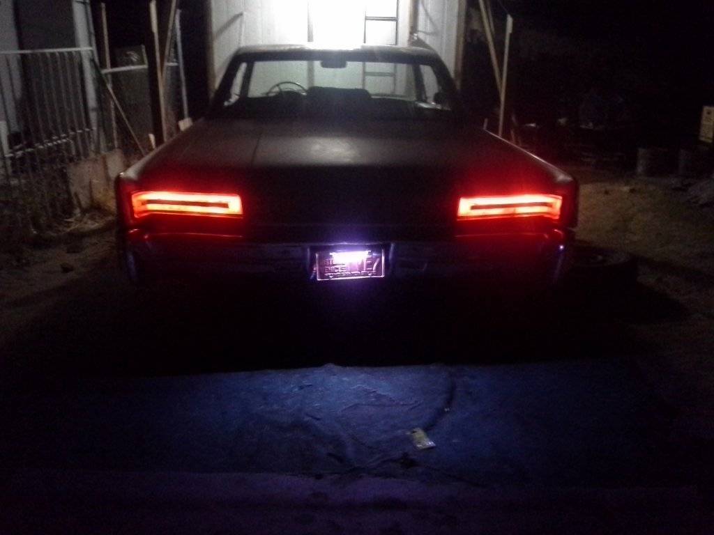

I've been using the $15 red LED 1157s from Wally-World for 6+ weeks now, sans issues with the flasher, which is solidly electro-mech 1920s tech after all. You can see what a vast improvement they are over incandescents, given how old the plastic lenses are here. Cops would pop me sooner or later had I stuck w white light in them, so I eagerly embraced Necessity.

Amen! Cree makes some nice LED headlights to the size of our old rides. (30 W load vs. 35W for low beam, 50 W high incandescent) When I get the $$$, I'm getting some. Old wiring is a HAZARD, so knocking the load down on it by near an order of magnitude really behooves drivers. Old, hard to replace switches will last considerably longer on LEDs instead of crude Edisonian heaters, which is all incandescent bulbs are. I've been delighted with the superior lighting and safety of my tail lights and the license plate light thus far, and expect nothing but good from further upgrades, as budgetary constraints permit. Relays, breakers, new wiring, LED illumination ALL to the good.
