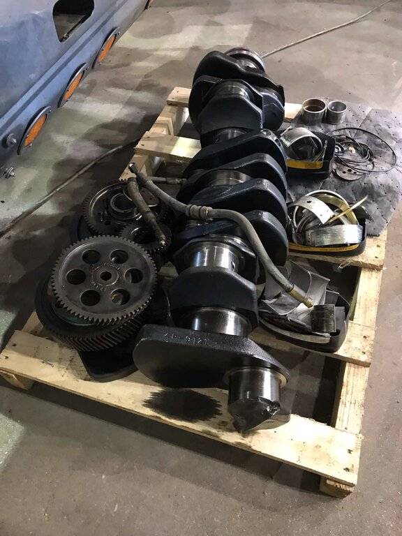

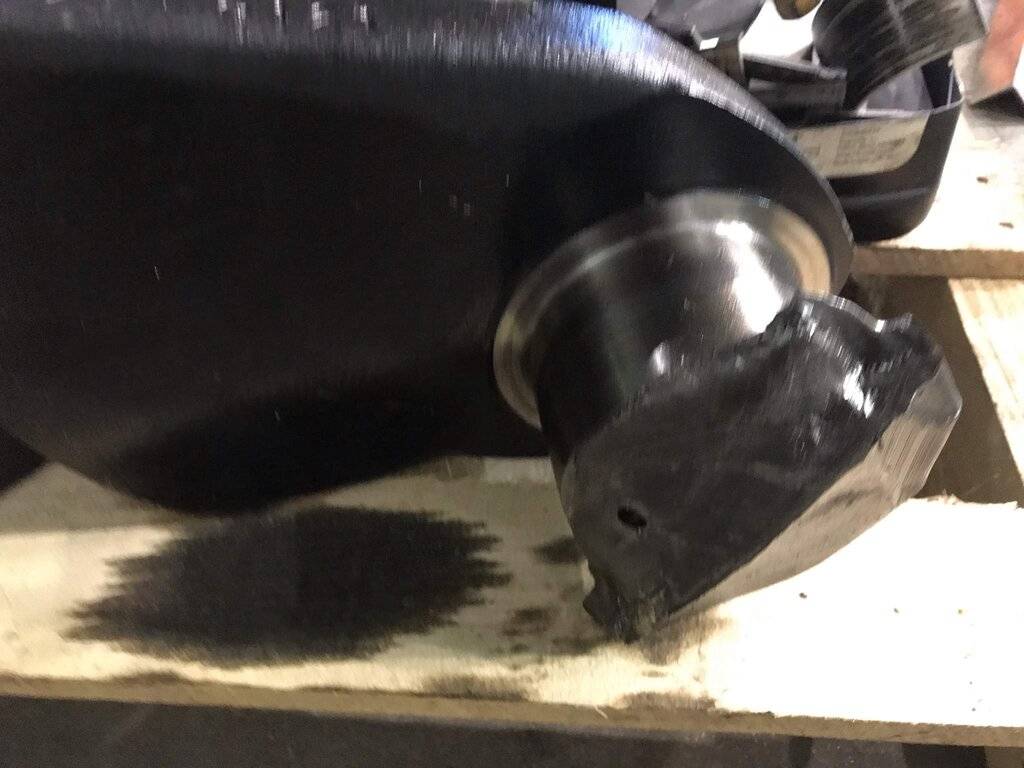

The latest explosion was $25k not counting what it cost me to float it home from Edmonton AB. Had I put in a new crank and timing gears instead of used the bill would have ruined $40k. CAT wants $11k for a new crank...

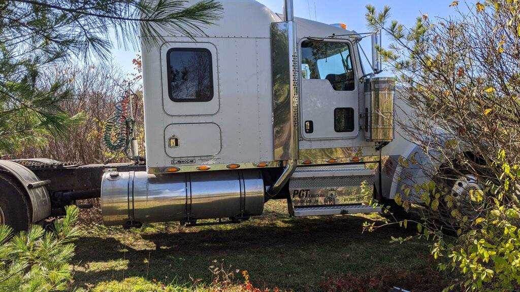

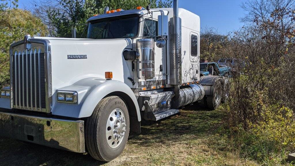

I love my N14s except for a broken crank at 1.5 million and a couple of head gaskets they have done me no wrong. If a good chassis would have come up (blown to bits engine) I probably would have pulled my N14 out of this truck and done that. This truck needs a cut off with modern rears (read: common parts) and a later model steer axle, more common parts. Needs way bigger u joints on all the front driveshaft locations. I would have to buy another junker truck to get me by for as long as this one would be in rebuilding.
The newer Kenny solves a couple of problems and hopefully keeps me out from underneath it with major repairs. The engine has not run the road (overnight idle) in 10 years. I'm aware of EGR problems and how to "fix them", that's all I'm saying on a open forum.
The KW not a filter, or aftertreatment truck because you can't get them across the county without a check engine or warning light, then the inevitable derate.

Here is a couple daylight photos I'll get some more later today after clean up.
