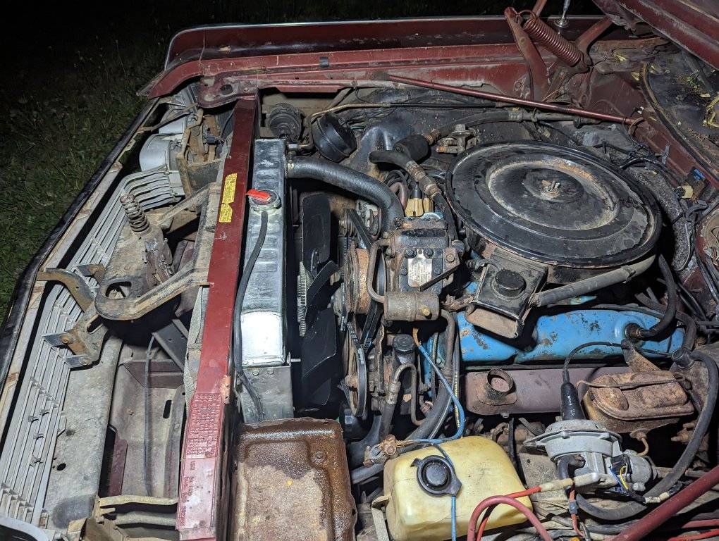

Took it for a short drive, ten miles, and it overheated. Let it cool down some and headed for home, but didn't make it far as it was still hot. I pulled into a store where I could get some water, and discovered a small crack next to the upper hose. Forty minutes later and a gallon of water and I was headed home, again. She was whistling as I rolled into my town, and was steaming after I parked.
I have the aluminum radiator I installed in the Cicada Monaco 500, so that will go in. I'll only have Thursday and possibly some time on Friday to work on it, so it will be another thrash to get it ready for the show on Saturday.

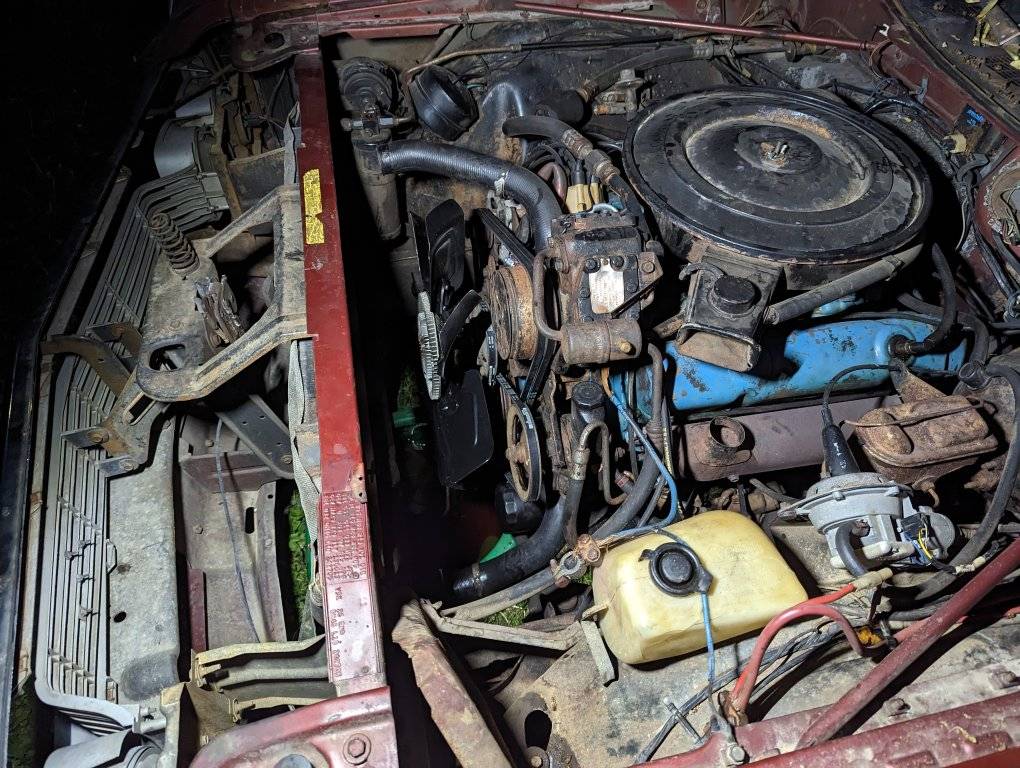

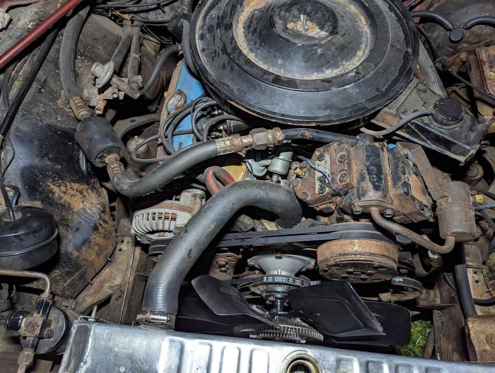

Old radiator out, 3/8" rachet 7/16" socket, 6" extension, flat blade screwdriver, 1/2" wrench, 5/8" wrench (copyright @1970FuryConv )
Newer radiator in.
Sucked I had to take the battery tray out to get the old unit out, but not a big deal, I'm just used to my Slabs being able to slide past the tray when swapping radiators. Also sucks the damn hood latch hangs so low, I tagged it twice, right off the bat. Wyatt got to hear me ***** about it, but those things hurt! Kiddie pool noodle is on the list. I might throw a shroud on it, but I need to find some nuts, not sure if I have any.
Newer radiator in.

Threw in some coolant, and of course, the water pump is bad. :BangHead: So the shroud will be going on as the fan is coming off. Just need to find a pump in my stash, or order one and get it Wednesday night.

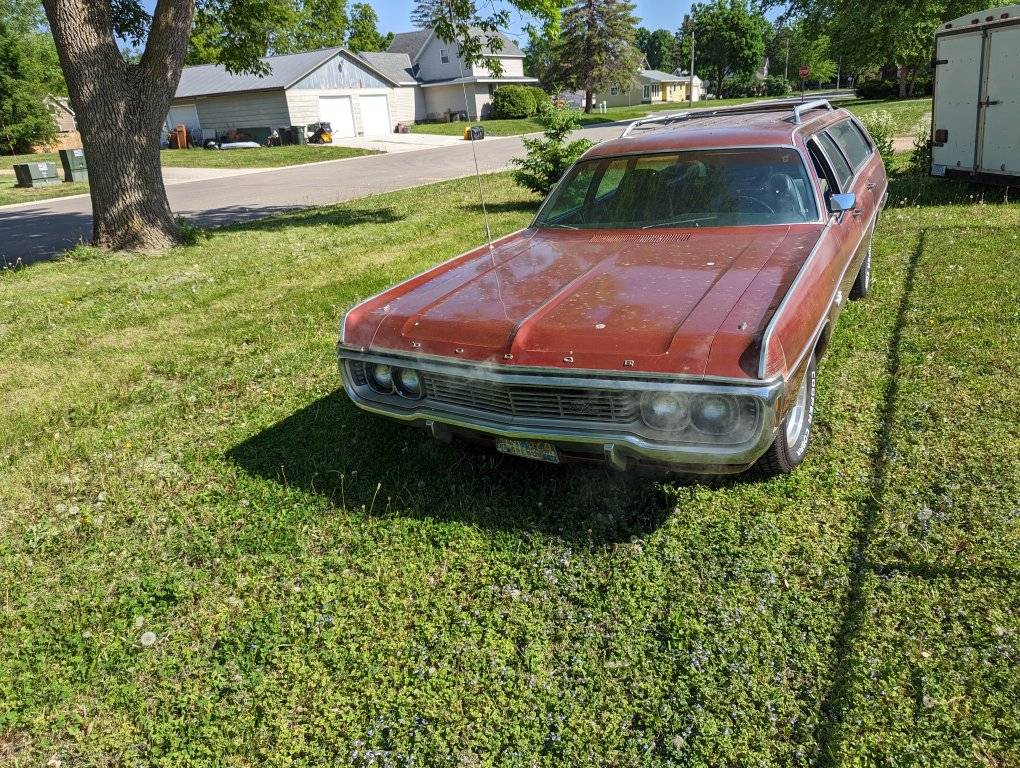

I've posted a couple of pictures, thought I'd get around to starting a thread for my '71 Monaco wagon, which has picked up the name UNBREADED! thanks to Wyatt @71Polara383 and a certain YouTube stream.
I got the car at the beginning of April, out of Idaho. Also got two dogs along with the car. They were going to go to a shelter, as the seller was moving and couldn't take them with him, and I couldn't let that happen.

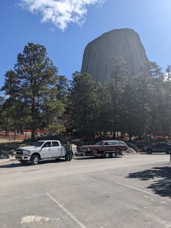

Stopped at Devil's Tower for the required photo shoot. Third car I've brought there.

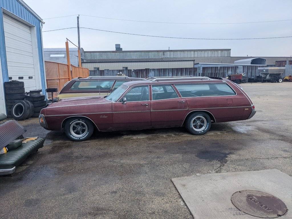

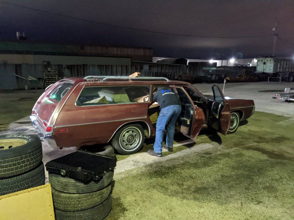

The next day we all loaded up for a day trip down to Rockford IL, to drop off the wagon with Wyatt. I had little to no space, and very little time, and Wyatt knows these cars much better than I do, so I dropped it off for him to go over.
As you can see, there were plenty of parts in the wagon, some for the wagon, most for '70 model year cars. I gave the '70 stuff to Wyatt.

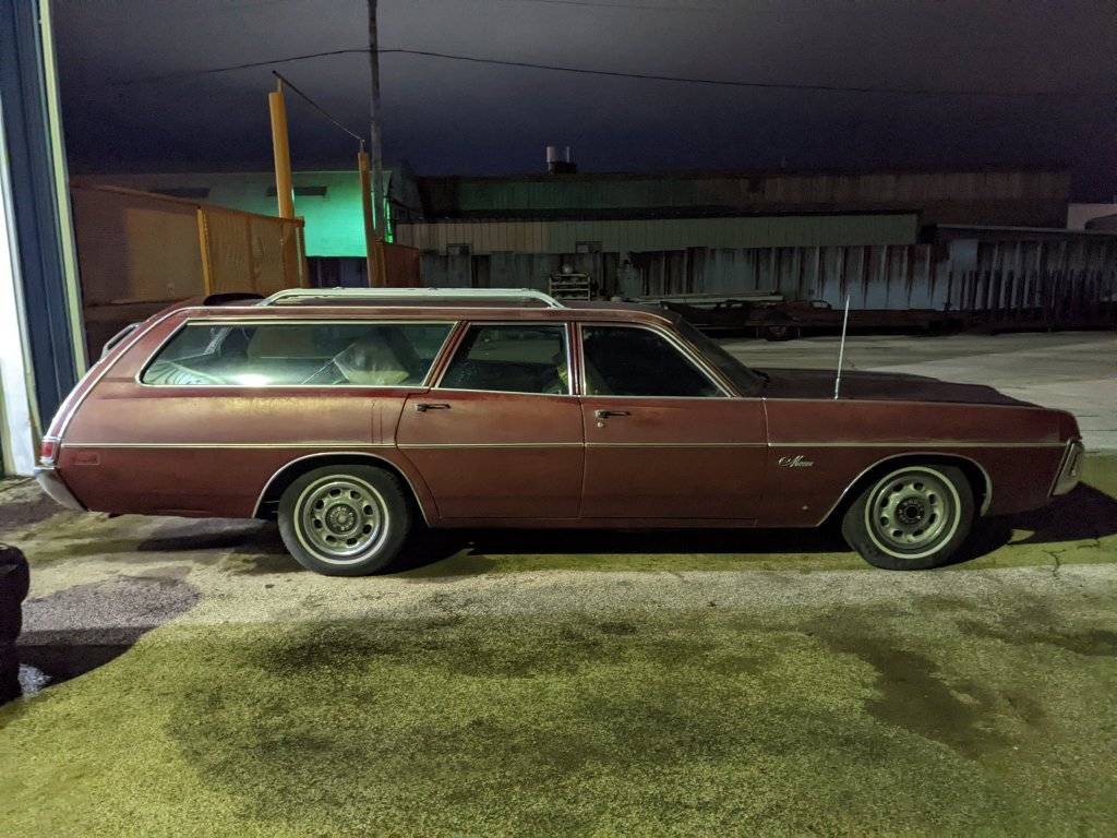

At this time, the drivers rear door didn't open, the tailgate glass didn't operate, the dash pad was roasted, and the dash faces were bad, or missing. The heater control was also bad, and the radio was sitting in a box. @70 Sport Suburban Manny hooked me up with a sweet dash pad and dash faces and some other bits, got the door to open, and fixed the tailgate operation. A big thanks to Manny and Wyatt for getting that done.
Next up for Wyatt was the drivetrain. He got the car started and running. It purred like a kitten at idle, and even moved under it's own power. A 383-2 car, it's not the fastest, but it does have a 3.23 rear gear. It developed a lifter noise after warmup. Nothing at idle, but under load, there was some noise. And the oil light would come on. Cooled down, it was fine and no light, but once warm...

Old water pump out, new one waiting to go in. I had to do through my parts to find a gasket. It was past ten o'clock when I finally found one, so I scraped off the old gasket and called it a night. I'll get some sealant and put it on tomorrow after work. Drive it by Thursday and make sure it's ready to go.
Is there no gasket in the box when you buy a new pump ?
Or is that just with a fuelpump....

I had a pump I bought off a member, and a gasket with another pump I found later. Too many parts in different locations.
More moonlight motor madness.
I waited until it cooled down some and went out to work on the car as the neighborhood went to bed. Still humid but I got it back together. No shroud, the ones I have don't fit the radiators, too wide for the aluminum, and wrong mounting for the one I took out. They will still work on other cars, I think.
Heading out to grab more coolant, top it off and go for a drive.

I love that aluminum radiator! It runs nice and cool, just like it did in the Cicada. But the steering is getting noticably worse, it wanders enough that I didn't take it to Mopars in the Park. I was worried about intermittent brake lights, and a stumble in the carb, but the steering had me more concerned. There was enough factors for me not to take it, just had a feeling. I'll get it sorted out in the next week or so.

Can you share some details on the aluminum radiator? I am thinking of going to that. I have an aftermarket “looks OEM correct” radiator from a B-body supplier. I’m thinking of going to something more modern.
I got it with an engine I purchased. No name brand, said china in big letters on the box. Cicada had a weeping radiator so I put this one in. I expected it to be junk, honestly. Gauge went from the halfway mark down to just above the low end of normal. Never had any issues in the summer, and I drove that car a lot.
