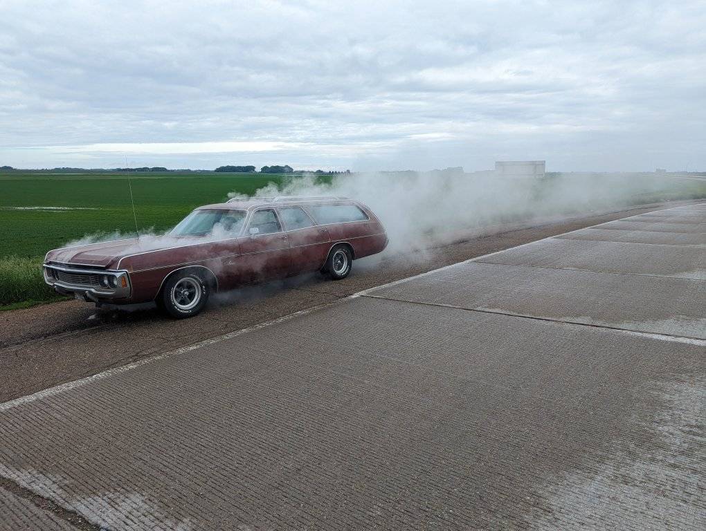

Well, that didn't go as planned. The radiator decide to **** the bed. It was losing power before the coolant puked out.
Luckily, I hadn't really gone that far from home when it happened. Better close to home than a hundred or so miles away.
Stealth wagon!
I hope you get home safely and figure this out. Maybe you need to bite the bullet and refresh the engine.
Getting it towed, not sure I have enough antifreeze to make the trip home.
