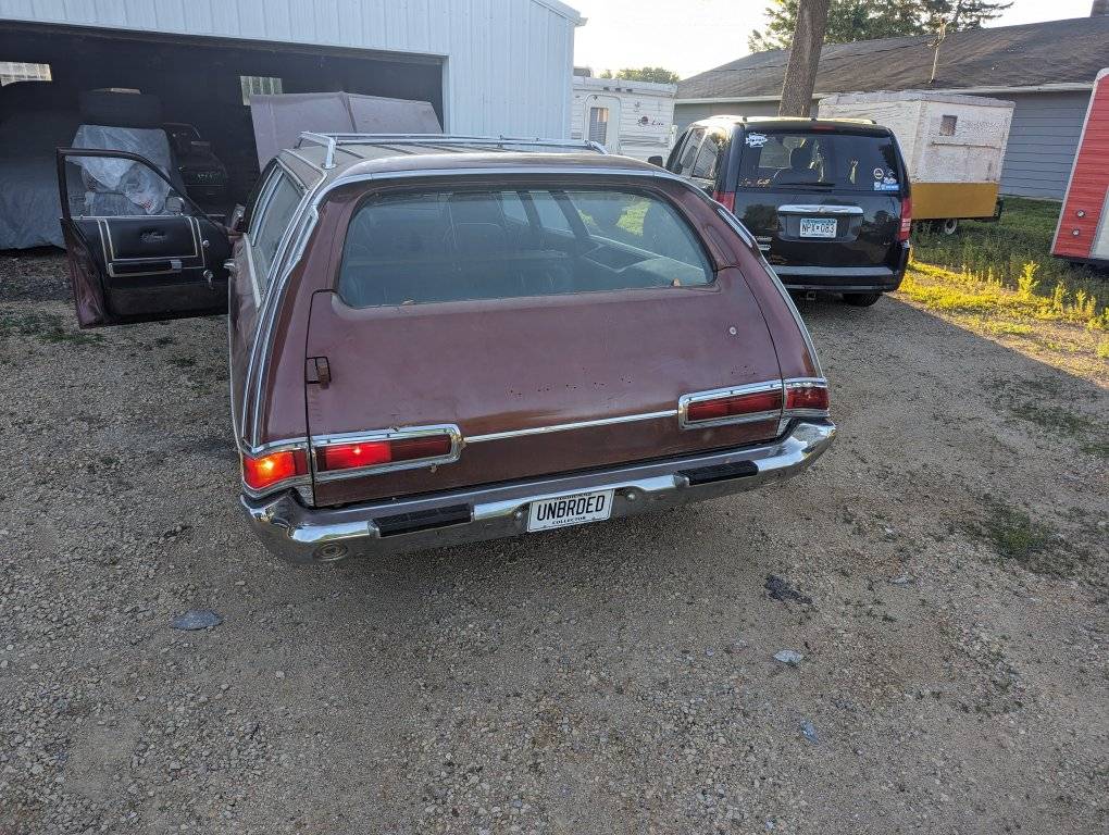

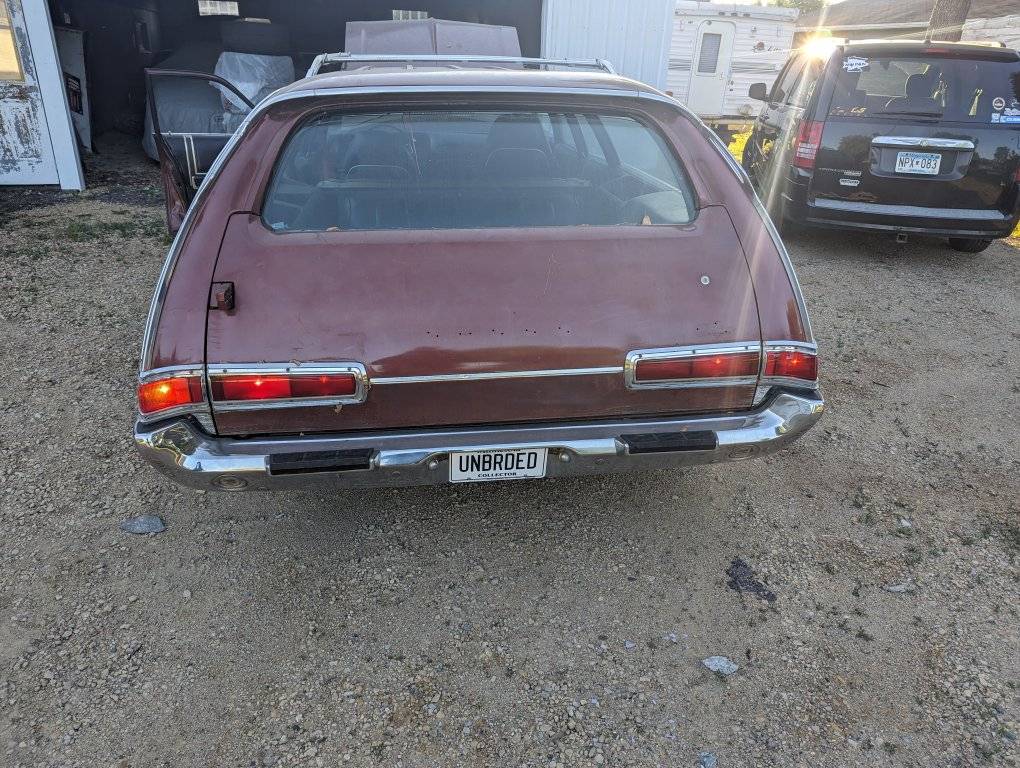

Took the wagon out of storage today, I wanted to chase down a no brake light issue.
I blocked the brake pedal down with a shovel, and I had nothing. Turn the lights on and I had them.
Checked the fuses all were good, looked at the wire covers above the rocker. I just wiggled one section in the back seat, and tried again, and had brake lights, on the driver's side.
I'll check the bulbs and get it ready for the big show this weekend.

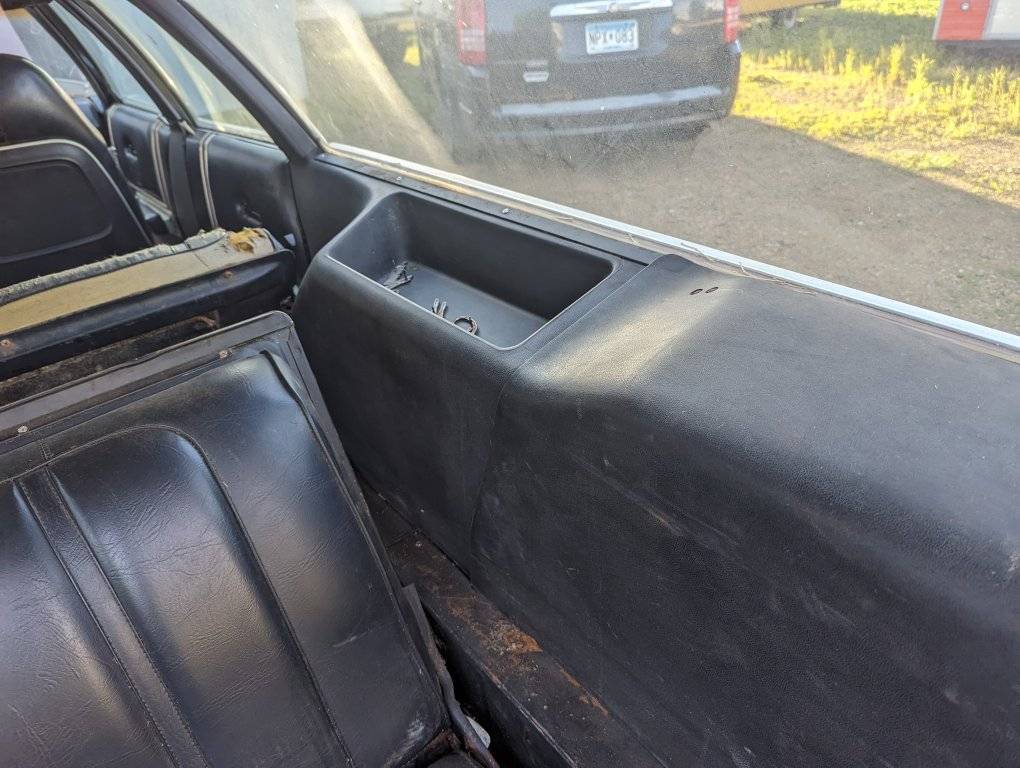

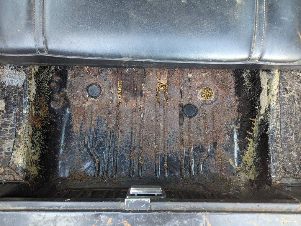

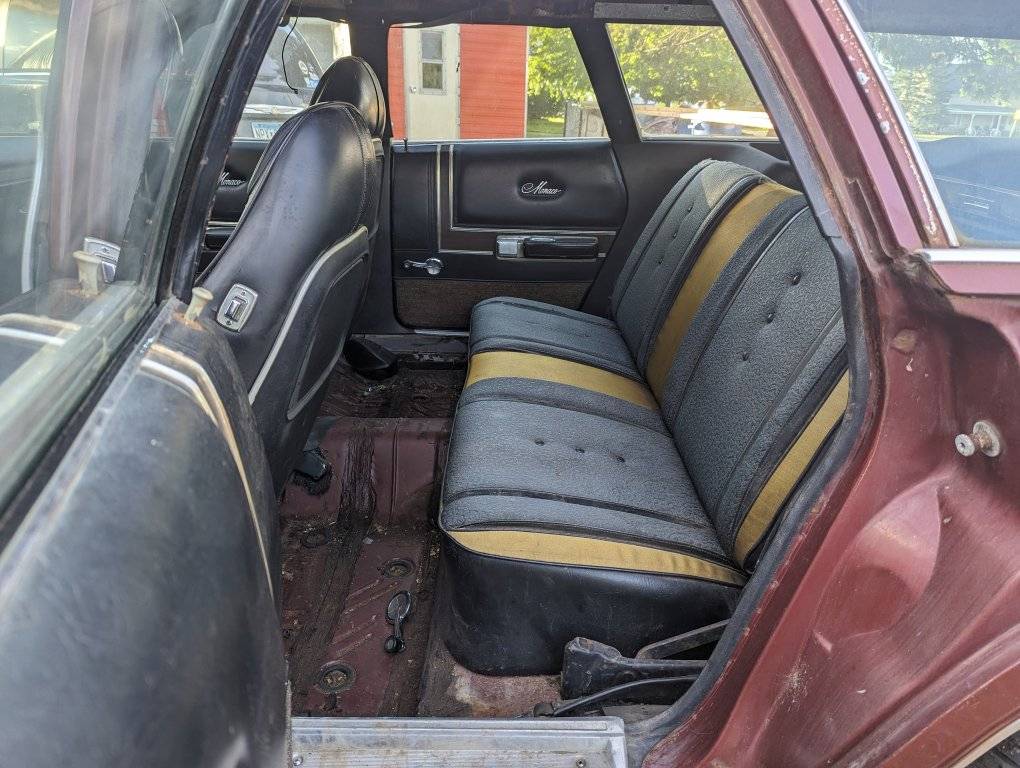

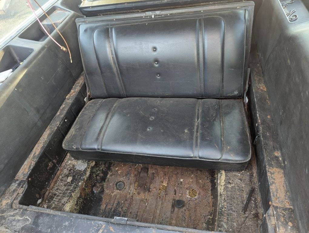

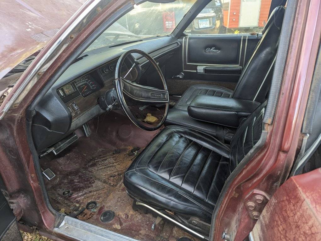

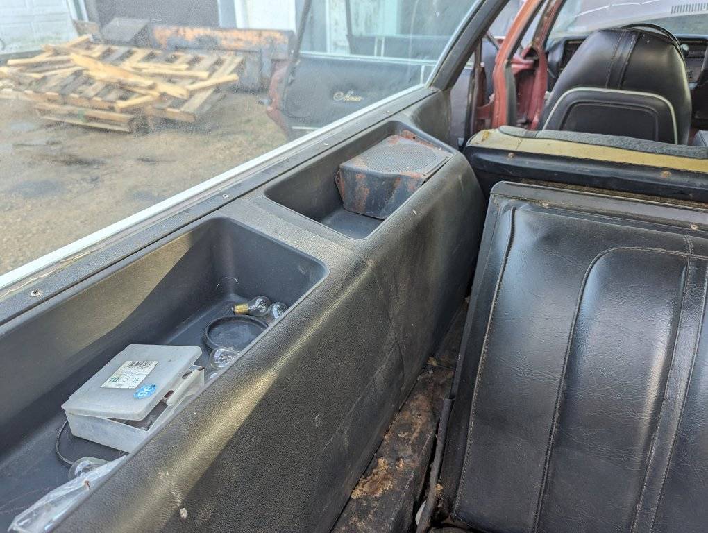

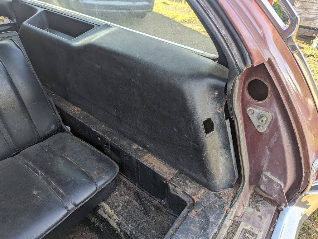

Well @david hill, the weather turned nicer, so I stopped by and got some pictures. Nothing fancy at all, just the buckets I traded for with Wyatt, the buddy seat that came with the car, from @sixpkrt originally, and the factory second and third seats. The hard to find plastics in back are all in excellent condition, but the footwell has seen better days. @71Polara383 may have a replacement for me. Carpet was taken out before it came to Minnesota, and who needs a headliner? There isn't a lot of noise due to no insulation on all that surface area, thankfully. I need to see why the air duct fell off last fall, but I'll get around to that sometime in the future. A little floor repair in the driver's footwell by the rocker/plugs, and the aforementioned rear footwell. The only other spot of rust is the driver's fender dogleg, don't know when I'll open that can of worms.
