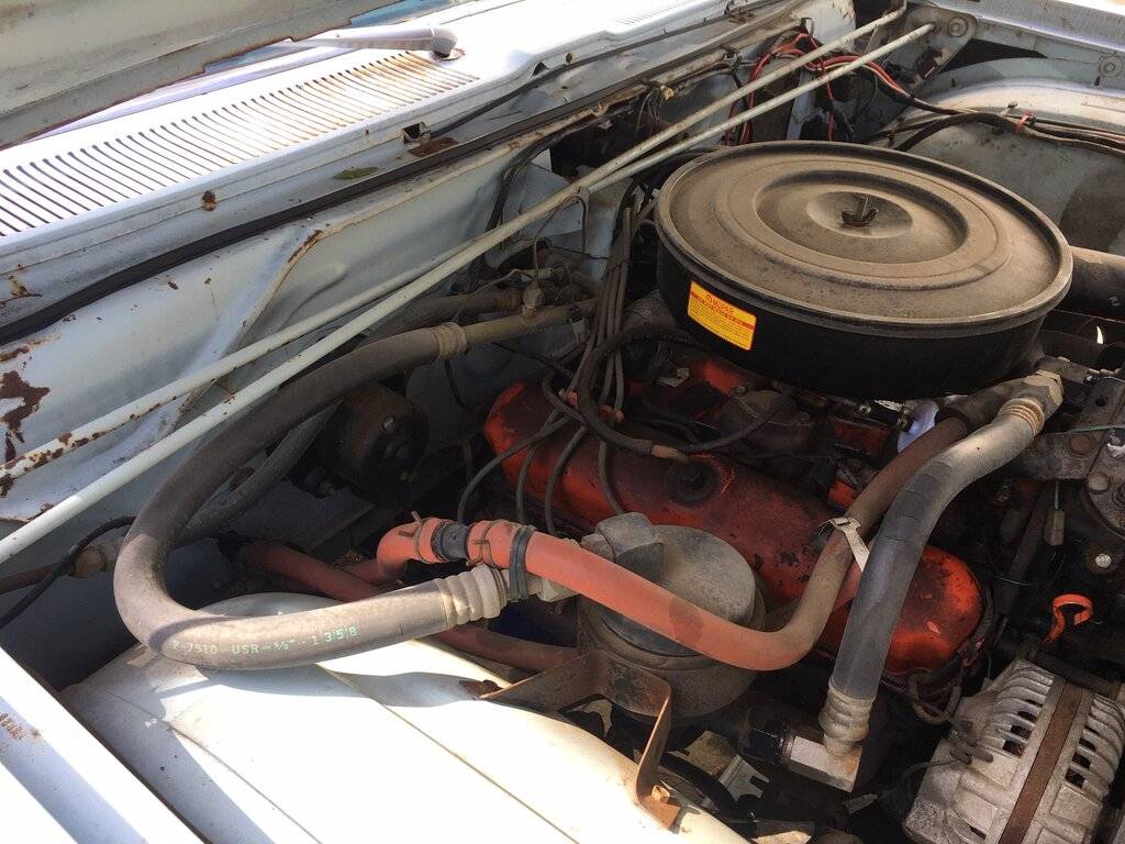

I've got a '68 Fury a/c car that I would like to update to a R134 and a newer lighter compressor like a Sanden or similar. How much else do I need to change? Can I switch compressor, put a new receiver/dryer in and get new hoses made up and leave everything else standard or is it more involved than that? What compressor and mounting brackets have people here used and would they recommend them?(looking for big block brackets as I will be swapping out the 318) Finally, what is the round black thing on the inner fender here?

The big black thing on the inner fender is a receiver / dryer, I believe.

I don't recall ever seeing that thing mounted on your inner fender but I don't think it is the dryer. (maybe a muffler of sorts) but in addition to all you mentioned for updates, I would include the expansion valve. (located at the firewall)
If it were me, I would get the new compressor and brackets mounted, Buy a new dryer and expansion valve, then have an experienced A/C shop replace the hoses, test the evaporator and condenser, evacuate the system and charge with the 134. They may want to replace the condenser too.

Also keep in mind that as part of the conversion to R-134a, all of the old refrigerant oil must be removed from the system. The mineral oil used in R-12 systems turns into something approaching Gorilla snot when exposed to R-134a. R-134a is a significantly less dense refrigerant that tends to leak out more readily. Replacing all of the o-ring seals with the high density green o-rings is a must. You will already have to replace the hose set to use the Sanden compressor. Replacing the condenser with a unit designed for R-134a will improve the performance of the system as R-134a being less dense needs more condenser surface area to properly cycle the refrigerant. The object mounted to the fender well is a muffler. This device was used with R-12 to keep liquid refrigerant from being ingested by the reciprocating compressor. Liquid refrigerant causes "hammering" when it gets into the piston bores. The muffler is not needed for the conversion to a Sanden compressor.

My 68 wagon still has the factory a/c system that works and mine does not have anything looking like the object mounted to the fender well. My car is a early bid Nov 67. Maybe it was something added to later built cars.
From what I remember from back then, that larger muffler was only on 318s, not on B/RB engined-C-bodies back then. The 383/440 RV2 compressor line had a small muffler in it, close to the compressor.

The fender mount muffler was larger because of where it was mounted. Big blocks had the muffler mounted above the engine where it was exposed to a lot more heat that boiled off most of the liquid refrigerant in the return line. The 318 cars did not have enough room to do that so a larger unit was mounted on the fender well.

The muffler was there to smooooth out the gas flow through the system. The compressor output will have pressure pulses due to how it operates, especially at lower compressor rpm.
When my '77 Camaro was newer, one spring day I turned the a/c on for the first time in a/c mode and at certain engine rpms, got a new harmonic vibration that seemed to be coming from behind the instrument panel. Only with the compressor running. Diagnosis indicated that it was due to the fact that that factory a/c system had no muffler in it, BUT the more upscale Firebird models DID. As did almost every other GM factory a/c system, but not Camaros.
So, the shop foreman advised of an auto supply to go to get the needed muffler and clamps, which I did. I'd already looked at the Delco A/C Illustrated Parts catalog for information. Got the new muffler installed and all was quiet again.
That was with the GM A-6 (6-piston) compressor that generally operated very smooth and quiet. Obviously with more even pressure spikes (or less intense) pressure spikes than either the Chrysler RV-2 or Ford Tecumseh 2-piston (BIG piston, by comparison) compressors. I suspect the newer-design Sandens might operate smoother than the older compressors?
It could be that the receiver/drier might act as something of a "muffler", but maybe not, depending upon its placement in the gas flow system? Once everything is installed, might be a good idea to design-in a length of hose (compressor output) where a small muffler might be installed later on?
