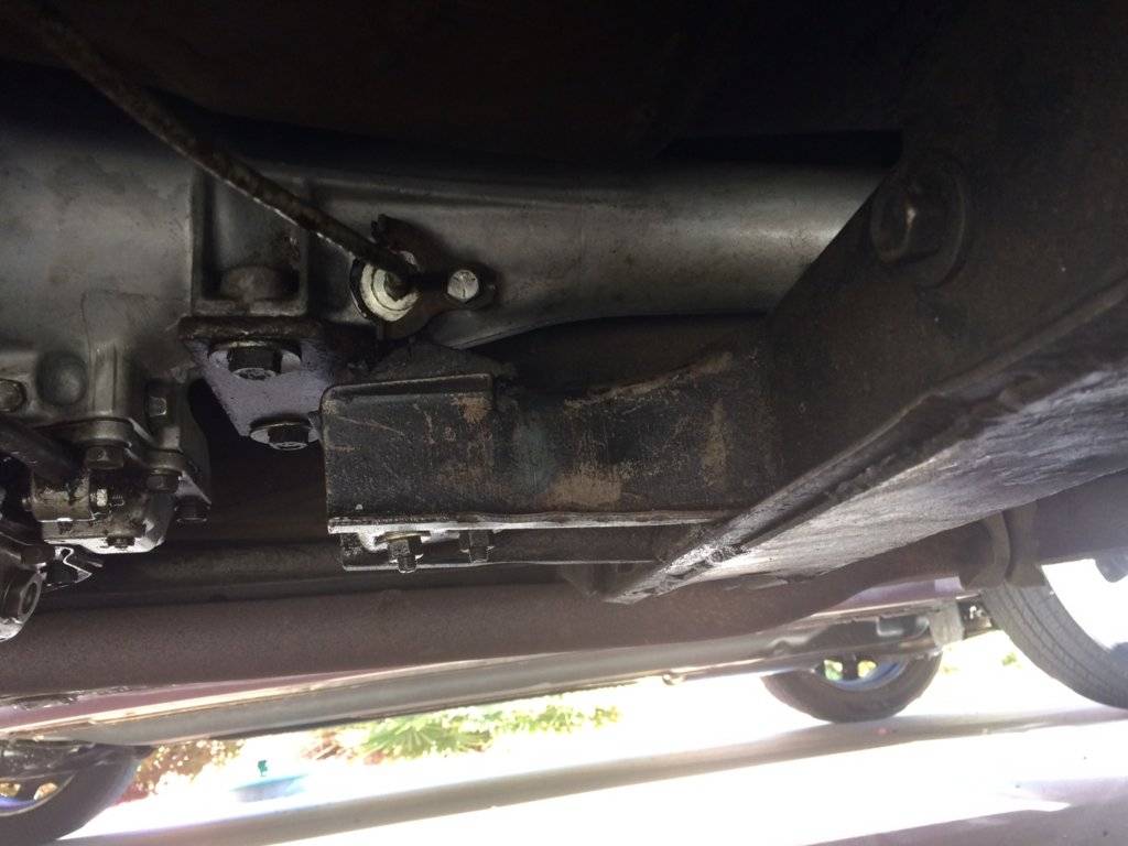

Your car has a single bolt trans mount. Someone upgraded it to a Imperial services two bolt mount. Big waste of time just use the India made single bolt mount from any common auto parts. If your trans mount is failing that badly you have other problems.
Better yet... This is a good vendor. I think the B body is the same mount.
Here are the part numbers I came up with from a quick google search... Just have to see if they all cross over or interchange. 2265826; 2401653; 2460886; 2460888 Some time with the parts catalog is in order.
Mancini Racing Replacement Tranny Mount

Called Imperial Services and spoke with the owner, Steve. They are on order by them, approximately 2 weeks until they have. They build approximately 12 at a time, send them out for zinc coating and they then ship. He offered to build one by Tuesday of next week but would not be coated. I therefore placed an order for one. He commented these are hard to come by and go "like hot cakes". I am a little concerned about their reputation as noted on this forum and other reviews on the but covered by credit card and Paypal so not overly concerned. Steve very friendly and helpful.
Thanks for everyone's comments and suggestions. Unfortunately, I do have the equipment or facilities to do much of was suggested but hopefully I have found the right one and can have it installed. Will let everyone know how it comes out; vibration and all! Thanks again!
