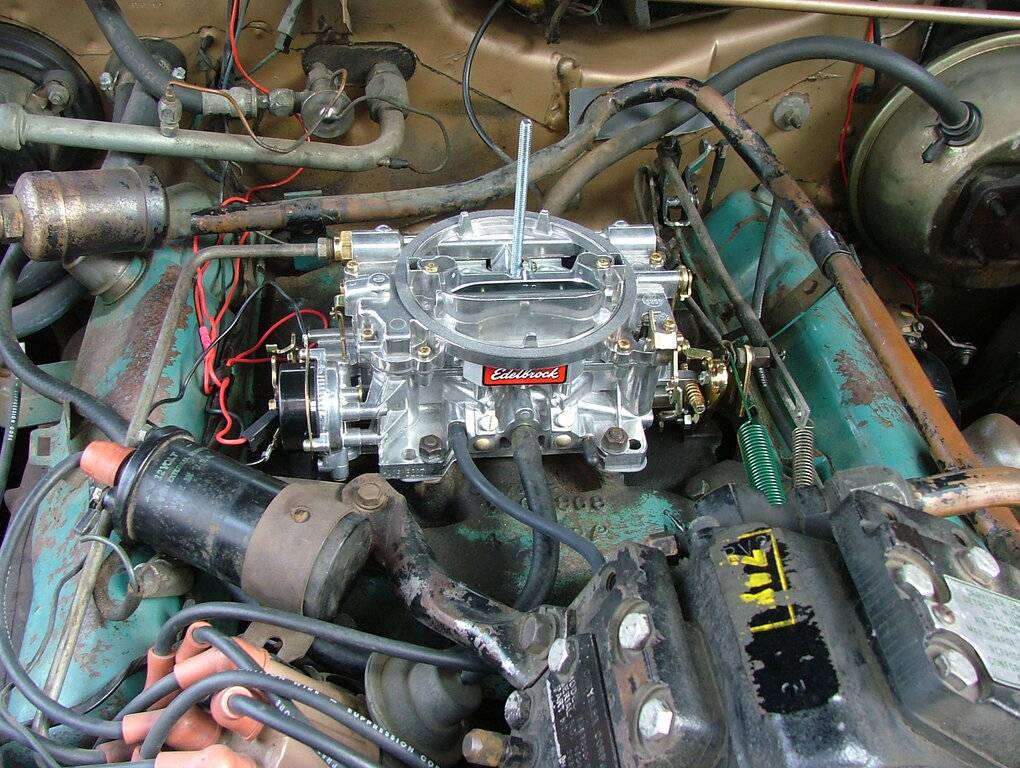

After futzing with the original AFB for a while without success I bought a new Edelbrock 1406 600 cfm plus adaptors for linkage and fuel line. Bolted it on, wired up the electric choke, ran perfectly out of the box and still does almost three years later on nothing but ethanol gas.
10-4 Good Buddy! Since I like mech chokes, reckon I'll go w the 1405, though I'm leaning toward the little 500 cfm AVS2 a bit too. Whatever comes up w the best price tag when I buy.
