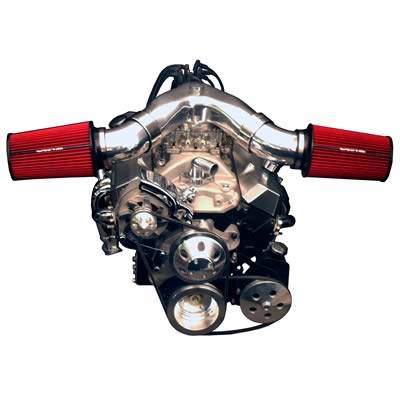

Like this but add hoses?
Ideally you'd find dyno tests done with the hat you're looking at. Some carb hats really kill power, like 20-30hp, more than cold air will gain

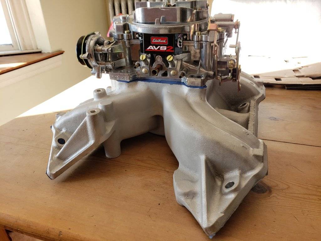

Don't know if I posted this or not. I have decided on a intake and carb for my build. I was very concerned about the height of the Edelbrock Performer RPM intake and using my stock dual snorkel air cleaner. After asking questions here and FBBO and mr Duane Porter who did my cam and heads for this build I have settled on the Holley Street Dominator intake manifold. It is an old design with low height compared to the Eddy Rpm manifold and it is single plane and flows very well. To compensate for the single plane I am going to use the Edelbrock 800 cfm AVS2 to help atomise the fuel better at lower /idle rpms with it's anular primary venturis. Main thing I didn't like about the Holley was/is it's big honkin logo between runners . Looked stupid. Here is a pic.
It is more blatant in person. Got this idea from FBBO and here it is now.
Much better at least to me and the whole engine will be painted Mopar Turquoise or blue or what ever you call it. I can not take credit for this. I showed a buddy and asked about who could do it nicely. He said "Just do it!" I said I would rather not as I would **** it up even slightly and be pissed at myself and have to look at it for the rest of my life lol. He said leave it here,I'm not afraid of ******* it up. Had it the next day.
Whacha you talking bout? Are you going to get rid of that super bright ASV2 label? LOL

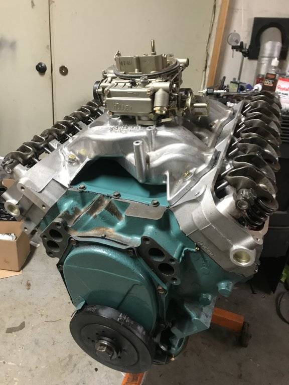

I think we are about the same place with our builds. Just got my Holley back from Dana. My engine is almost done.
