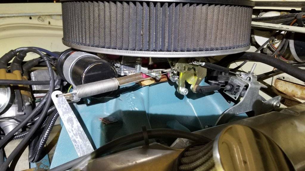

I use this base
Keyser Manufacturing Aluminum Air Cleaner Bases 100 68826
It works with either a k&N filter and lid, or the stock top and stock filter. It is very close to the hood but does not hit. You can see the buchillon kick down bracket and cable conversion in the photo too. The car is just as fast in the 1/4 mile with either air cleaner assembly

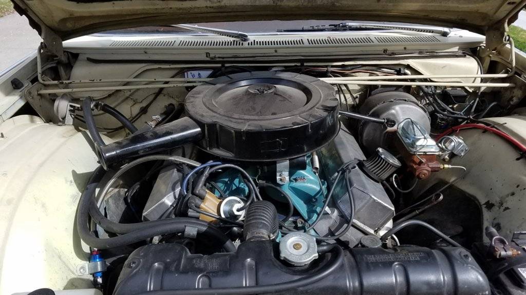

Coming up on decisions for my 440 stroker build. Wanting to know your thoughts on an intake that will fit without cutting a hole in the hood and the decision between the old rivals ,Holley and Edelbrock carburetors. Many I have spoken with seem to agree for my build the Edelbrock Performer RPM dual plane intake would be ideal but worry about fitting as it is a very tall manifold. Another was the Holley Dominator which has a much lower profile and would fit,has good flow but is a single plane. Any thoughts would be great on performance and if it fits. Any other intake ideas would be interesting that will fit under the hood of my 69 Fury III to feed this beast.
Carbs, most engine guys prefer Holleys it seems because they can put out more top end power in general than a Edelbrock I guess. In any case I think the way to go is vacuum secondaries and not mechanical because this will be a 95% street car. Correct me if I am wrong.
For a Holley they recommend a 800 cfm. I am also interested [only because I am familiar with them] the Edelbrock AVS2 800 cfm because of the annular booster primary venturis. I hear the throttle response of these carbs is really great and may help the Holley Dominator single plane intake.
Or just the regular AVS 800 cfm. I have a Edelbrock 1406 on my present 440 and like it and very easy to work on and is why I am considering the AVS2.
This is not a drag car and I want my wife to want to ride in it. It will have a rather decent idle and behavior but have alot of torque if I mash it and speed down the highway with the 3.23 rear. I would like to be able to start it up and go anywhere I want at any time ,,,,like a normal car lol.
Any thoughts would be appreciated.
if the engine is still in the car which I think you stated than do this. take some tinfoil and wrap it into a loose ball shape. put it on top of the original breather and close the hood. measure the thickness of the foil and there you have your measurement. you can now get intake heights and compare them to your existing setup. have fun. and you can reuse the tinfoil.
Yes I did do the aluminum foil ball thing and crush it to see what I have now. It was close that the Performer RPM may fit with a lowering base plate to accomodate my stock dual snorkel stock air cleaner. I mean within a1/3 of an inch. Then Mr Porter said " How old are your motor mounts and do you plan to replace them?" So then all bets were off. Too close for comfort. I chose a Holley Street Dominator single plane intake because it is very low height wise and flows very well. Mr Porter blessed this. Because of it's mild single plane design but flows as well as the Performer rpm at high airflow or better I was worried about around town low rpm manners. I decided on a 800 cfm Edelbrock AVS2 with the anular primary venturis which mimic the spray pattern of a injector with it's I believe 8 orifices in each of it's two veturis instead of one dump tube on each. So that is where I am at at the moment. Got some good deals on the intake and carb during the winter blues sales events happening now.

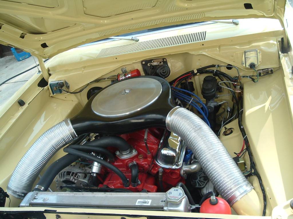

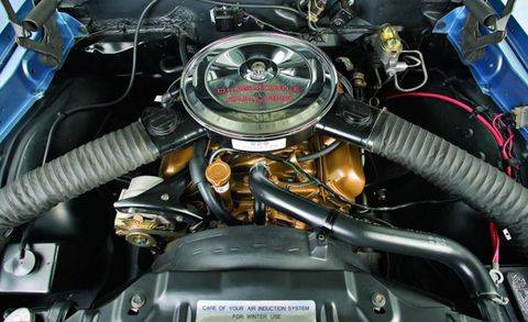

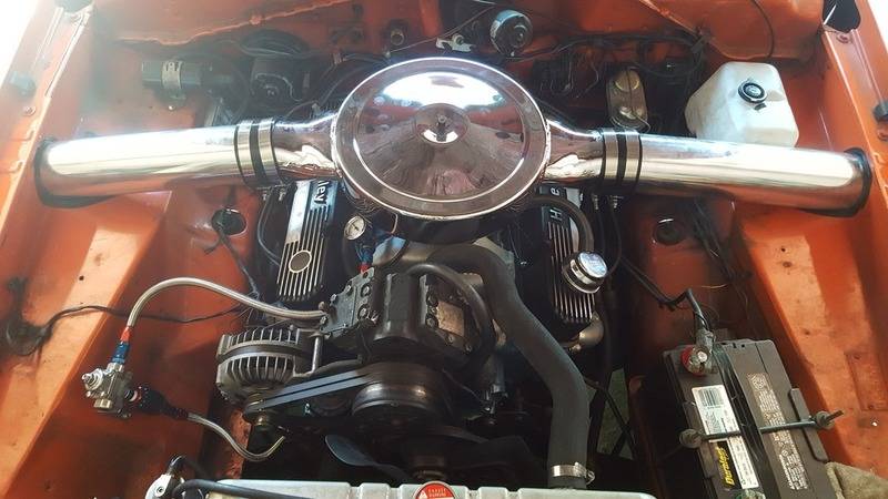

I was just reading through this thread and wondering. Has anyone ever made up a low-profile cold air intake for a c-body? Something that would just have a low "hood" type thing on the carb with ducting to an air box that grabs air from in front of the radiator?
Yes there was a thread on this here somewhere. A similar system to the Oldsmobile W-31 if I remember correctly with the flexable hose with air inlets in the bumper. It has two inlets on the aircleaner. Maybe hard to find [ the thread]as it was discussed to convince a guy not to cut a hole in his hood.
