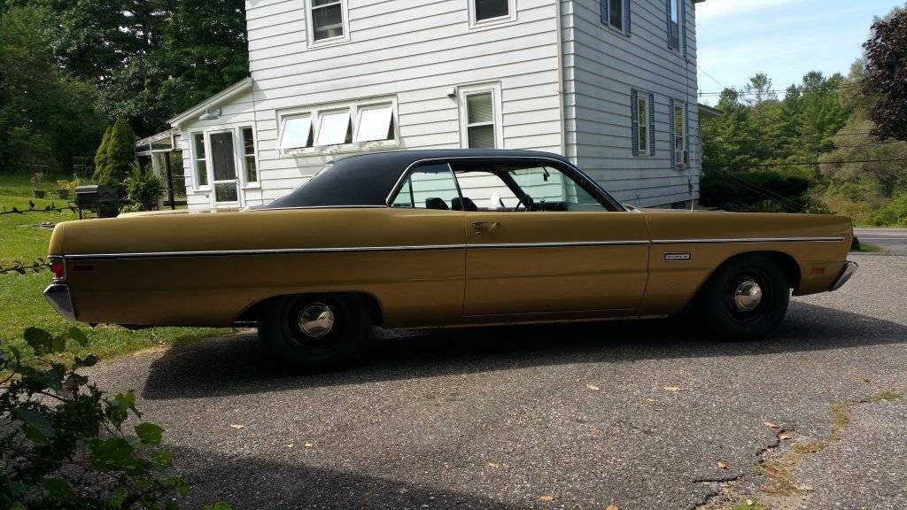

Well I went and got a 69 fury iii today

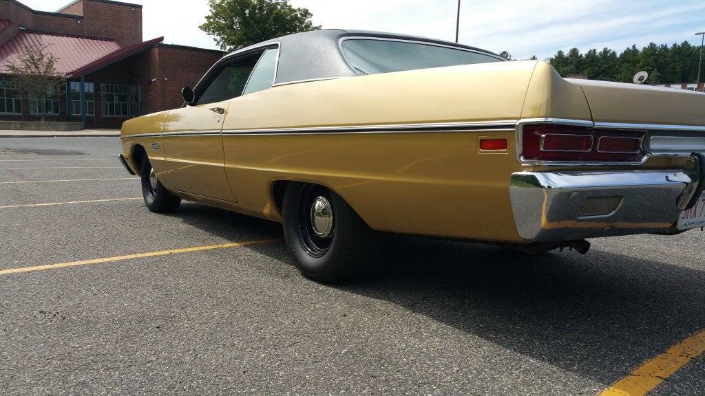

I would love to see a side angle [broadside] of the rear bumper to see how far the exhaust tips stick out for reference. What tips are they or are they just exhaust pipe?
Looking at your car sir you have very good taste!!
Well worth the 400 mile drive. That car looks about mint. It was well taken care of. Congratulations.
Thank you NCFury . I feel very fortunate and will do my very best to keep her that way!

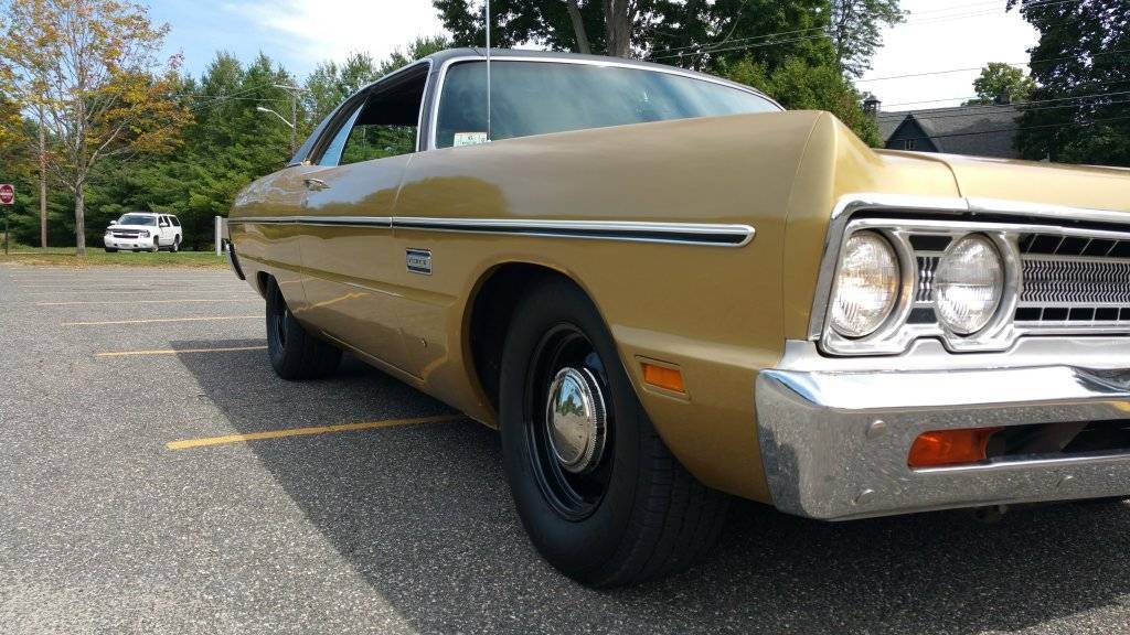

Here is the slightly new stance.
Thanks ! You like the other style of rear glass I take it. She goes in for a all new exhaust system possible this week.
Yes...... The concave vs convex debate has been a debate on c body boards since the beginning of C body boards.
