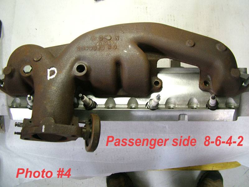

Can someone break down for me what exactly the problem is with using and angle plug head with the HP manifolds??
The plugs angle toward each other 1-3, & 5-7. Where the exhaust pipe flange comes down between 6-8, the plugs are pointing toward the section above the flange. With C body hp drivers side I think it is the same way.
So are they then impossible to get to?

I've been looking at a similar issue myself on a b-body that has older Heddman headers. The only thing I can think of to minimize the clearance problem with angle-plug heads (other than denting a header primary tube) would be to run the "shorty" yellow Accel spark plugs + some "heat socks" + old Direct Connection multi-angle spark plug ends on the close plug wires. I'm not sure how much that would help with stock manifolds.
It's hard to tell on the picture exactly how bad the plug/manifold clearance issue is on #8 (especially not in the car), but if you can protect the plug wire from melting AND get "some type" of wrench in there to change the plugs, it would be OK. All of this is just speculation on my part.
Another idea/question....How thick is the cast iron in that part of the manifold? Could you grind out a little more plug/wire clearance?
Lastly, headers are not "easy" to put on, but most "aren't that bad". At least on b-bodies, you just jack the car WAY up in the air & sometimes have to lean the motor over a little to put them on. Smaller primary tubes & "slip tubes" are your friends in tight situations.
