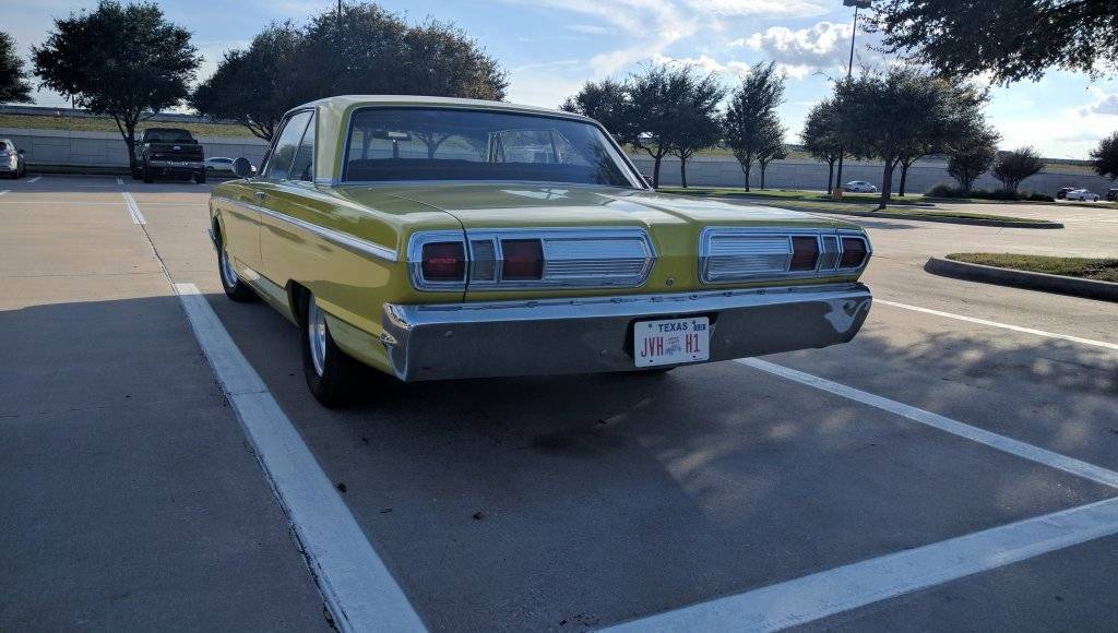

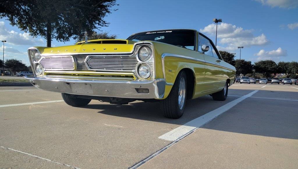

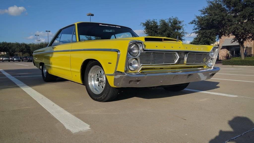

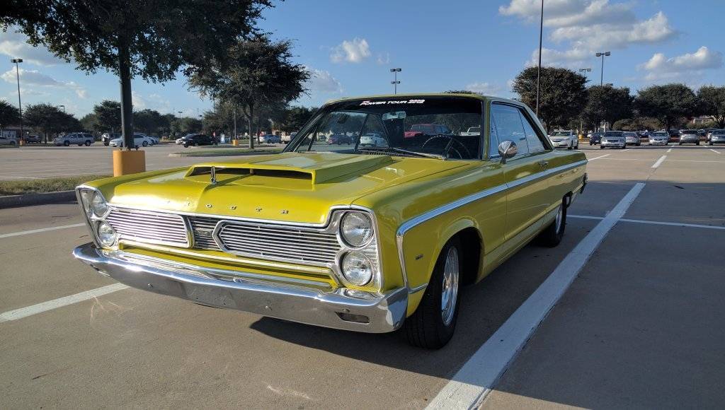

Went to get sushi tonight. This was my first time getting to really drive it. Good god it's fast.
