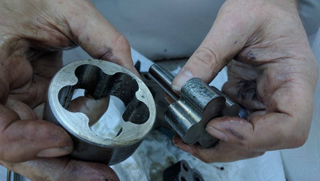

My dad decide to take the car to work today. All the sudden, he lost oil pressure. Luckily this happened right as he pulled into his parking spot. Here's part of why:
Yikes!
I've decided to pull the engine to check everything out and replace cam bearings and main bearings. Any recommendations on a good brand? Since I'm going ahead and pulling the engine, I'm also going to change the heads. I may add a roller cam setup too. I'd especially appreciate advice on picking a roller setup if anybody would like to give it.
Wow why so much debris in oil
I guess that when the engine ate a few lobes off the cam a while ago, it didn't get cleaned well enough. I'm just glad that we caught it in time to prevent any real damage.
