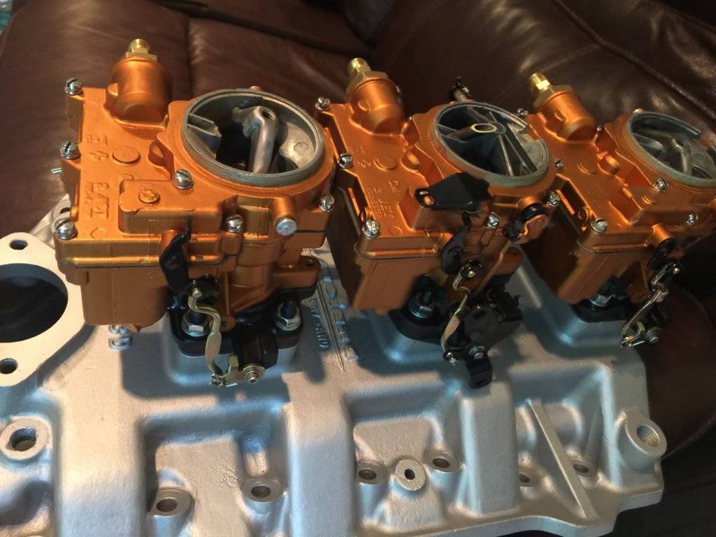

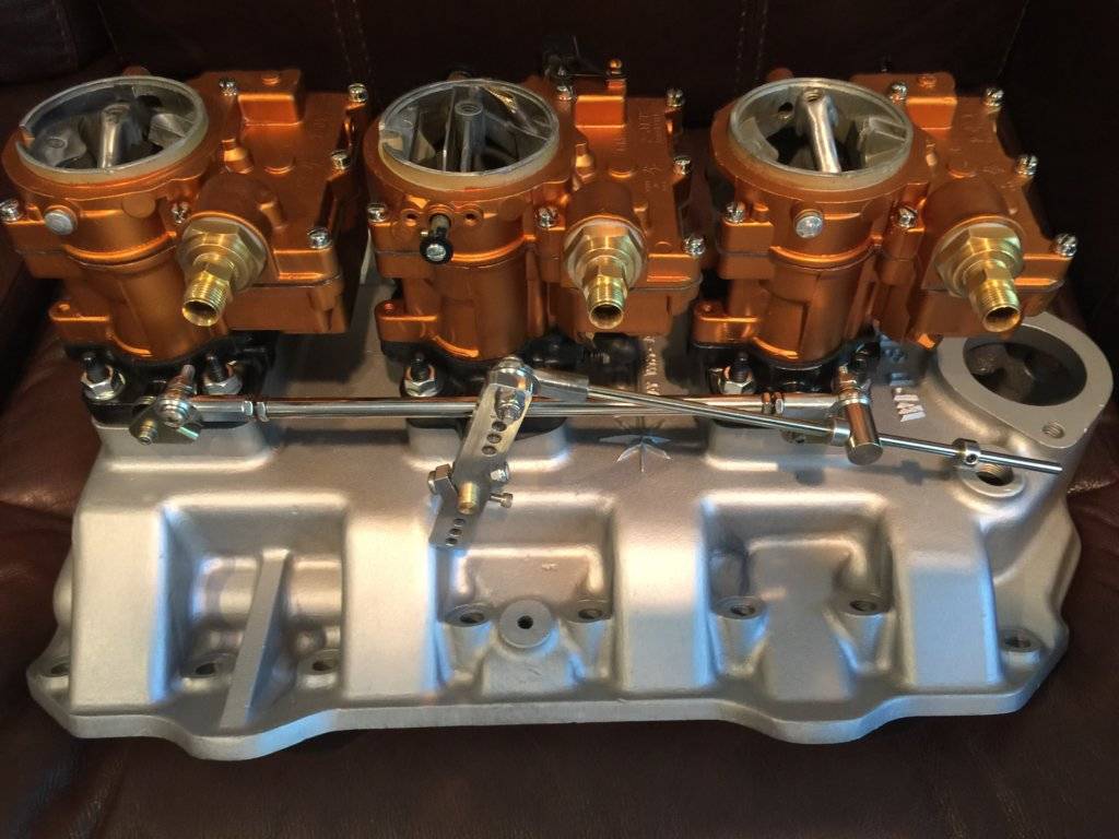

By the way..
..I don't think that I ever showed y'all what I did for my Summer vacation:
- dad
That sure is purdy!
What's it going on?
A polyspherical 318 "A" that will be in a 1948 Dodge Power Wagon.
I called Cope Racing Transmissions and had a rather long chat with John Cope. He's thinking that we're just about as crazy as he is. This should be fun!
Details to follow..
