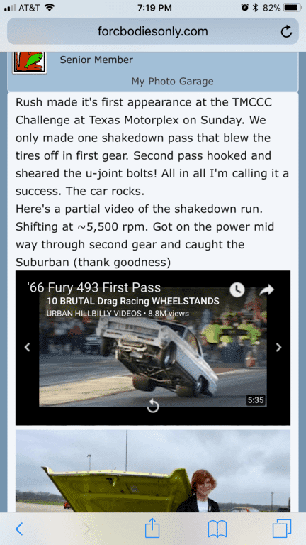

Rush made it's first appearance at the TMCCC Challenge at Texas Motorplex on Sunday. We only made one shakedown pass that blew the tires off in first gear. Second pass hooked and sheared the u-joint bolts! All in all I'm calling it a success. The car rocks.
Here's a partial video of the shakedown run. Shifting at ~5,500 rpm. Got on the power mid way through second gear and caught the Suburban (thank goodness)
Will post time slip and more videos later!
Geez, must have blown the tires off to give the burb that much room, even with the head start he got. Sounded good getting into those upper RPM's!
