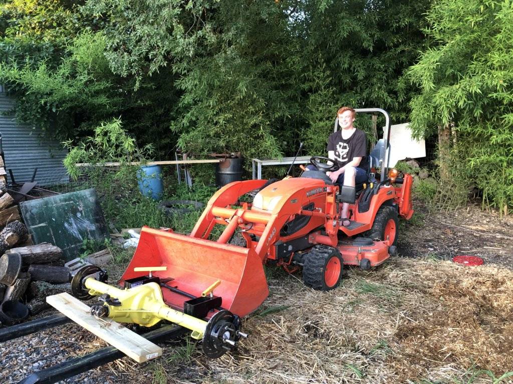

Funny you should ask. We’re back to chipping away at this stone.
I’m moved, but not unpacked. It’s been a long, long haul. The shop is full of boxes. So, we work outside for now.
- dad

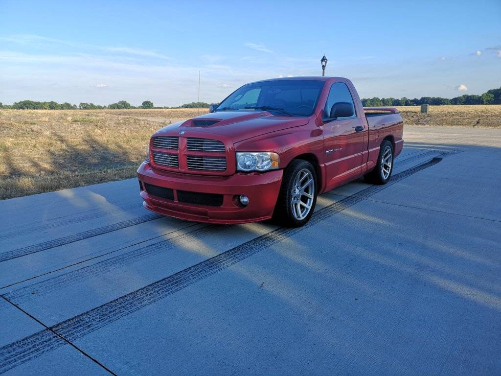

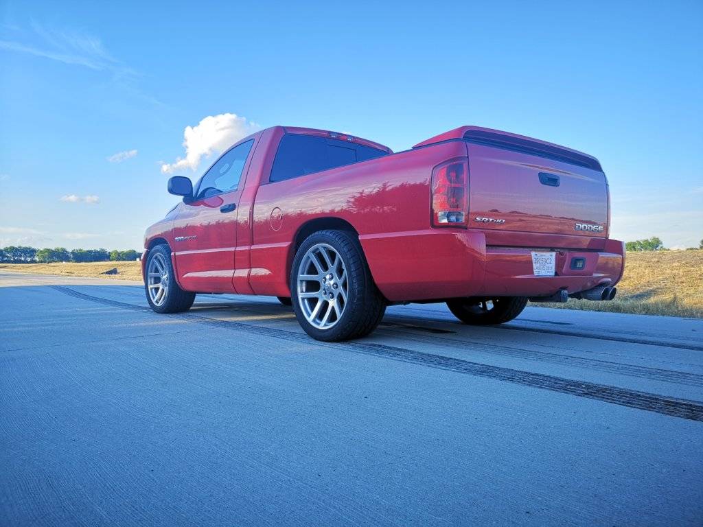

Also picked up a new ride. 10 points to anybody that can tell me what it is and what's special about it!
-Dylan

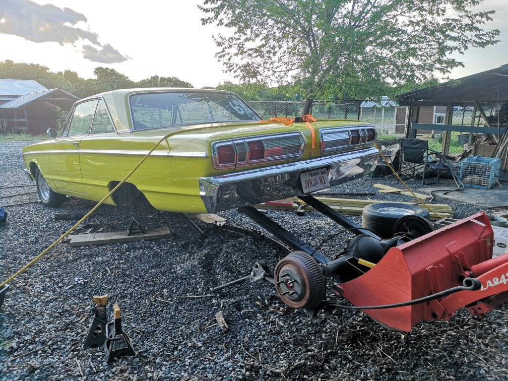

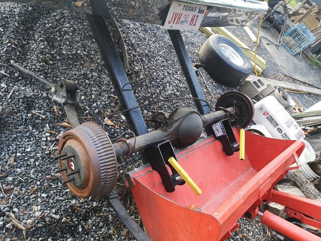

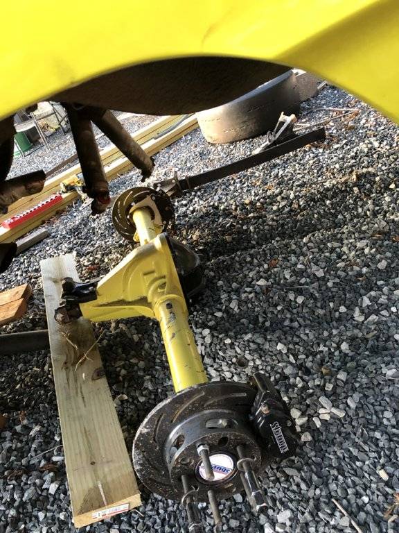

Looks great guys! Rear end problems are now a thing of the past.
Are you reusing the existing springs?

Those SRT10 trucks are a riot to drive. Put a couple hundred hard miles on a stick shift version.
Might want to hold on to that truck for sure.

Yes we are re-using the existing springs. I plan to keep the truck for as long as I can!

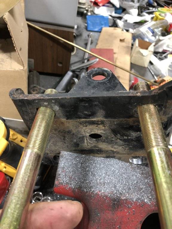

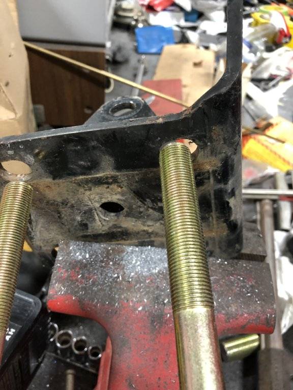

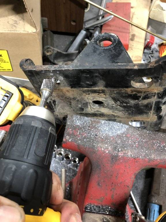

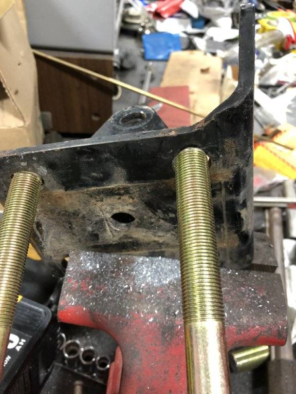

Never, ever re-use a modern u-bolt. They’re made with rolled threads. The threads are deliberately made to interfere upon tightening. They’re a one use item.
I’m going to a 9/16” grade five u-bolt.
The Caltracs tie plate is in great shape, but, it’s made for 1/2” bolts. Nothing that a little love can’t cure.
- dad
Pardon the mess. Moving was slam-bang. I’m prioritizing things and Rush needs to be capable of rolling before the shop is clean.
