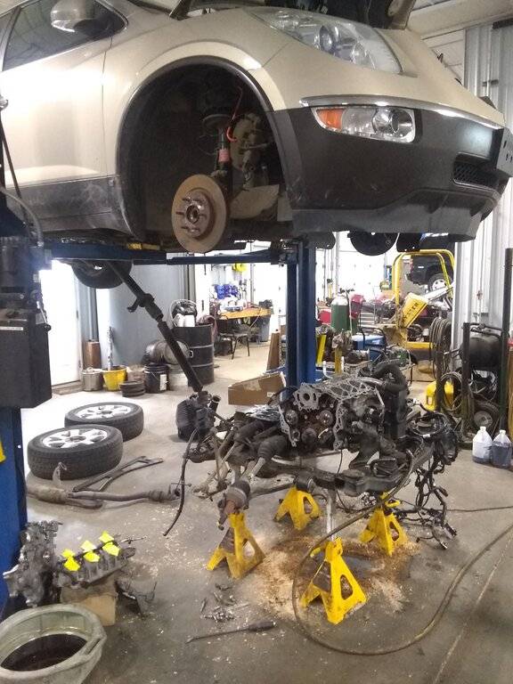

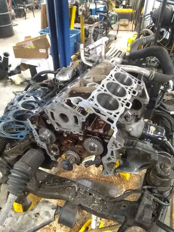

I have this Enclave apart right now

they did one of those where i work. they used aftermarket timing components. came back with stretched chains six months later.
I have used GM parts, Cloyes and Melling kits on quite a few. Never had a issue with the GM parts, had a chain break on a Cloyes set after 5000 miles. Only used 2 Melling kits so the jury is still out on those.

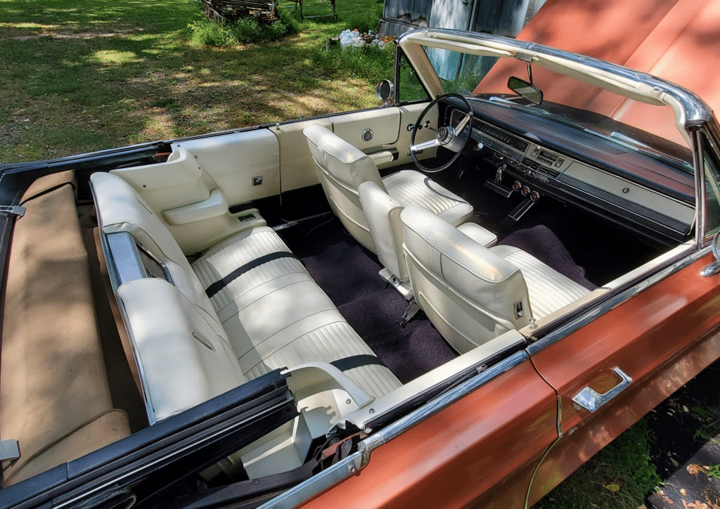

Wasn't feeling well on Sunday so didn't work on the car (no, not the Chirona virus...just a lousy cold) but was able to put some time in last night and got the rear together. I'm very pleased with how the rear armrests and panels, which I refinished, look compared to the new seat covers. I used a 3 layer combo: SEM Sailcloth White - Herb's pearl white - semi-gloss clear. I wouldn't call the results 100% perfect but close enough that I don't think a casual observer would notice. If you want to see a before and after, just look at the rear quarter panel compared to the front door panel which has not yet been refinished.

Terrific job you have done here! If I ever get my rear power windows to work, I'll be doing the same thing with the Pearl White interior of my '66 300 convertible. I've got all the seats done (from Legendary) and just need to finish up with the quarter and door panels.
Your interior has inspired me. . . Mighty fine!
