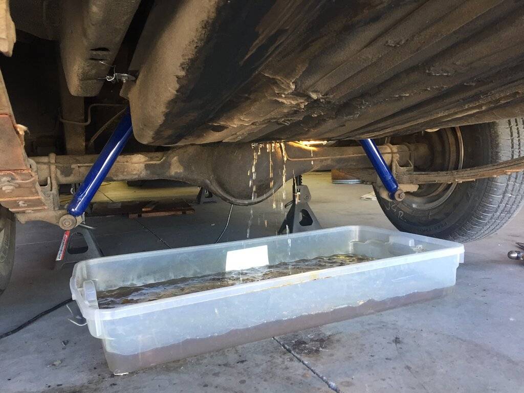

replacing rotten axle housings, radius arms, brackets and bushings '94 f150 4wd.
one of the scarier jobs i've had to do. both sides back together now and i'm still here!

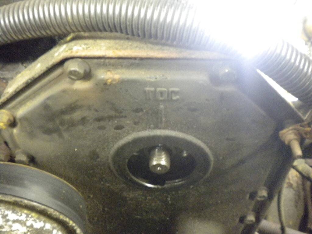

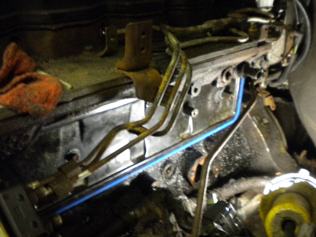

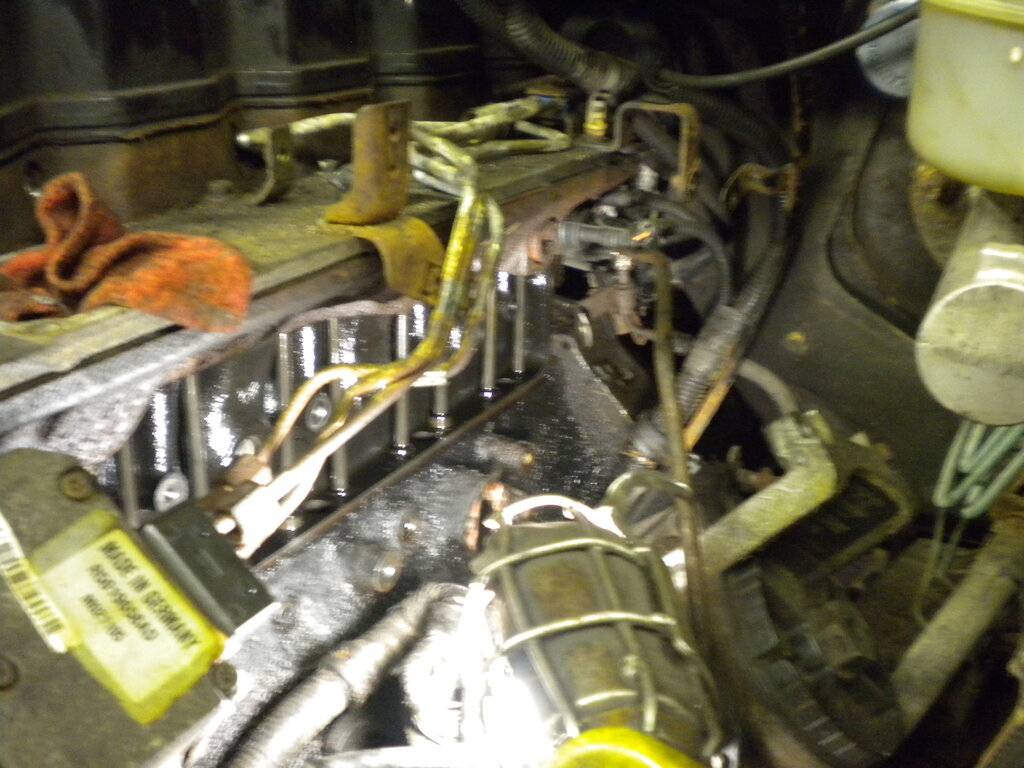

Ouch, I can't say that I've ever had the sprocket on a VP44 hang up like that. Did you ever get it to release?side cover on an '01 cummins. had every intention of pulling the injector pump, but the sprocket wont pop. loaded it for all it was worth with a snap-on gear puller, nothing. snuck the cover out backwards between the body and the bell housing. View attachment 403955 View attachment 403957
View attachment 403956f'ing ***** of a thing.
no. was to the point where i was afraid to snap the puller attaching bolts rated at 10.9. tried knocking the puller with hammer, NG. something bad was going to happen and i wasn't going to risk it. pulled the bolts out of the left side engine mount to gain some additional clearance between the cab and the bell to allow installation.Did you ever get it to release?
agree, but from reading online it's not unheard of. 250k+, don't know that it's been apart. adult owned. torque spec. on the nut is 125 ft/lbs. didn't feel like it took 125 to pop it loose. think the gear seated itself an extra hundred thousandth or so over the years. ran it last night. hits on six. final assembly today.Dang that’s crazy, what’s the history on the truck?

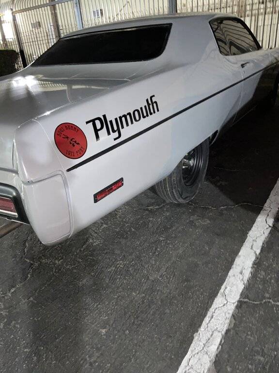

I hope you reused that old lock ring.View attachment 405570 View attachment 405571 Replaced the fuel sending unit on my ‘68 300 today, and now have a functioning fuel gauge
I did after the new one started leaking lolI hope you reused that old lock ring.

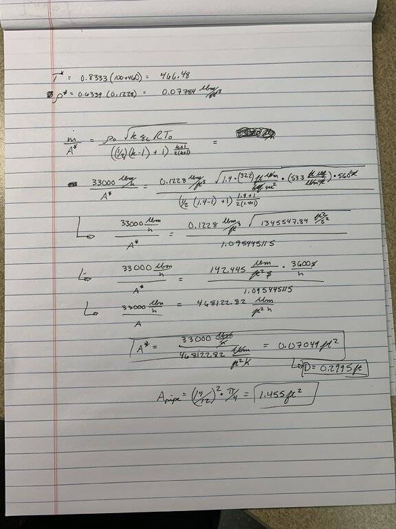

A job for mathcad.I wish I was doing working on something, instead I’m doing math I'm sizing a new system for work, and I didn't like the numbers the model spit out. Gotta check them by hand.
