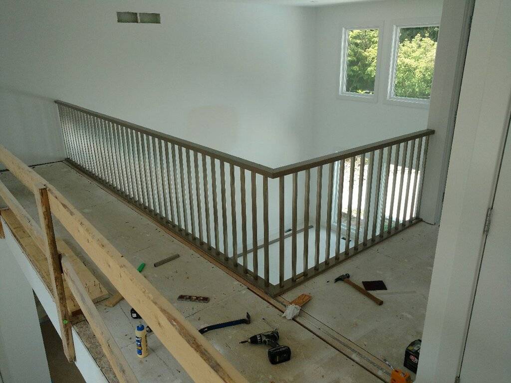

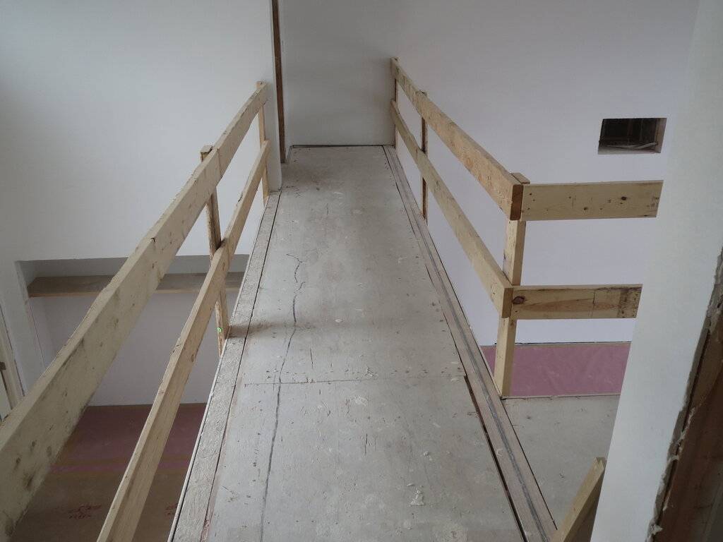

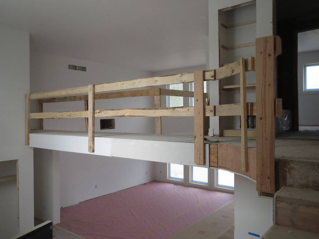

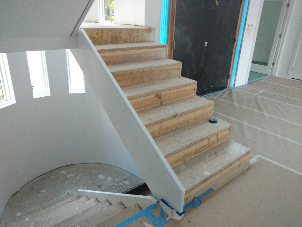

Big stair and railing job for the last month and a half. Here’s the before.
View attachment 394979 View attachment 394980 View attachment 394981

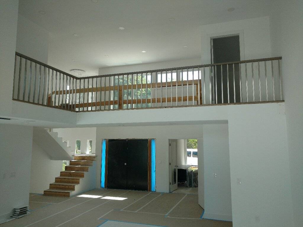

Started with the horizontals upstairs. All the wood is white oak and I milled it from rough lumber and did not buy one pre-made stair part with the exception of a few fasteners. It’s completely custom, prefabbed in my shop as much as the project allows including stain and clear coat and then the parts are assembled the final time on site.

Pickets are 1” square stainless steel with a brushed finish which came to me in 20’ lengths.

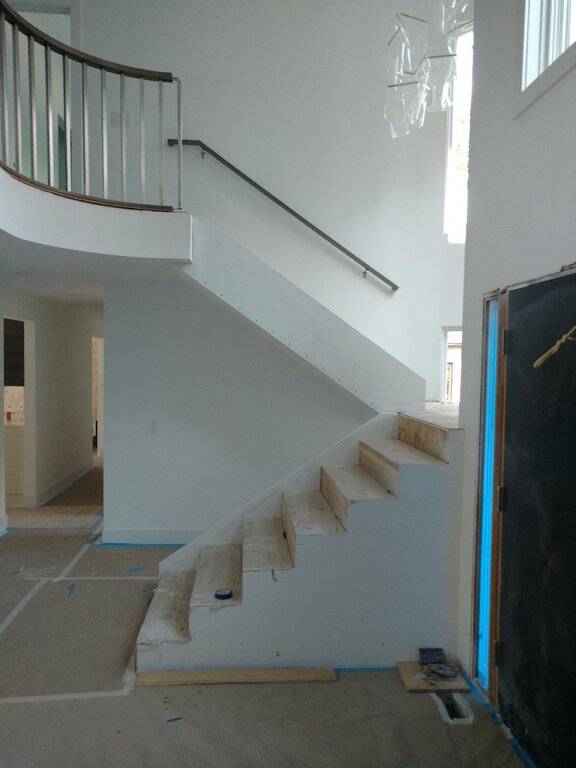

If you notice the before pics the stringers were open? Well that just won’t do.
The wall mount railing is also custom.
View attachment 394989 View attachment 394990
